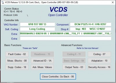

Well if you can tell us what bcm you have, that would be helpful
Re: MFSW steer swap
Posted: Fri Apr 24, 2020 9:10 pm
by cypress
iichel wrote: Fri Apr 24, 2020 8:35 pm Well if you can tell us what bcm you have, that would be helpful
Do you prefer an actual picture of it.
Of is an screenshot of VCDS enough?
But it the first thing im going to do after work xD
Re: MFSW steer swap
Posted: Sat Apr 25, 2020 7:17 am
by iichel
Vcds autoscan is goed
Re: MFSW steer swap
Posted: Sat Apr 25, 2020 2:08 pm
by cypress
iichel wrote: Sat Apr 25, 2020 7:17 am Vcds autoscan is goed
BCM polo 6r 1.2tsi 2010
Here by an picture of the BCM :)
I hope its enough/usefull :)
Just in case
Vag number: 6R0 937 087 D
Component: BCM PQ25 H+4 H46 0207
Edit,
If i use the"long coding helper" im able to enable MFSW.
I dont know if the right one for an Golf 6 GTI steering wheel :P
