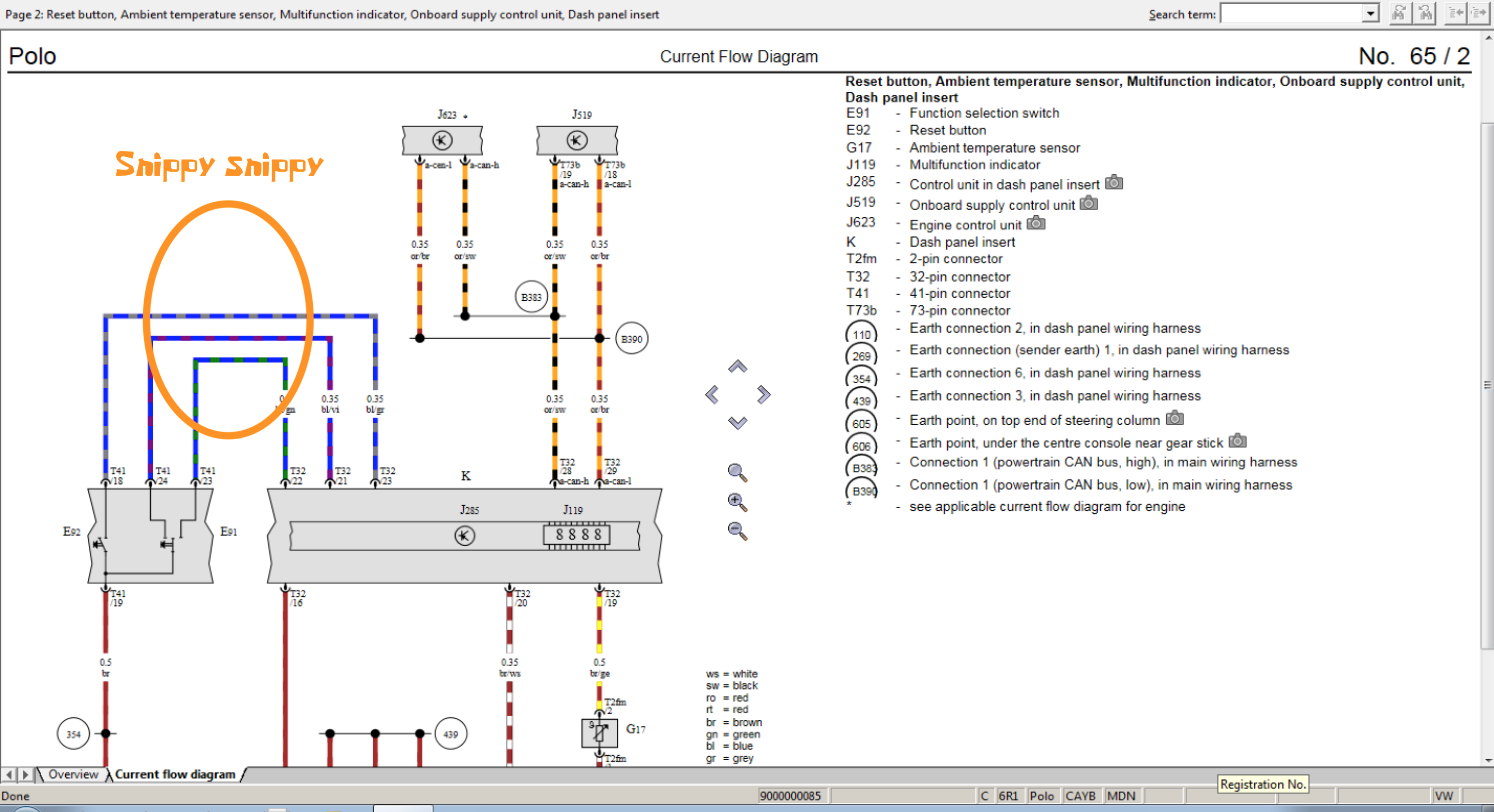

Let's have a look at the scheme:
For the wiring, you need to add three wires, circled and commented 'snippy snippy'. Ignore the comment. So we can see:
T41/18 to T32/23
T41 is the 41-pin steering column combination switch connector, the big grey one you removed when changing the stalks.
T32 is the 32-pin blue connector that goes into the instrument cluster. So pin 18 of the big grey one goes to pin 23 of the blue one.
Apply the same logic to these two as well and you successfully wired your MFA+
T41/23 T32/22
T41/24 to T32/21
All three wires have a cross-section of 0.35mm2 (or larger) and the contacts are all MQS (micro quadlock system).

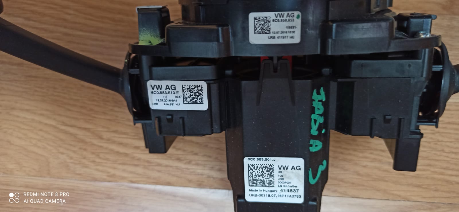

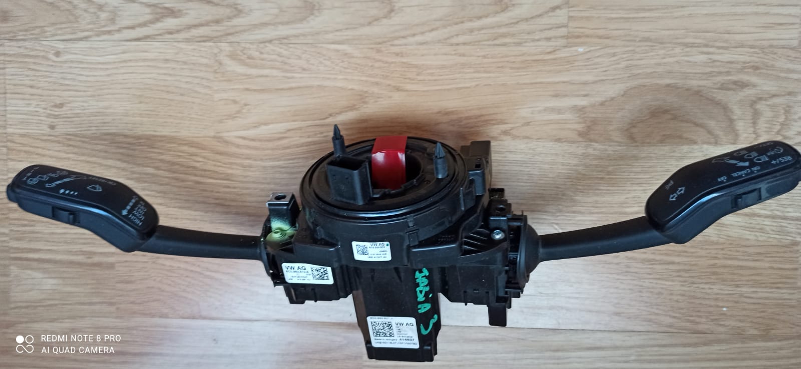

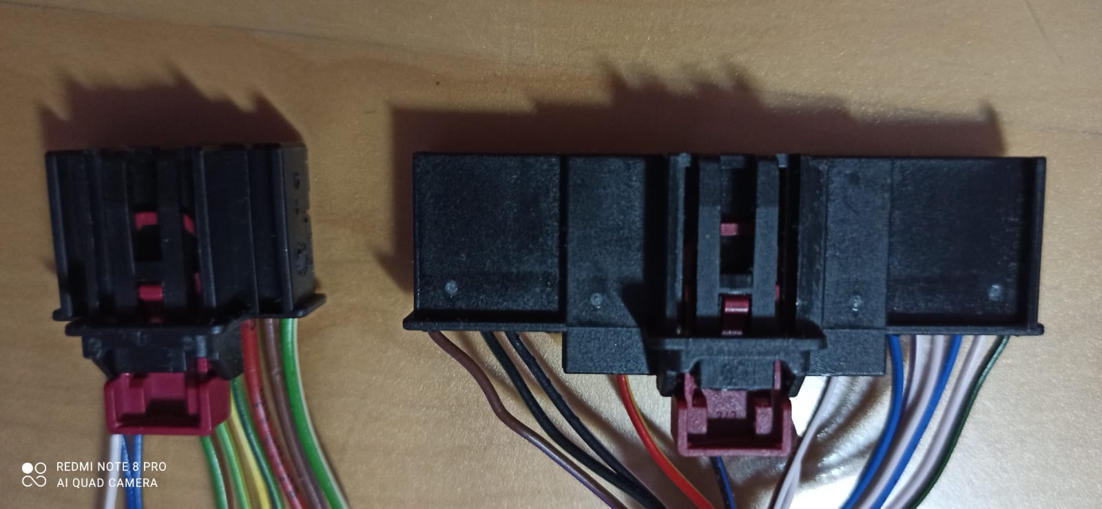

hi. First of all, please forgive me for " my English" and lack of knowledge in this area.i have an trend polo 6C 1.0 cc 44 kw ,with no trip computer and no tempomat.
I bought both levers (photo) ,which have these two plugs (photo). please help me to solv first trip computer and then tempomat (if i can...).
I mention that I also bought a BCM series 6C0937089C, and the old one has series 6C0937085A to suit the cruise control.
Thank you and I hope I did not do something wrong !!!

so you need to run wires from the stalk to the BCM, T73a/15 /16 and /17
for cruise it's this scheme:
remember, for the cruise control you need an activation document and online ODIS to activate/code CCS
lucian
