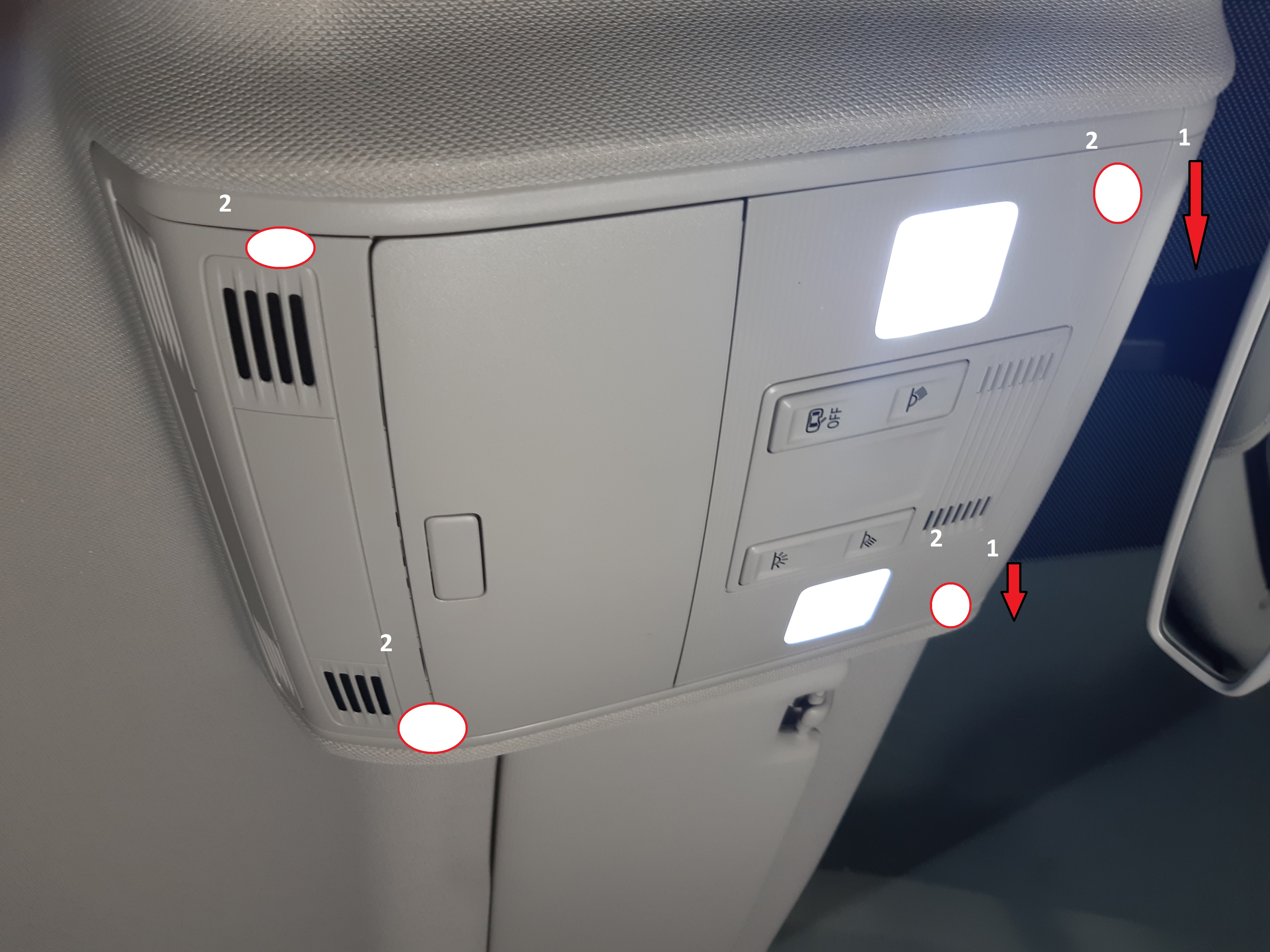

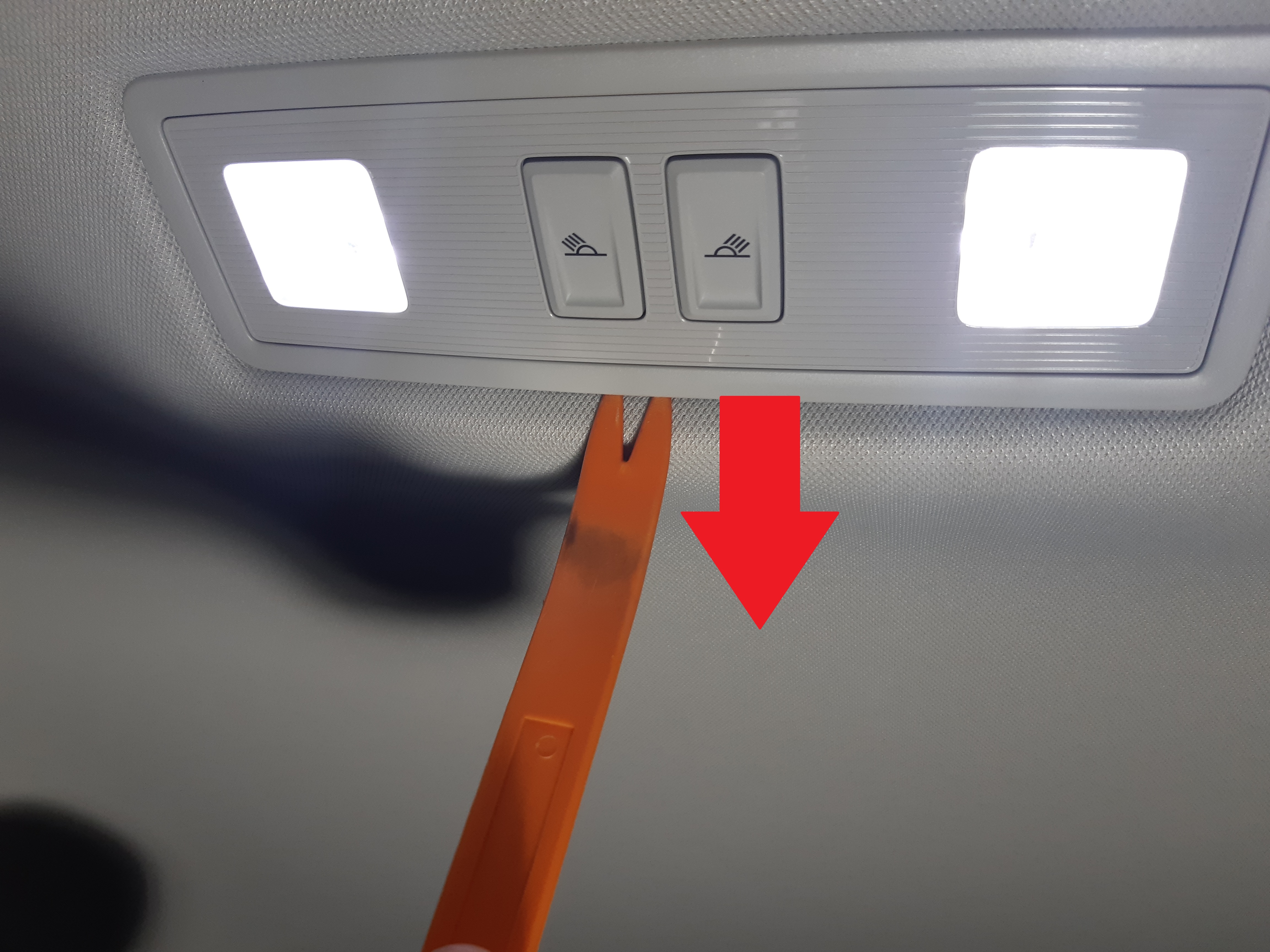

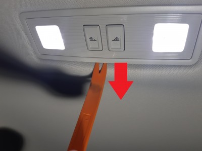

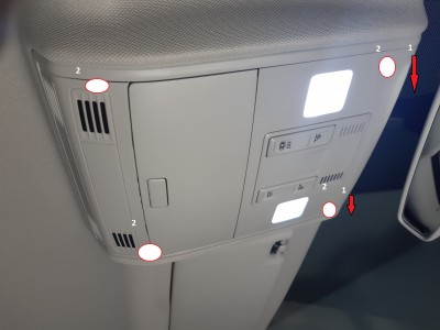

I replace mine for some time I hope I'm not mistaken if someone thinks it's wrong I ask you to correct me.

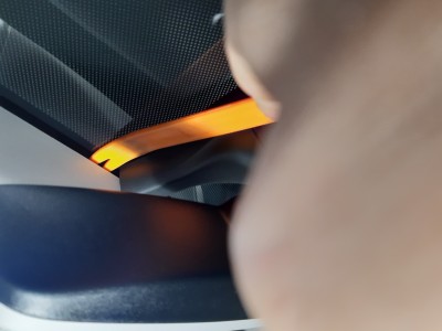

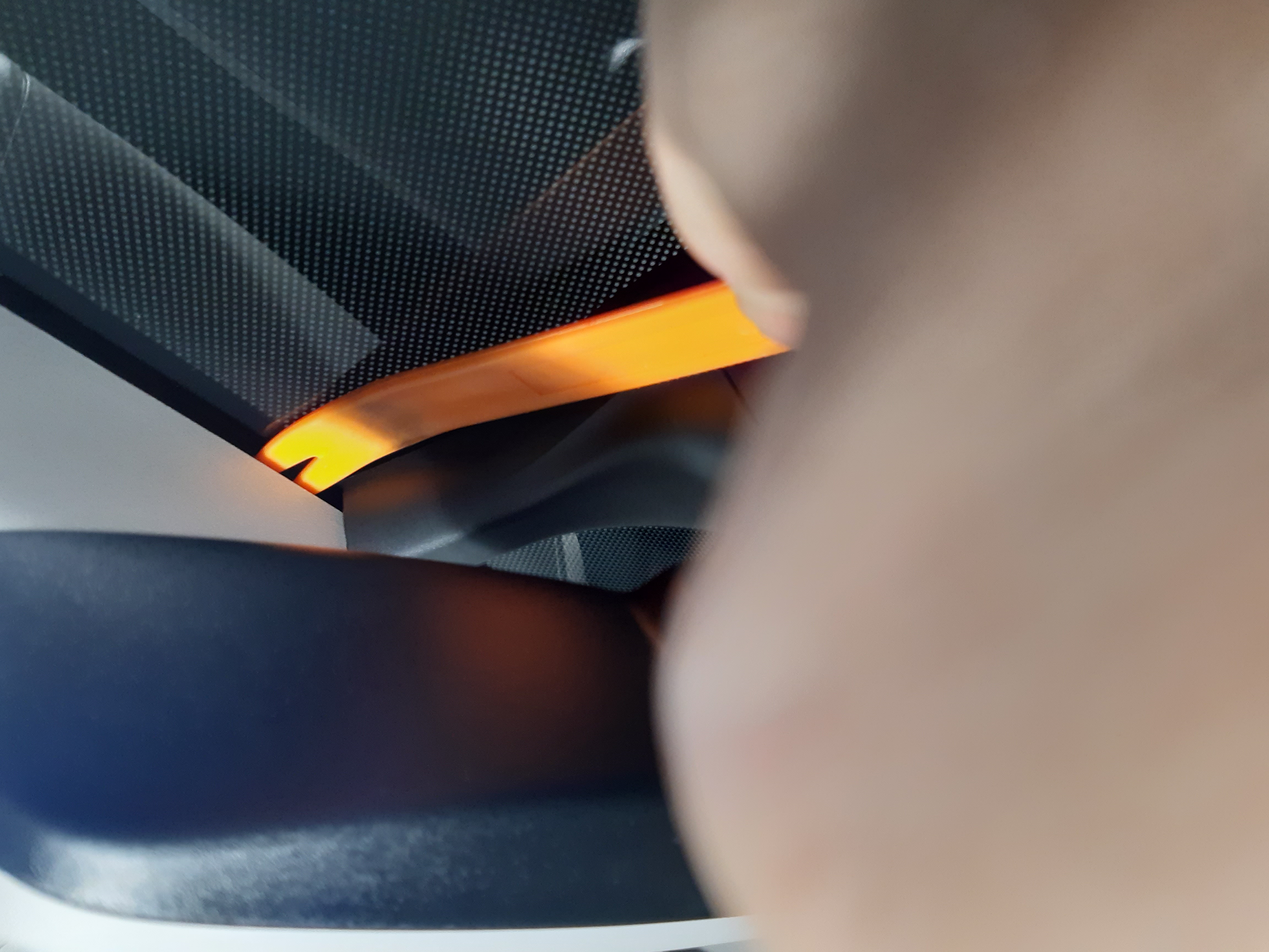

In rear places its just pull one side down.In front you have to pull the piece that covers part of the cables that come from the mirror. Than its attached bye 4 pieces of metal you pull it down.
