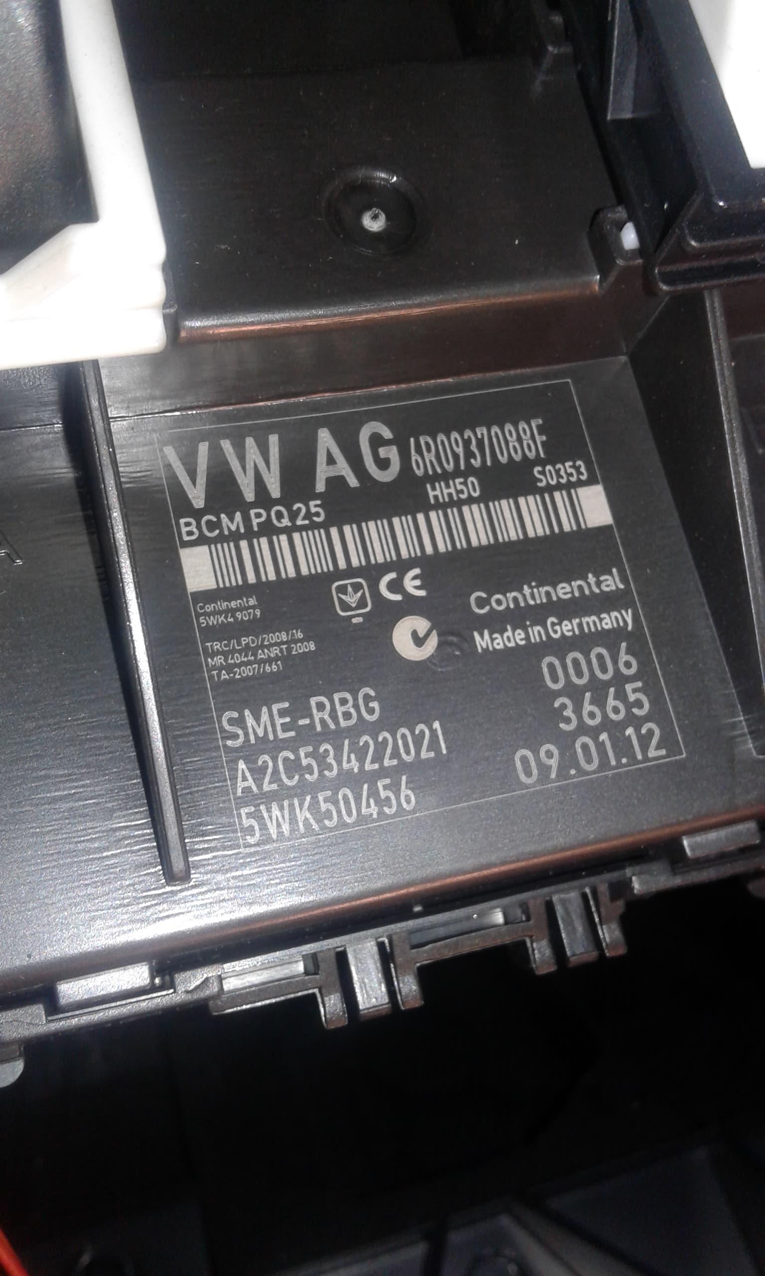

First I need you to tell me the bcm part number and its coding. You can find these with vcds

Re: lamps H4>H7/H7 Problem!
6R0937088F HH50 S0353
- Posts: 6407
byte 22 of your bcm must be coded to 00
