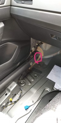

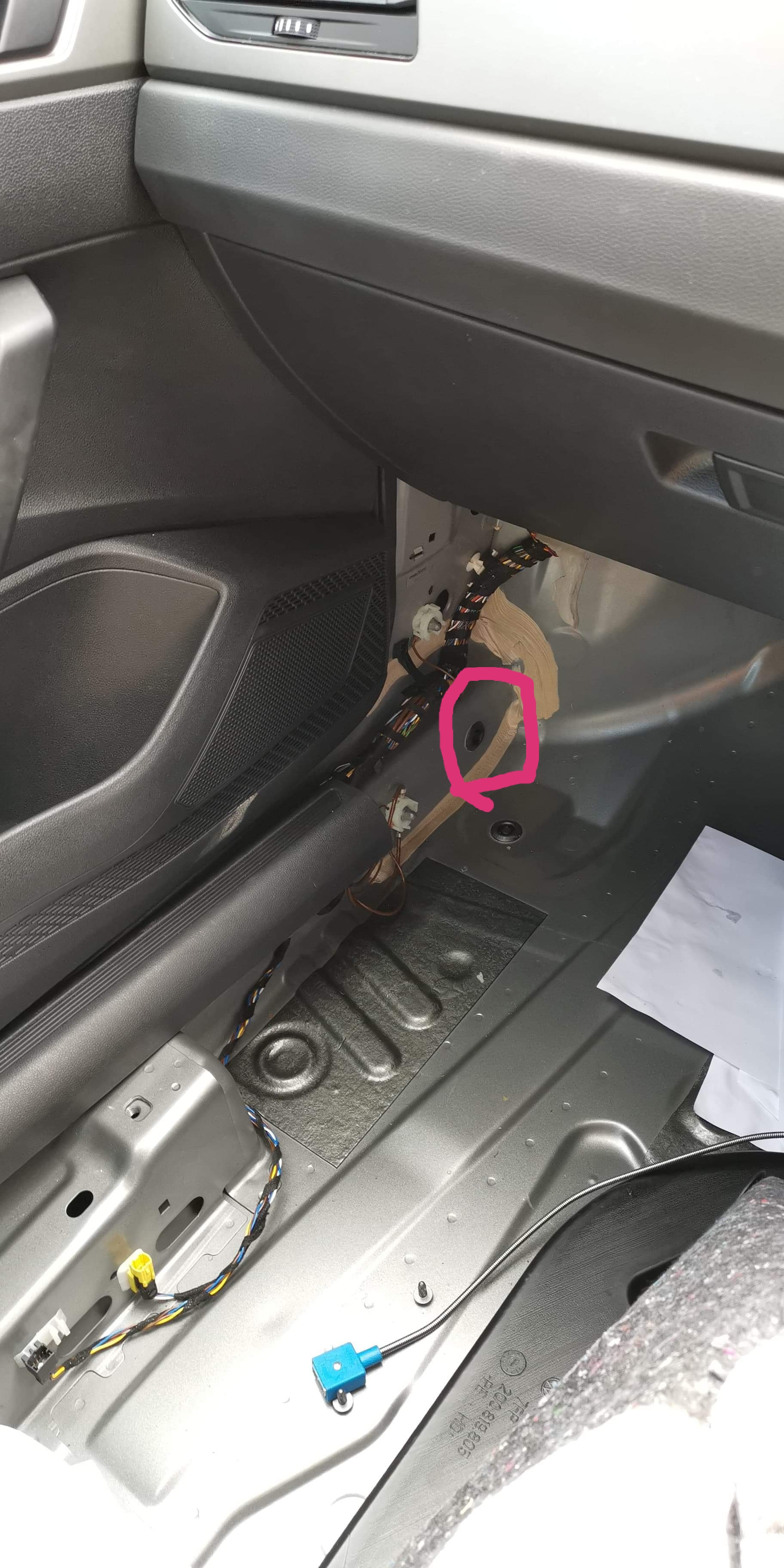

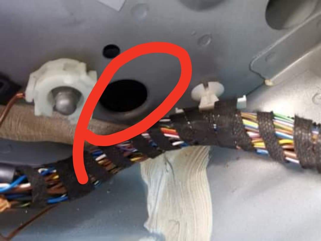

Unfortunately i dont have warranty anymore and i have a leak in a front pasaanger footwell. I think it May be windscreen. I am Sending you a video
Is that water suppose to come like that, or it is something wrong
I add some photos as well where the water stucking

That's very strange indeed. Does your car have a sunroof? The piping for the drainage port runs through the front door. Just pour some water in the sunroof and check if that's the issue. How is your vehicle out of warranty though?

No water leak would be normal. Water from washing the car or from rainwater on the front of the car around the windscreen shouldn’t be draining into the footwell of the car. Forum member mike sel had a similar problem with his Polo - a water leak from somewhere around the bottom left corner of the windscreen running into the front passenger side footwell, and this was fixed under warranty. It’s covered in this discussion thread - it’s a long thread so you may want to use the forum search facility rather than read through all 34 pages of the thread;

A friend had this problem with his polo. It was something to do with the air conditioning hose had broke had leaked. He got it fixed under warranty
