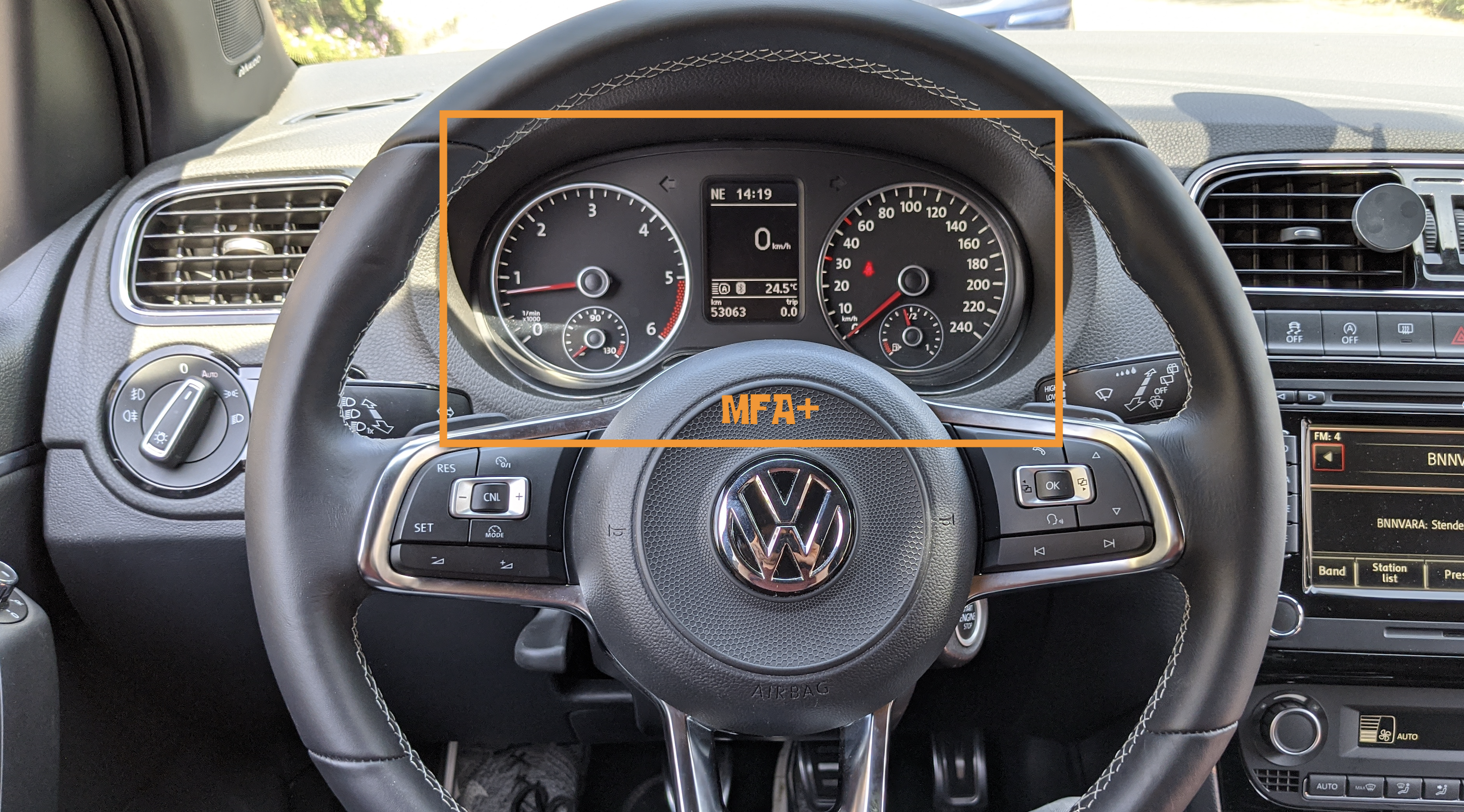

MFA+ is the large pixel display opposed to the segmented display of MFA

iichel wrote: Tue May 26, 2020 1:46 pm MFA+ is the large pixel display opposed to the segmented display of MFA
Ah ok. So my display is just a MFA?
Can i use the buttons on the right stalks then? for changing /scrolling trough options on screen?

Your instrument cluster screen, even if it is full screen is MFD without plus, that is, an on-board computer that is not capable of displaying Menus of additional functions (navigation, telephone, radio, etc.)
The pin dedicated to the CCS in the ECU (CGPB) of your 6R ('C' Model Year) is T121/69.

Jorrick wrote: Tue May 26, 2020 1:56 pm
Yes you can. You need to install some wiring from the stalks T41 to instrument cluster and activate it with vcds.

iichel wrote: Tue May 26, 2020 1:59 pm
Ow wauw, that is great. I was a little sad because I thought my MFA was a little bit useless but this just made my day!
Now I just have to find out which wires go where and make for myself an understandable paint diagram hahaha.
