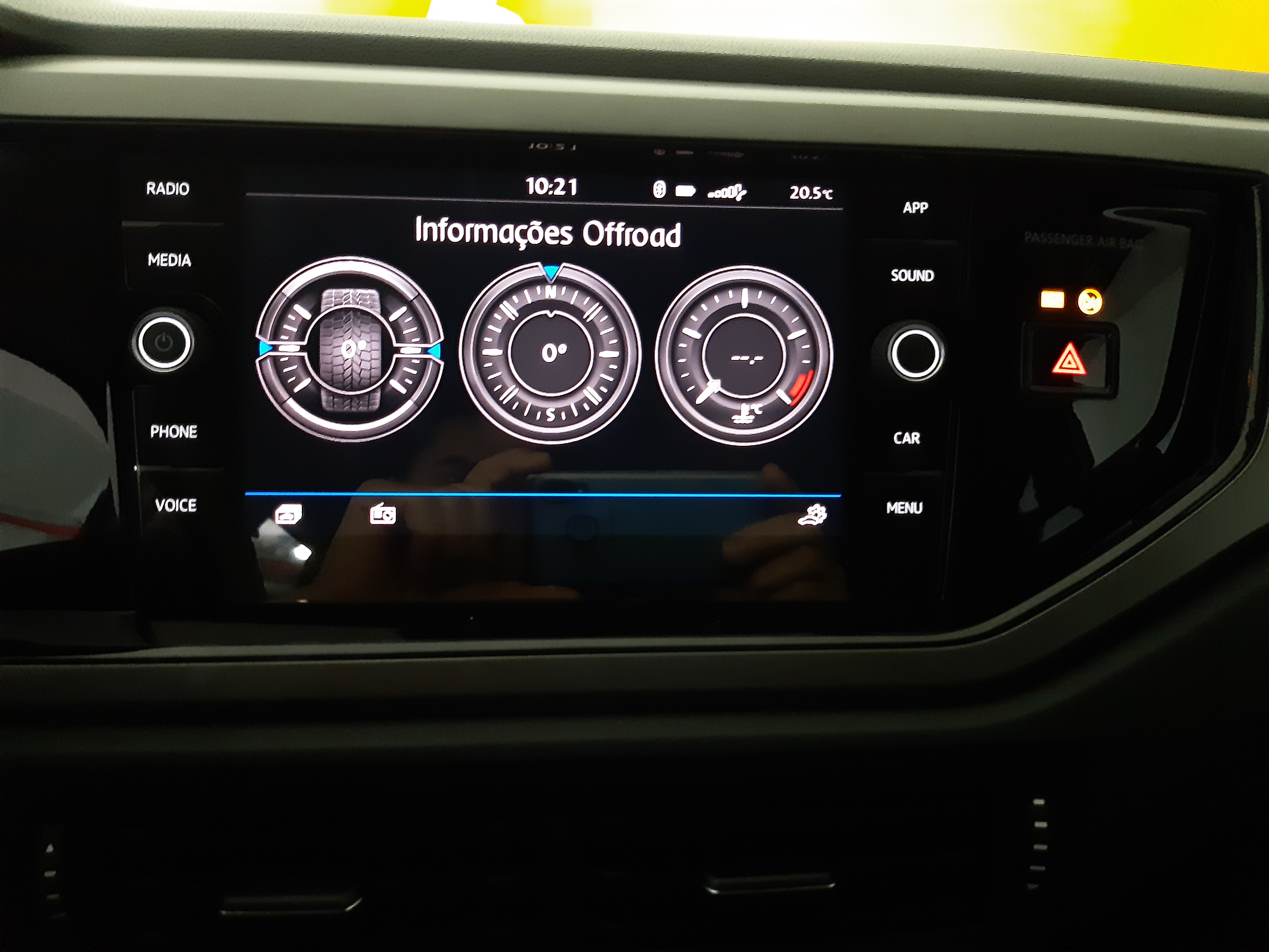

Today I tried to activate the off road option using the obdeleven app it says that its possible but it did not activated that function. Did it already happened to any of you?

Watch this video and see if it helps...J+silva wrote: Sun May 24, 2020 7:46 pm I have been searching information and it looks like you need to have a navigation system.
https://www.youtube.com/watch?v=CBHeXPHz8XI
For the video I think you have to trick the car into saying that it's equipped with navigation despite not having.
-Select Unit: module 5F (Information Electrical)
-Long Coding
-Byte 24
-bit 2 Navigation Function activated/installed -> Activated (Default -> Not activated)
-Save all changes press and hold volume knob for 10 seconds to reboot.
I activated the OffRoad Information Screen but my Polo GTI has navigation.
-Security Access 20103
-Adaptions
-Select Car_Function_Adaptations_Gen2
-change menu_display_compass to -> Activated (Default -> Not activated)
-change menu_display_compass_over_threshold_high to -> Activated (Default -> Not activated)
-Select Car_Function_List_BAP_Gen2
-change compass_0x15 to -> Activated (Default -> Not activated)
I hope I helped and says anything if it worked.

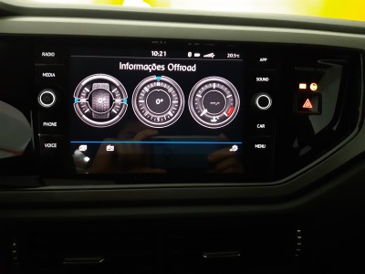

Hi proalves thanks for the information it was exactly what was needed to work.

I wanted to activate this for funsies too but despite following all the instructions online I couldn't get it to work.
The instructions here had one bit of information that wasn't in the other guides and that was the bit in long coding to tell the system that navigation is installed.
Once I did this the option showed up.
However, because my car doesn't have navigation I presume the compass and elevation aspects of this screen will not work?

Yes you are right they don't work.
