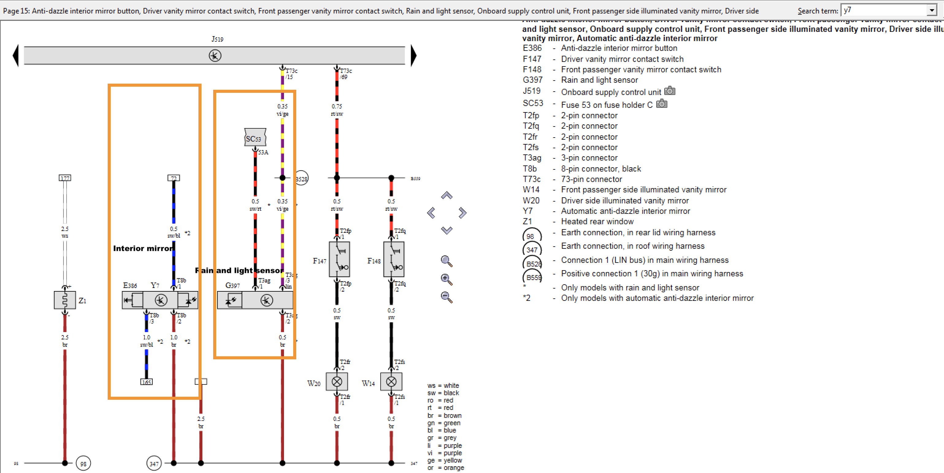

Hope ichel can help with this one looking for all drawings for this to suit my 64 plate 6c sel 1.4 tdi 3 cly polo

Rain and light sensor and automatic anti-dazzle interior mirror:

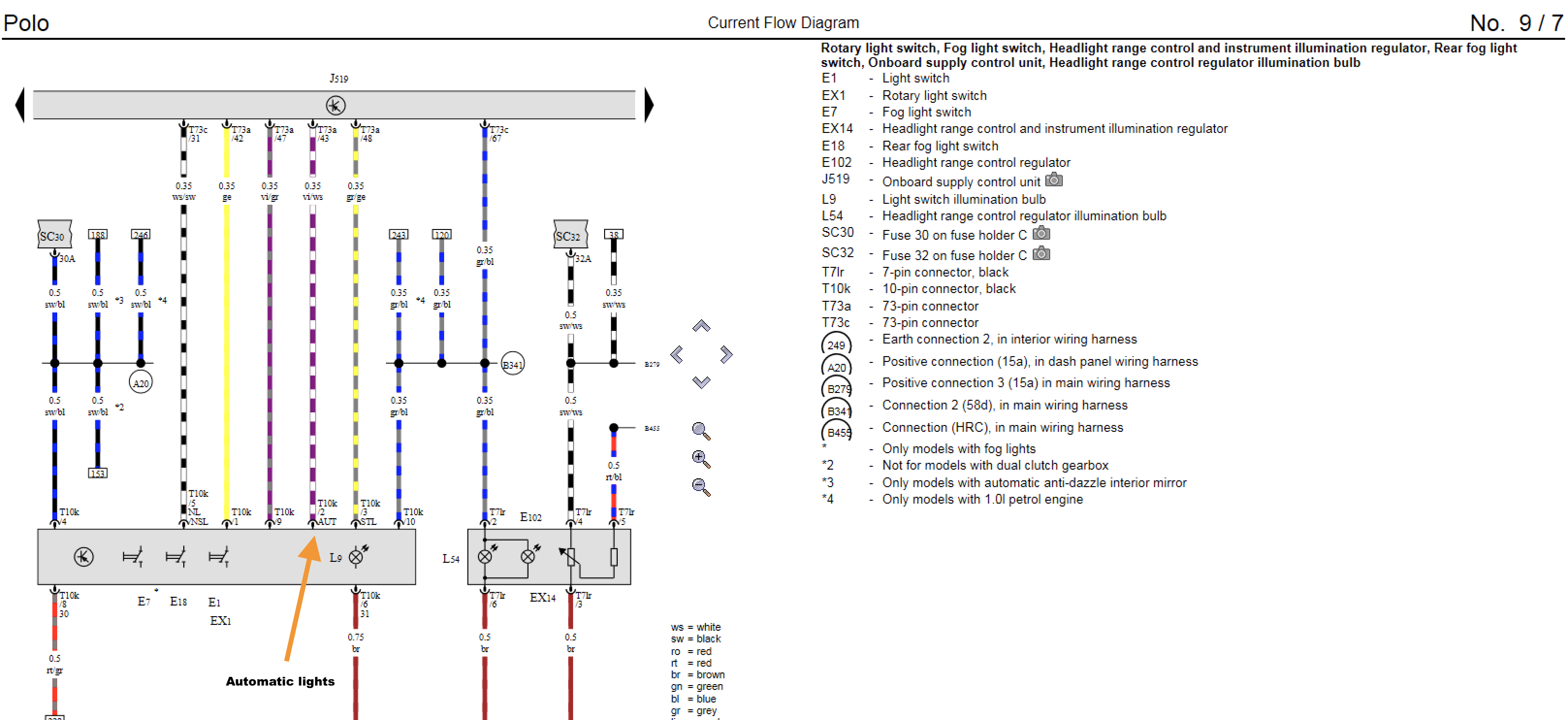

Automatic lights:

Thanks Ichel, will I need to buy a new light switch for auto feature on a 6c
On the first drawing, what would the connection 72 and 165 be?
Posts: 6693
Re: 6c wiring diagram for auto dimming mirror / auto headlights and rain sensor for retrofitting
72: +15 12v
168: reverse signal

168??
Posts: 6693
165 excuse me
