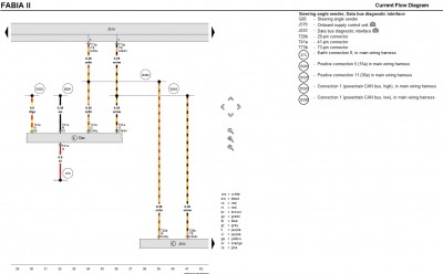

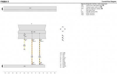

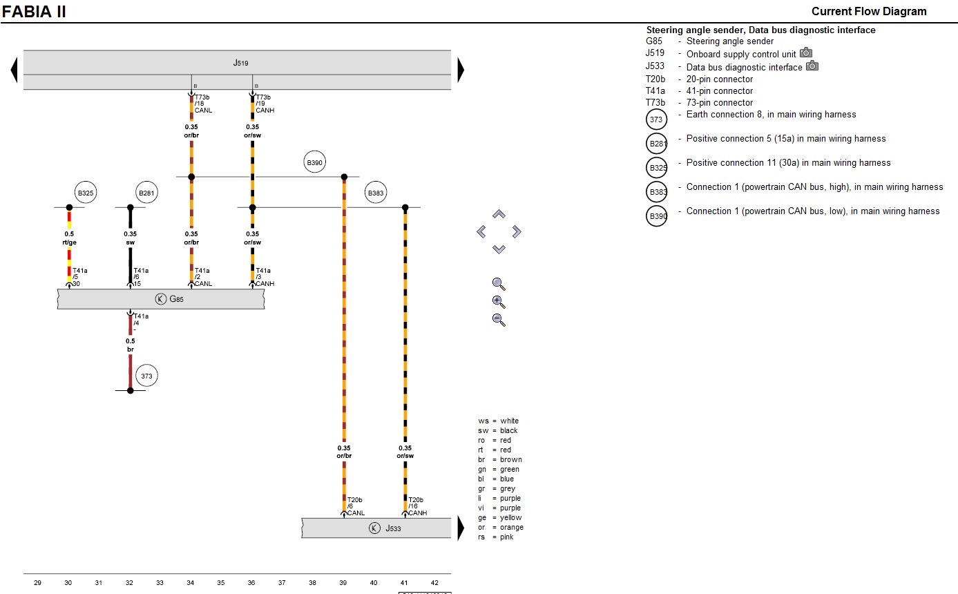

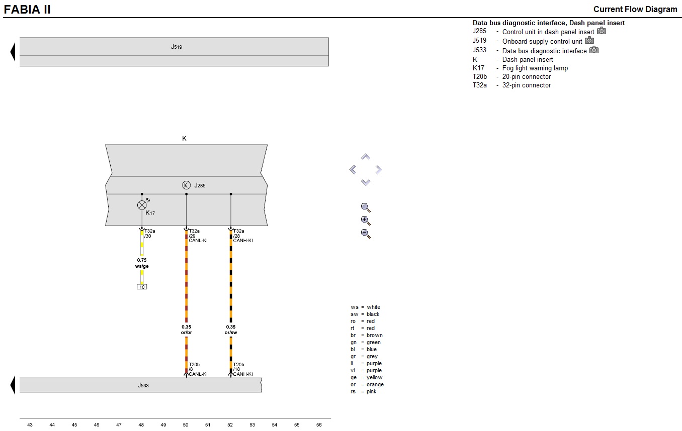

- Posts: 6693
Re: Fog lighs as Static Cornering Lights
If your car doesn't have a start/stop system, the easiest location would be the from the instrument cluster.
The CAN wires to the OBD plug are from a different CAN network. You have three:
- Can Diagnostics (to OBD)
- Can Powertrain (engine, ABS, power steering etc)
- Can Comfort (aircon, radio)
- Can Instrument Cluster (only in models with start/stop)
You need the powertrain network for the steering angle sender. Easiest location is the instrument cluster.
exantas
- Posts: 147
- Location: Iceland / Greece
My car doesn't have a start/stop system and has 086 BCM.
So should tap the two cables on the T32 plug.
- Posts: 6693
Yes, correct.
