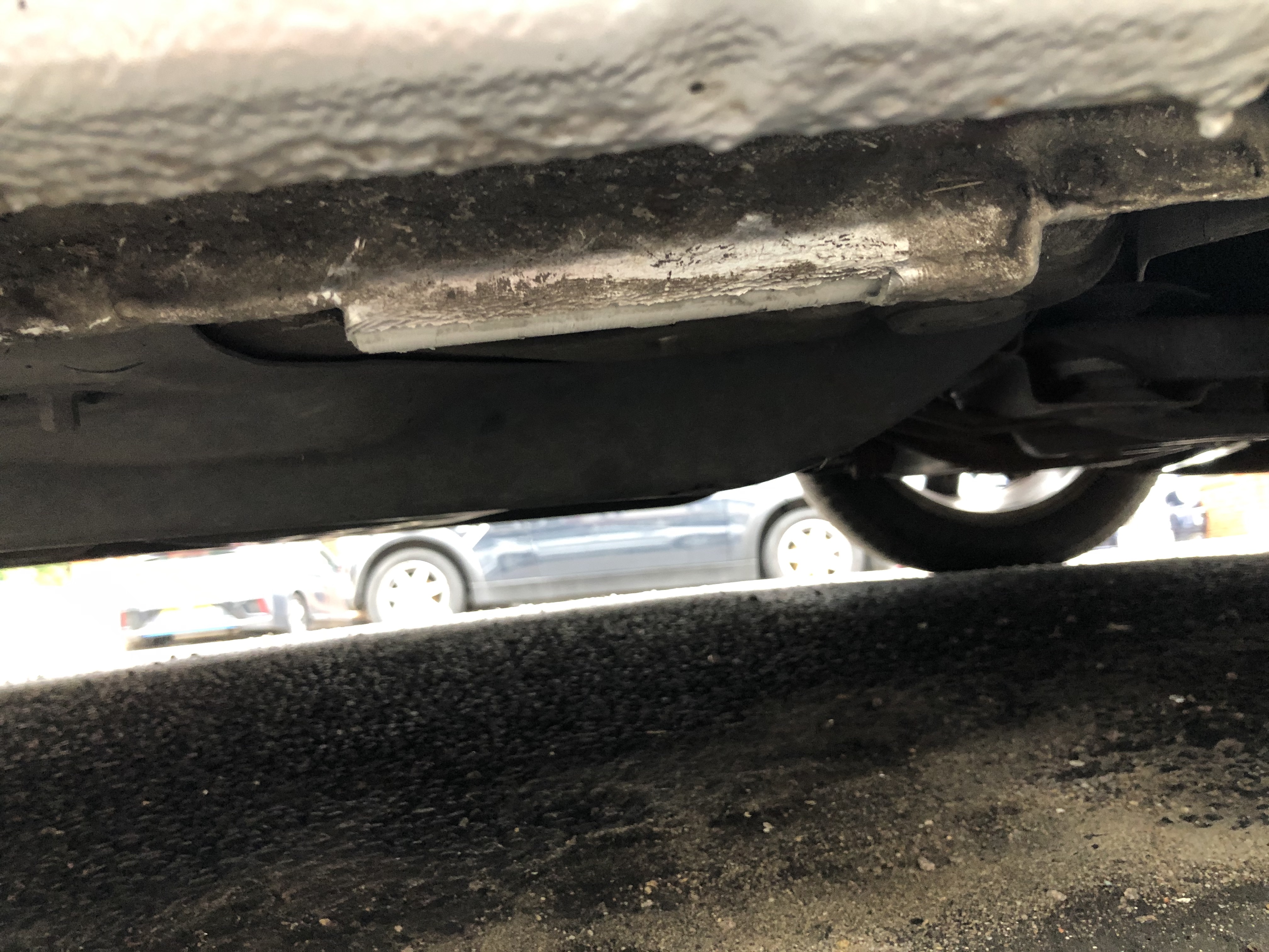

I've also attached a picture of my front right jacking point (the only one I tried) just to see if you guys can see anything that could be wrong that my inexperienced eye would have missed.

Hello, all that you have done is break off some of the stone chip protection, so no permanent damage done there, what you need to do now is to buy some paint and paint that area a few times. What colour is your car, if silver then just use smooth Hammerite.
Getting the car up off the ground, is it possible for you to buy or make a pair of ramps to raise the front for changing oil etc, ie getting some bits of wood and making a pair of solid ramps?

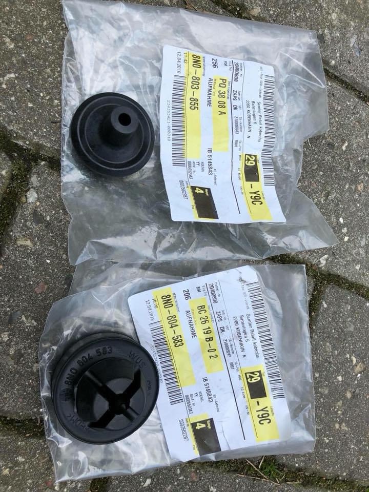

Jacking the car up, what I did initially was to buy a set of 4 "Audi TT MK1 Jacking point protectors" I first did that to my wife's 2002 Polo and have again fitted another set to my wife's 2015 Polo, that solves the issue with jacking at at these "official" 4 jacking strong points. You then can make up adaptors for your axle stands so that they fit these points without damaging, I make up load spreaders that only use the vertical strip for location and use an inner and outer area that I've fixed thick rubber to to spread the load on the horizontal areas at these strong points.
All good fun when you get it right, as I'm older and also have a car that is covered underneath with plastic covers (a lot more than the Polos) I had to buy Jackpoint Jackstands again with adaptors that spread the weight like I have described earlier.

The Audi TT bits fit into 4 holes on the car's body and give you 4 points that re strong enough to use a trolley jack under freeing up the 4 sill jacking points for you to place axle stands under.
You will find one of these points on the stiffening rails further towards the front than the front jacking points and further towards the rear than the rear jacking points - there are 4 identical round plastic - not complaint "rubber" bungs that get removed and replaced permanently with these Audi TT 2-piece jacking protectors.

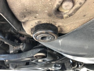

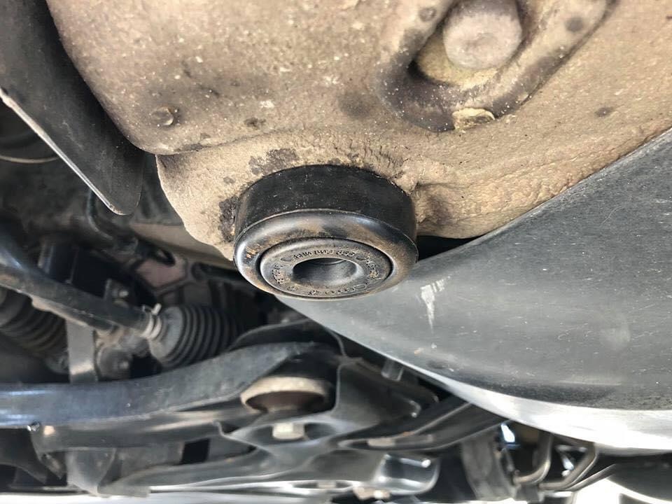

Here is what you Can do😎👍🏼
(I have them on My car)
wolfie
Posts: 578
Location: Staffordshire (UK)
Re: 6r Jacking point trouble
Post by wolfie »
They really are a proper solution. Why on earth Vdub don't sell them as accessory across the range is beyond me. Do you also have them on the rear?
