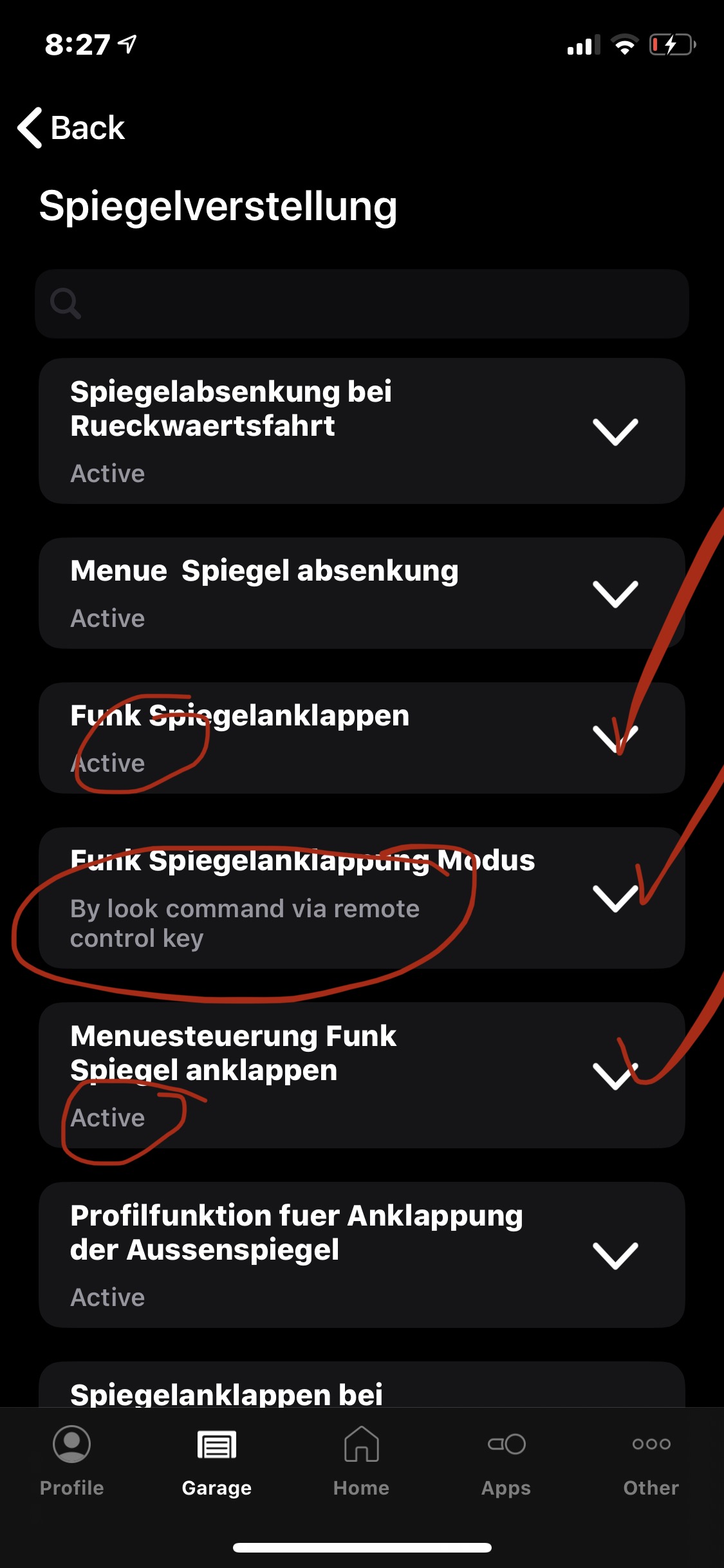

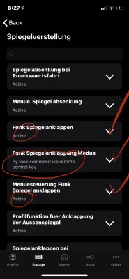

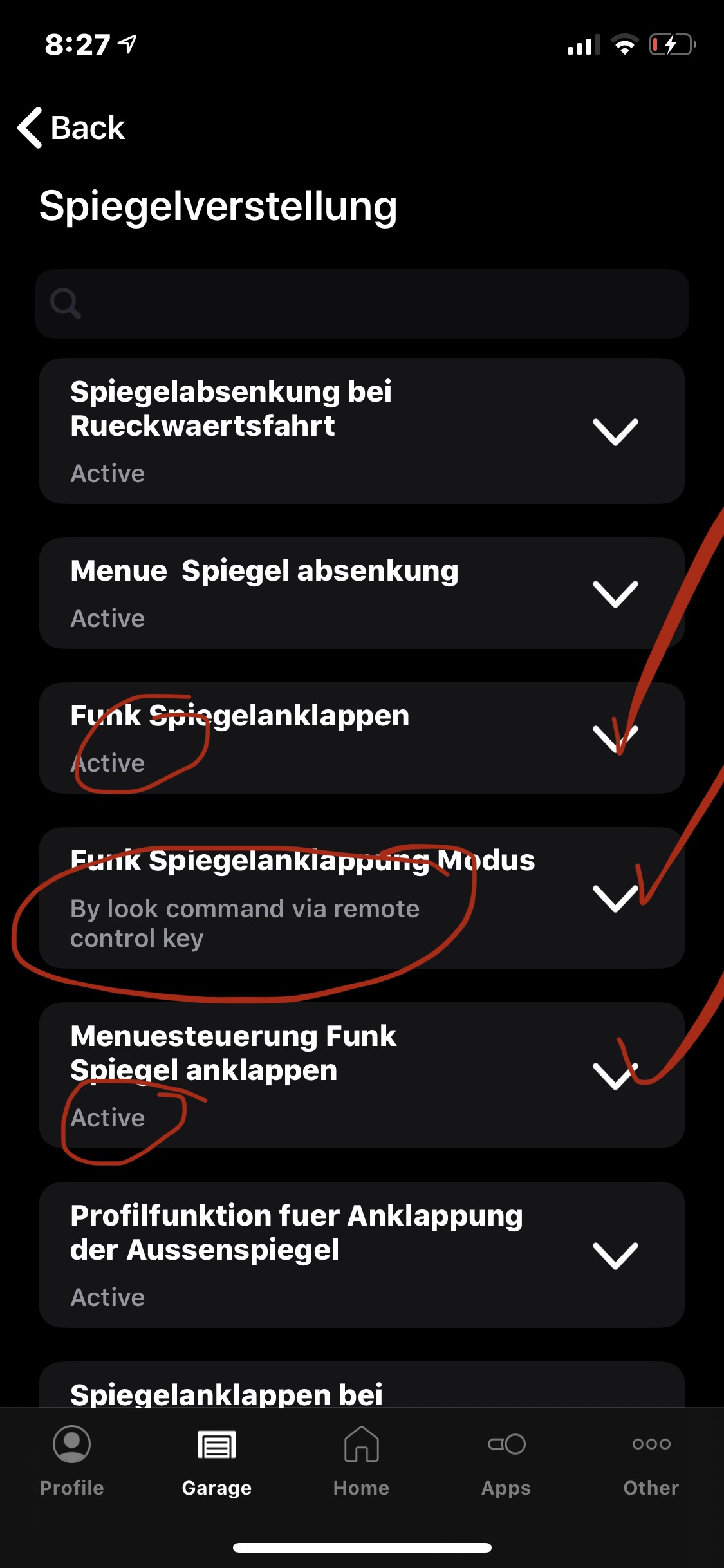

Thanks for the reply appreciate it, yeah I had a feeling gauge sweep doesn’t work for active info display.
I had a look at the mirror settings in adaptations, I found the settings in the submenu spiegelverstellung, they all seem to be already set up as you described.
OBDeleven on iOS the settings Are already as described
