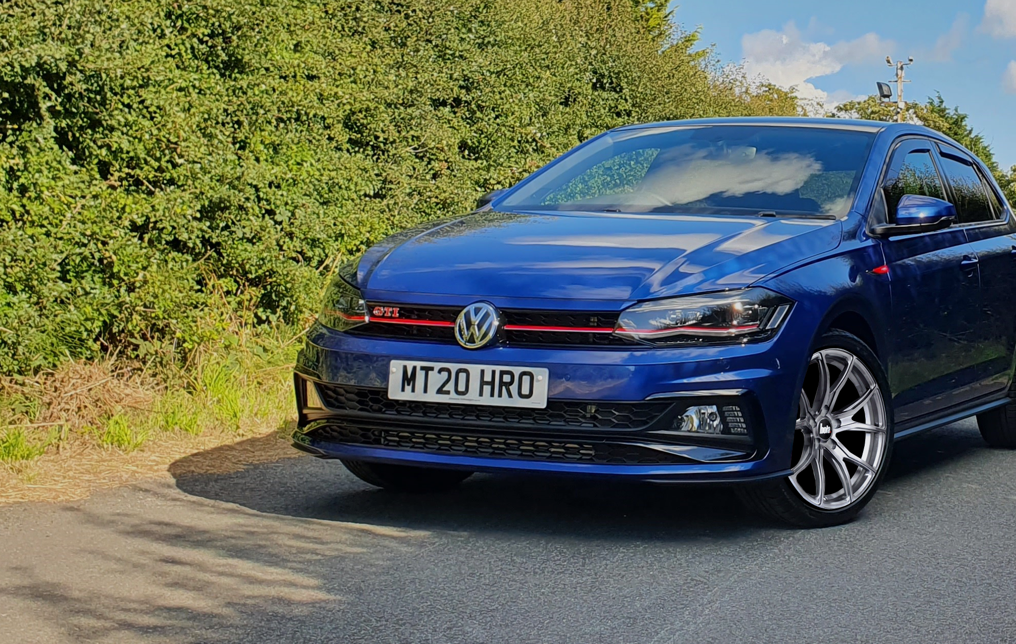

Hi I have a Polo GTI, thinking about changing the wheels.
Just wondering whats the lowest offset i could get away with on a 8 inch wide wheel?
Thinking of going for a 225/40R18 tyre on a 18 x 8.0" wheel.
Thank you.
Photoshopped them on to see haha.

They look like Bola B6 alloys.
Forum member RichTee has these on his lowered (by 35mm) GTI in 8Jx18” size. He said he doesn’t experience any clearance / rubbing issues - see recent discussion thread at the link below (7th post in the thread);
https://www.uk-polos.net/viewtopic.php?f=71&t=75246
