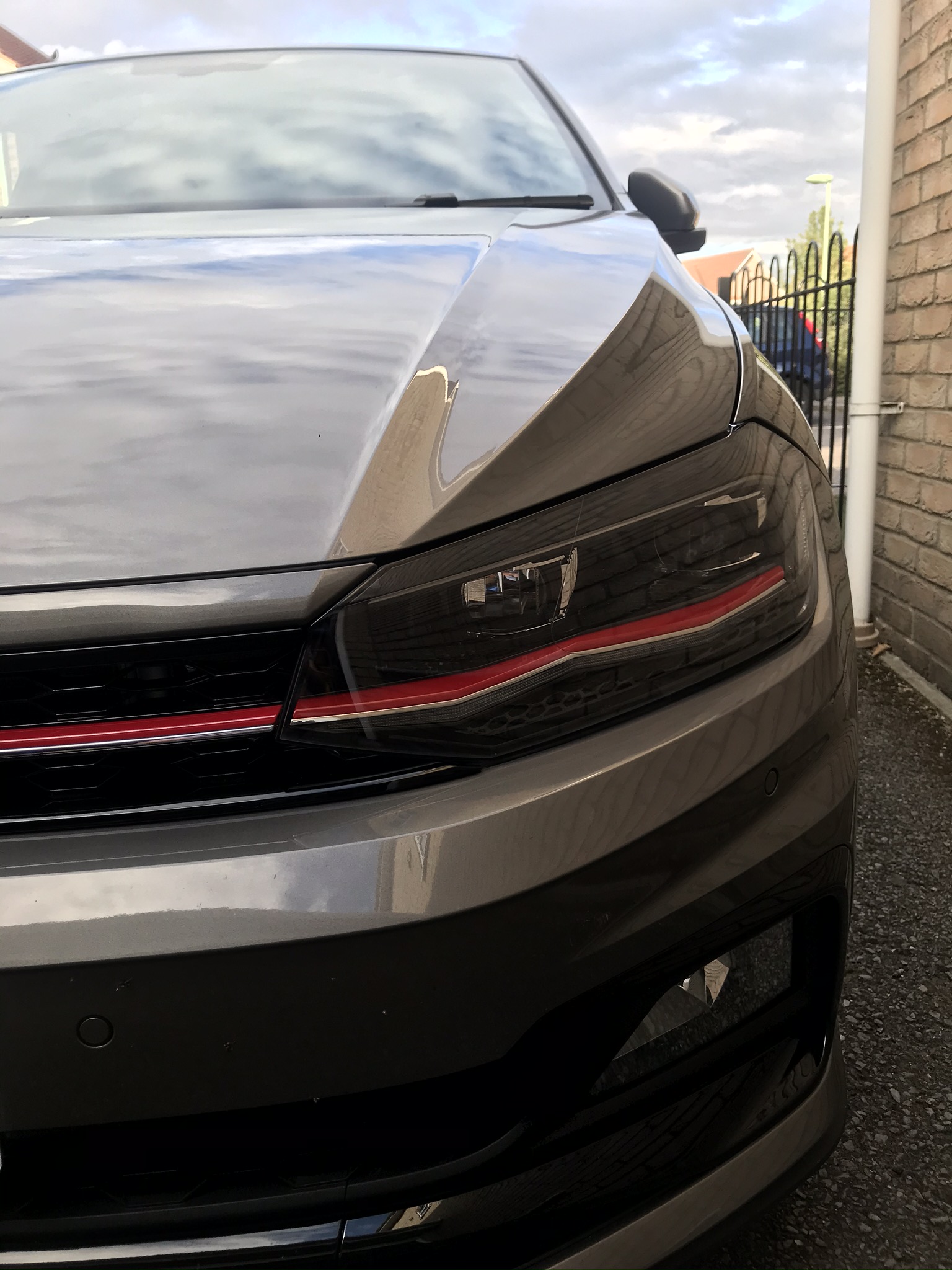

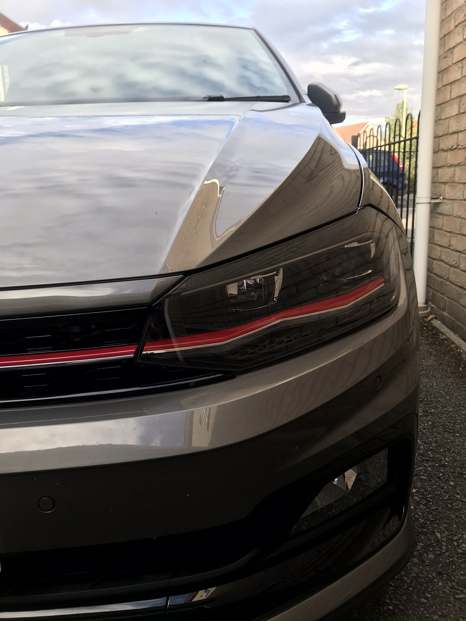

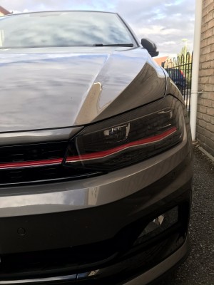

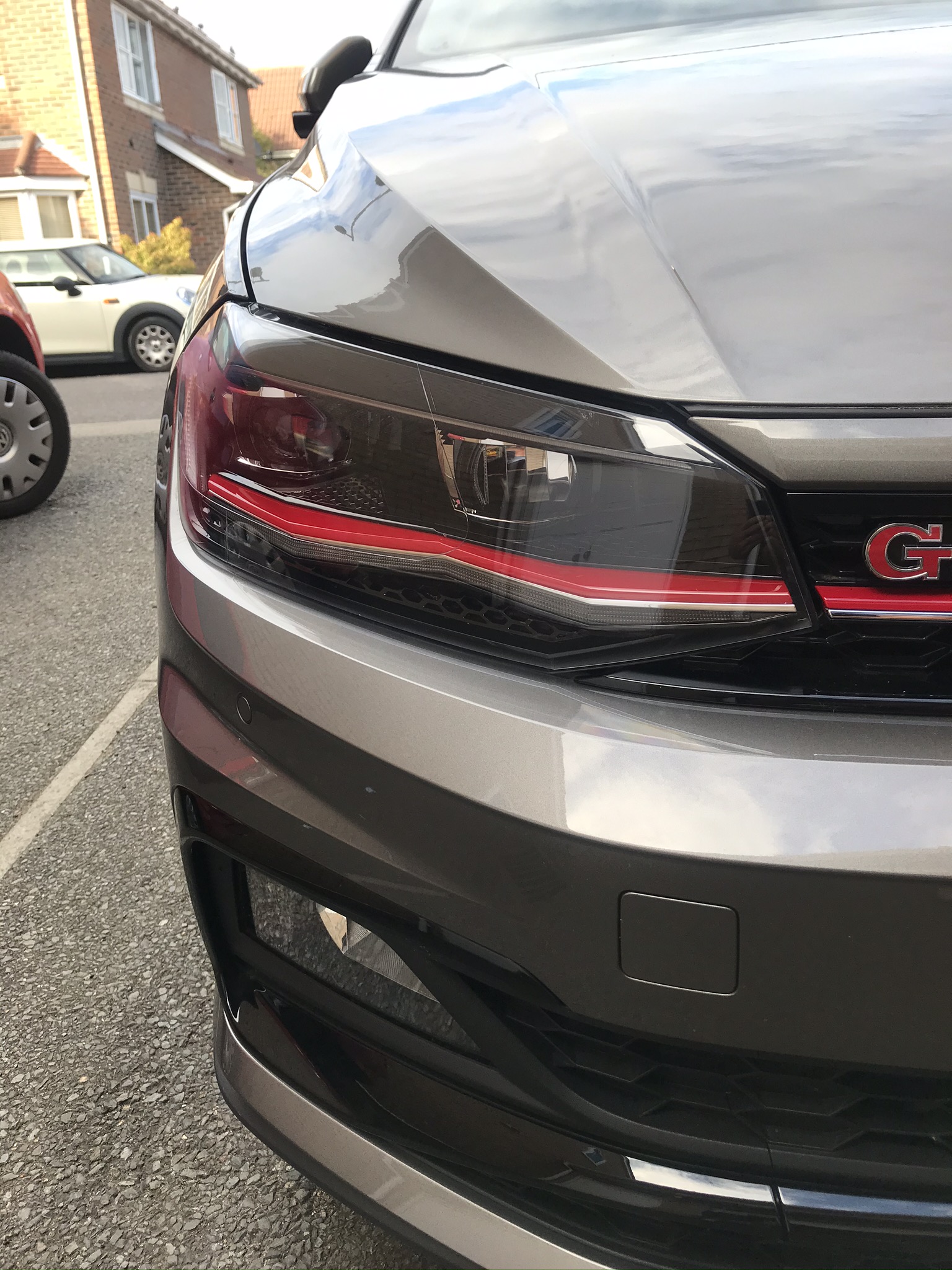

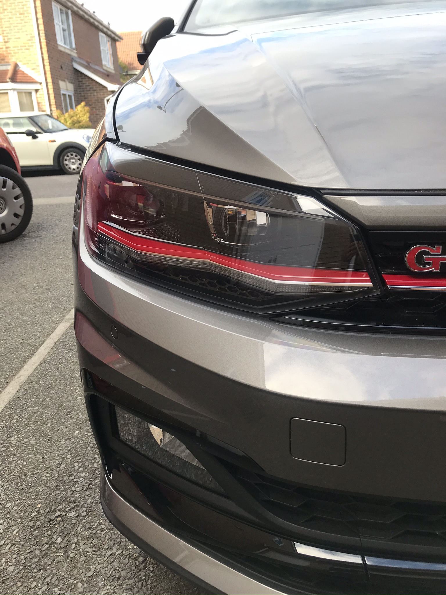

Maybe I’m being fussy, I know it’s not a hand built car or anything and I can live with it, I had a Alfa GT before so used to not great build quality, gaps on the left are a lot more evident maybe 2-3mm in differences to the right where the bonnet seems a tighter fit, is this the norm? If so then fine. Or is mine just a lazy job

That looks horrible mate, both sides look wrong, on the right hand side the gap between headlight and wing is also way off.

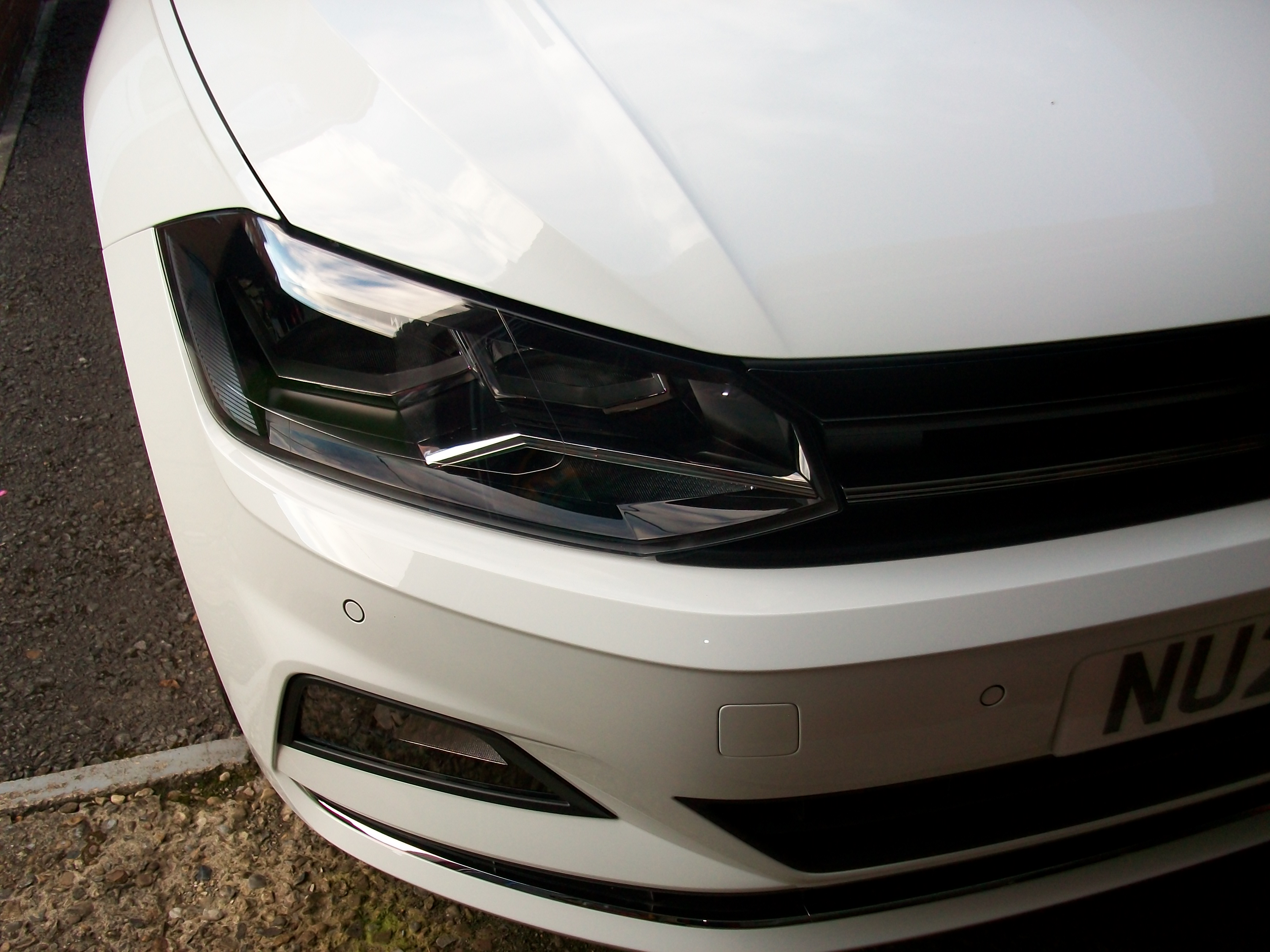

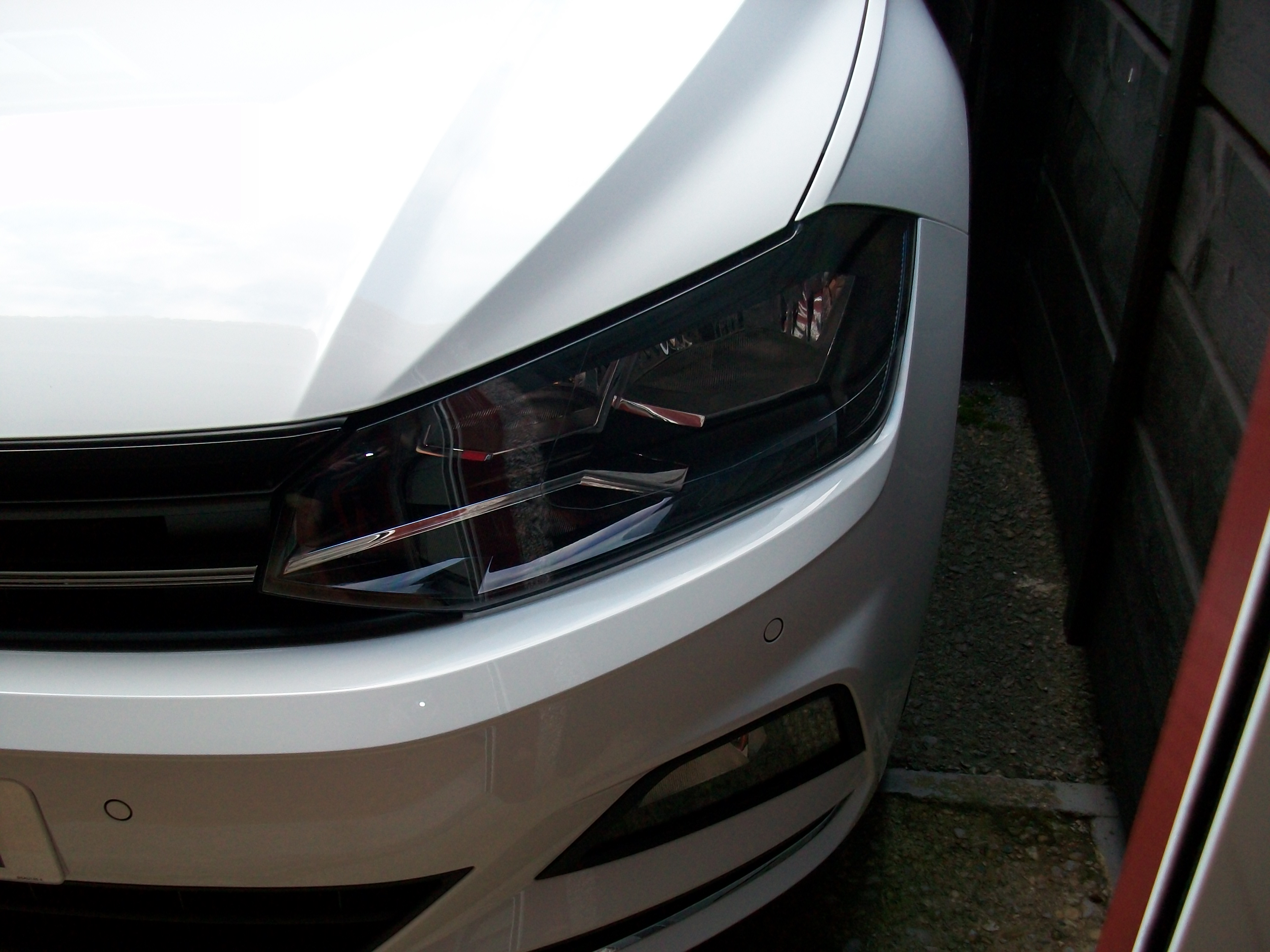

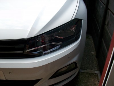

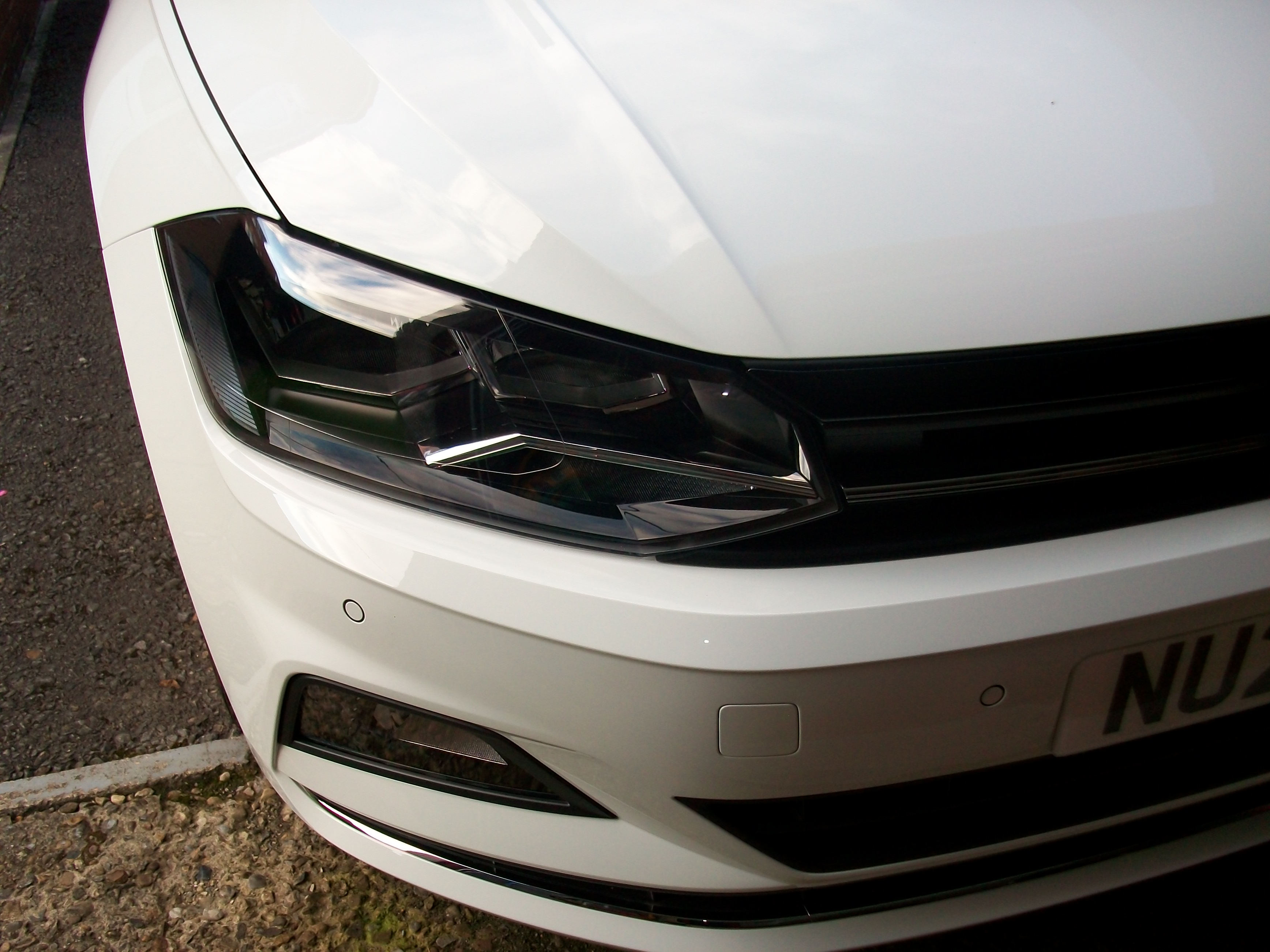

Here are mine for reference.

TheRacingRat wrote: Mon Aug 24, 2020 6:00 pm Maybe I’m being fussy, I know it’s not a hand built car or anything and I can live with it, I had a Alfa GT before so used to not great build quality, gaps on the left are a lot more evident maybe 2-3mm in differences to the right where the bonnet seems a tighter fit, is this the norm? If so then fine. Or is mine just a lazy job
You’re not being fussy at all. The gap between the wing and bonnet should be equal on both sides.
I had uneven panel gaps on both my mk5 and mk6 Golf’s, so I checked my current car very carefully on collection day before I left the dealer’s.
Take the car back to the dealer and get them to correct the gaps under warranty. Both my mk5 and mk6 Golf’s were fine once they’d been adjusted.

I have to give them a ring. Like I said never had a new car before so thought pre checks would have picked up this sort of stuff. I collected mine in the dark and in the rain! Can the bonnet be adjusted? I remember it was possible on my old mark4 escort. I guess the wings cannot be adjusted.

The wings on my previous generation Polo are bolted on, so I’m assuming it is possible to make minor adjustments by slacking off the bolts. The bonnet should also be adjustable if the hinge bolts on the underside of the bonnet are slackened off.TheRacingRat wrote: Mon Aug 24, 2020 8:57 pm I have to give them a ring. Like I said never had a new car before so thought pre checks would have picked up this sort of stuff. I collected mine in the dark and in the rain! Can the bonnet be adjusted? I remember it was possible on my old mark4 escort. I guess the wings cannot be adjusted.
As you’ve said, you would hope that issues such as this are picked up and rectified as part of PDI, but sadly, as you’ve found, things do get missed.
It’s also easy for a customer to miss things like this though with the excitement of getting their new car, and if collecting it in the dark and in the rain.

The bonnet, wings, bumper and headlights can all be adjusted, so there's no reason why it can't be made to look perfectTheRacingRat wrote: Mon Aug 24, 2020 8:57 pm I have to give them a ring. Like I said never had a new car before so thought pre checks would have picked up this sort of stuff. I collected mine in the dark and in the rain! Can the bonnet be adjusted? I remember it was possible on my old mark4 escort. I guess the wings cannot be adjusted.

That’s good news, I’m not a particularly fussy but I would like to get it sorted. I have an annoying bump/knock noise coming from the drivers side rear shock area so will get them to look at both areas once I get the bumper replayed following my recent scuff caused by someone’s bad parking. Seems new car ownership isn’t as hassle free as I thought. Still enjoying the car tho.
