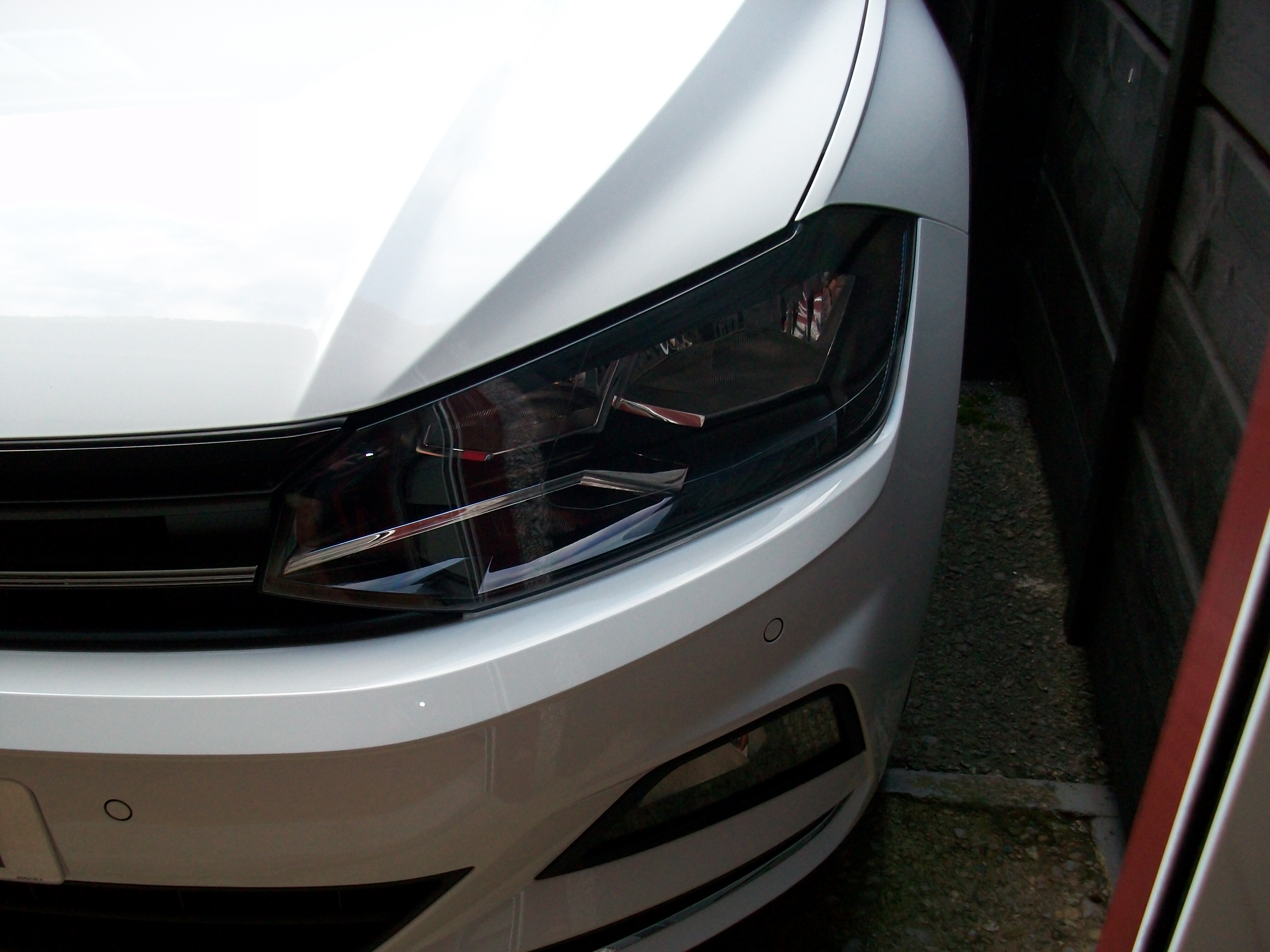

Here are mine for reference.

TheRacingRat wrote: Mon Aug 24, 2020 6:00 pm Maybe I’m being fussy, I know it’s not a hand built car or anything and I can live with it, I had a Alfa GT before so used to not great build quality, gaps on the left are a lot more evident maybe 2-3mm in differences to the right where the bonnet seems a tighter fit, is this the norm? If so then fine. Or is mine just a lazy job
You’re not being fussy at all. The gap between the wing and bonnet should be equal on both sides.
I had uneven panel gaps on both my mk5 and mk6 Golf’s, so I checked my current car very carefully on collection day before I left the dealer’s.
Take the car back to the dealer and get them to correct the gaps under warranty. Both my mk5 and mk6 Golf’s were fine once they’d been adjusted.

The wings on my previous generation Polo are bolted on, so I’m assuming it is possible to make minor adjustments by slacking off the bolts. The bonnet should also be adjustable if the hinge bolts on the underside of the bonnet are slackened off.
As you’ve said, you would hope that issues such as this are picked up and rectified as part of PDI, but sadly, as you’ve found, things do get missed.

The bonnet, wings, bumper and headlights can all be adjusted, so there's no reason why it can't be made to look perfect 8)
