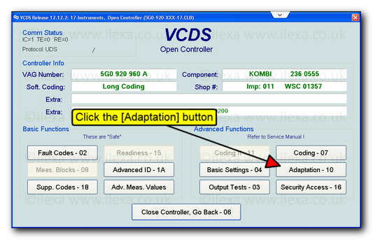

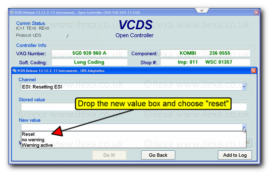

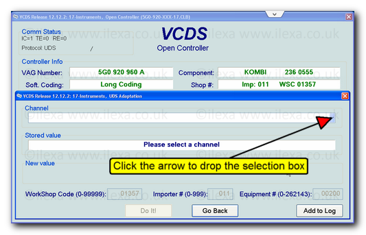

illatus wrote: Fri Apr 28, 2023 4:19 pm No luck… we couldn’t find any information inside the adaptation settings about signals or mirror indicators .. Can you guys tell me where exactly do you make those changes ?
Hello,
using VCDS:
Go to 09 (Central Electrics)
Go to Adaptation-10
When the drop menu opens, seach for "Leuchte16BLK"
You will see some lines with that word.
Choose the "ENG124877-ENG115266-Leuchte16BLK SLC11-Type_Of_Load_16"
Set the new value to "LED Blinkleuchten" . (photos are for reference only, do not accurately represent the process)
Select Do it !
Then do exactly the same thing with the "Leuchte17BLK"
