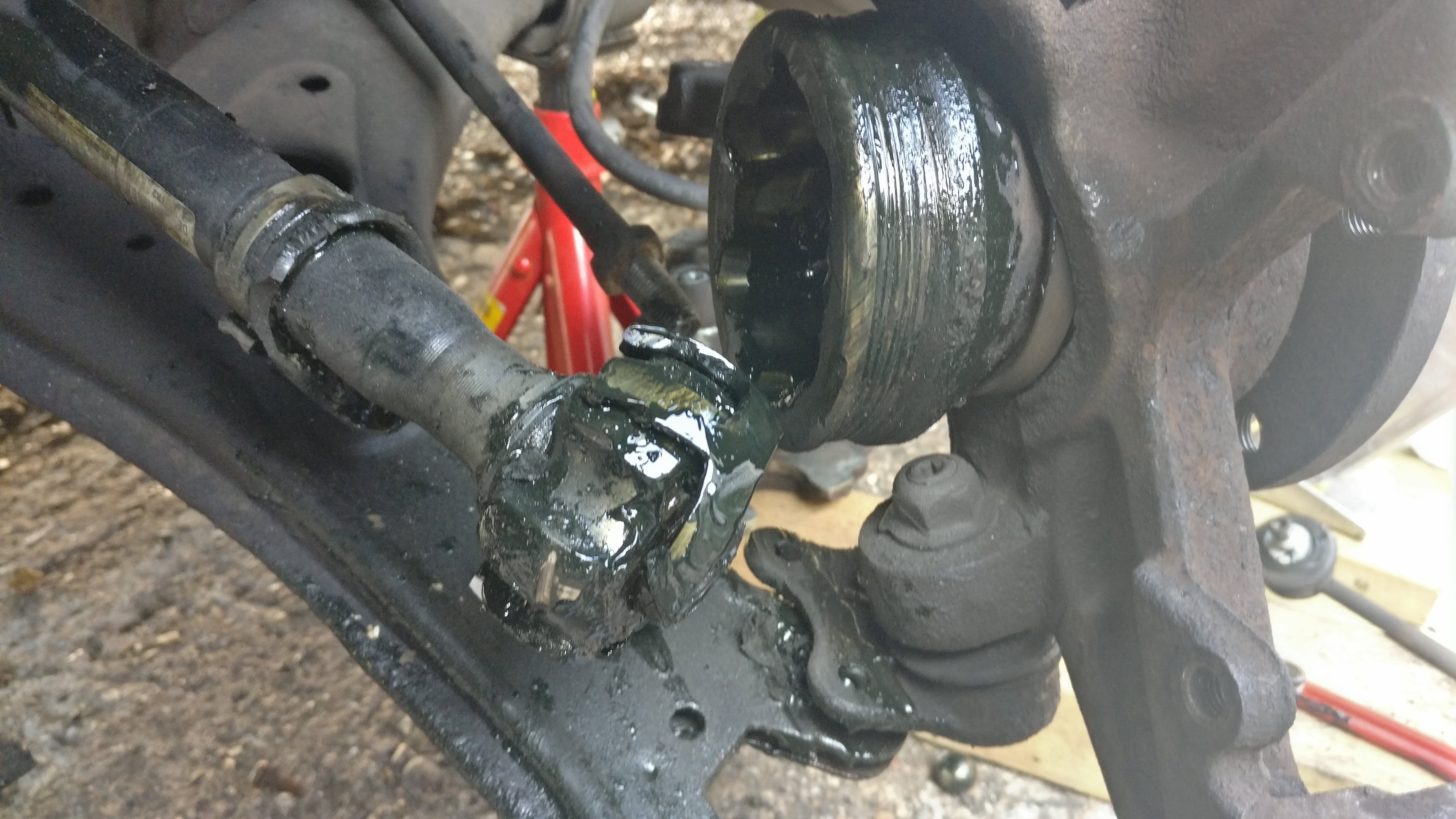

The driveshaft is stuck fast. Opened the stub axle boot to try and drift it off but that's not moving either. Probably going to replace the driveshaft assy. Can anyone help with a part no please? 2002. 14.16V BBY auto.
littlepolo
Posts: 836
Re: 9n front wheel hub nut
Post by littlepolo »

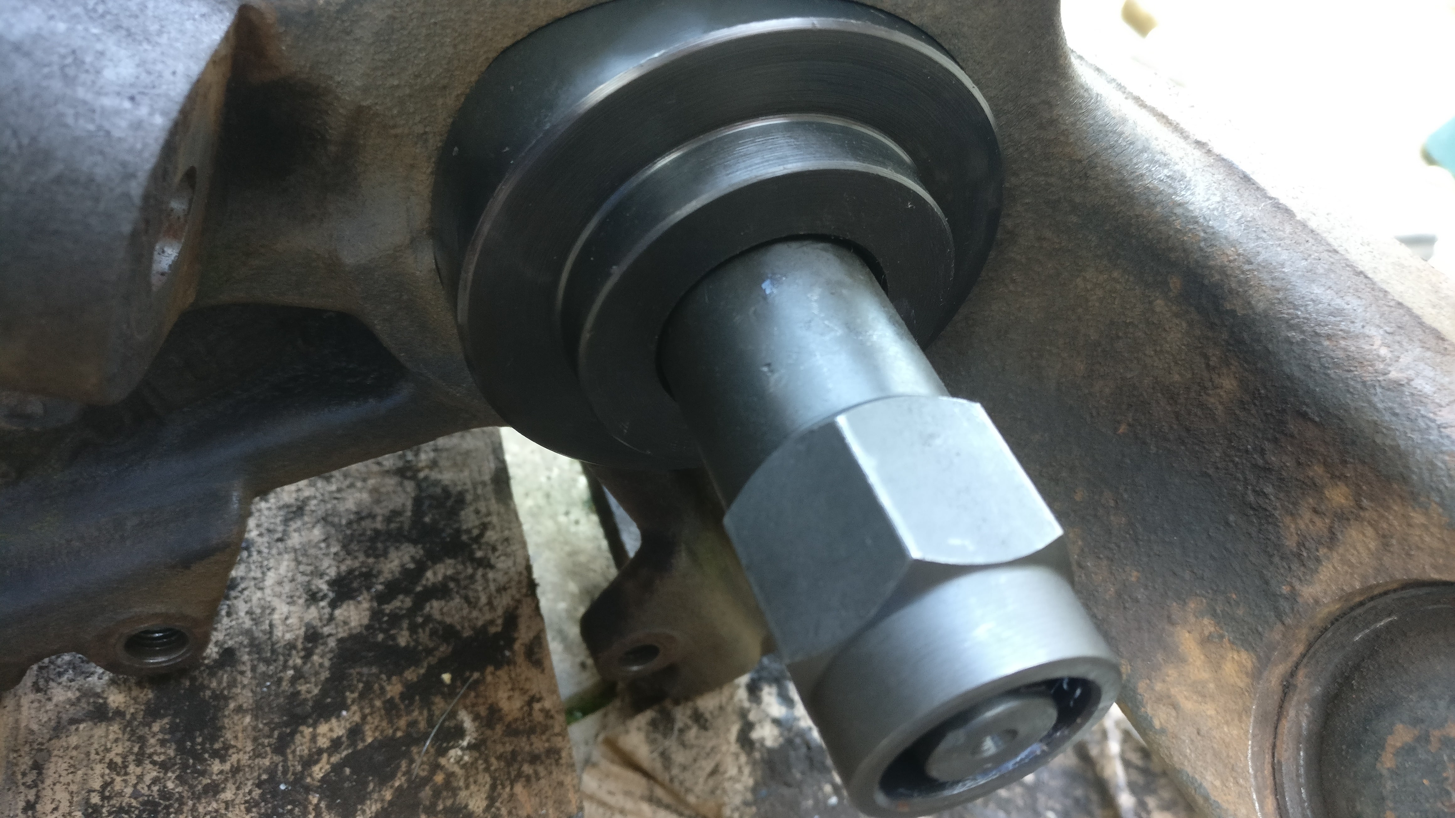

Just a quick update on progress. Will post photos and remaining work later.

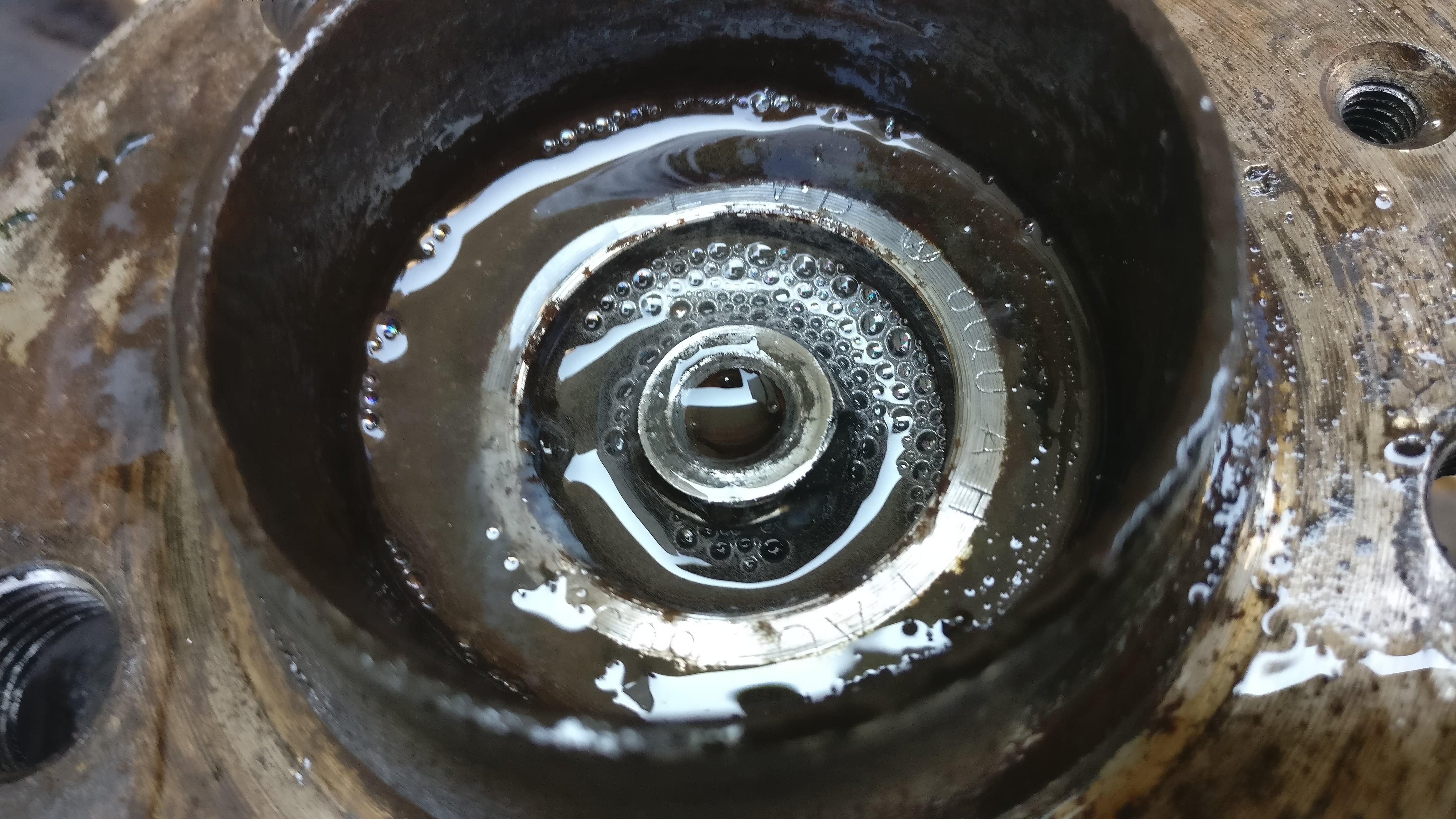

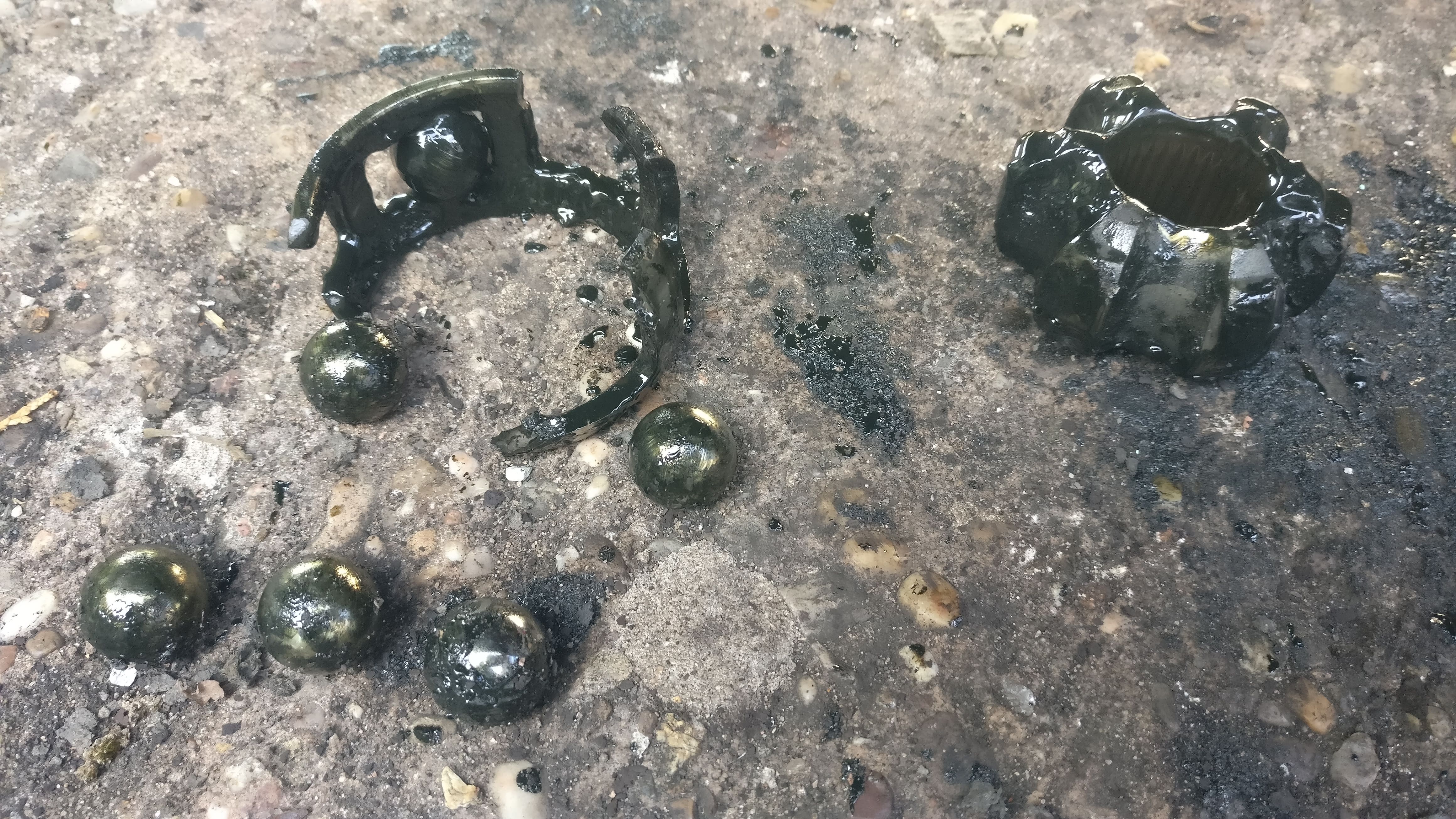

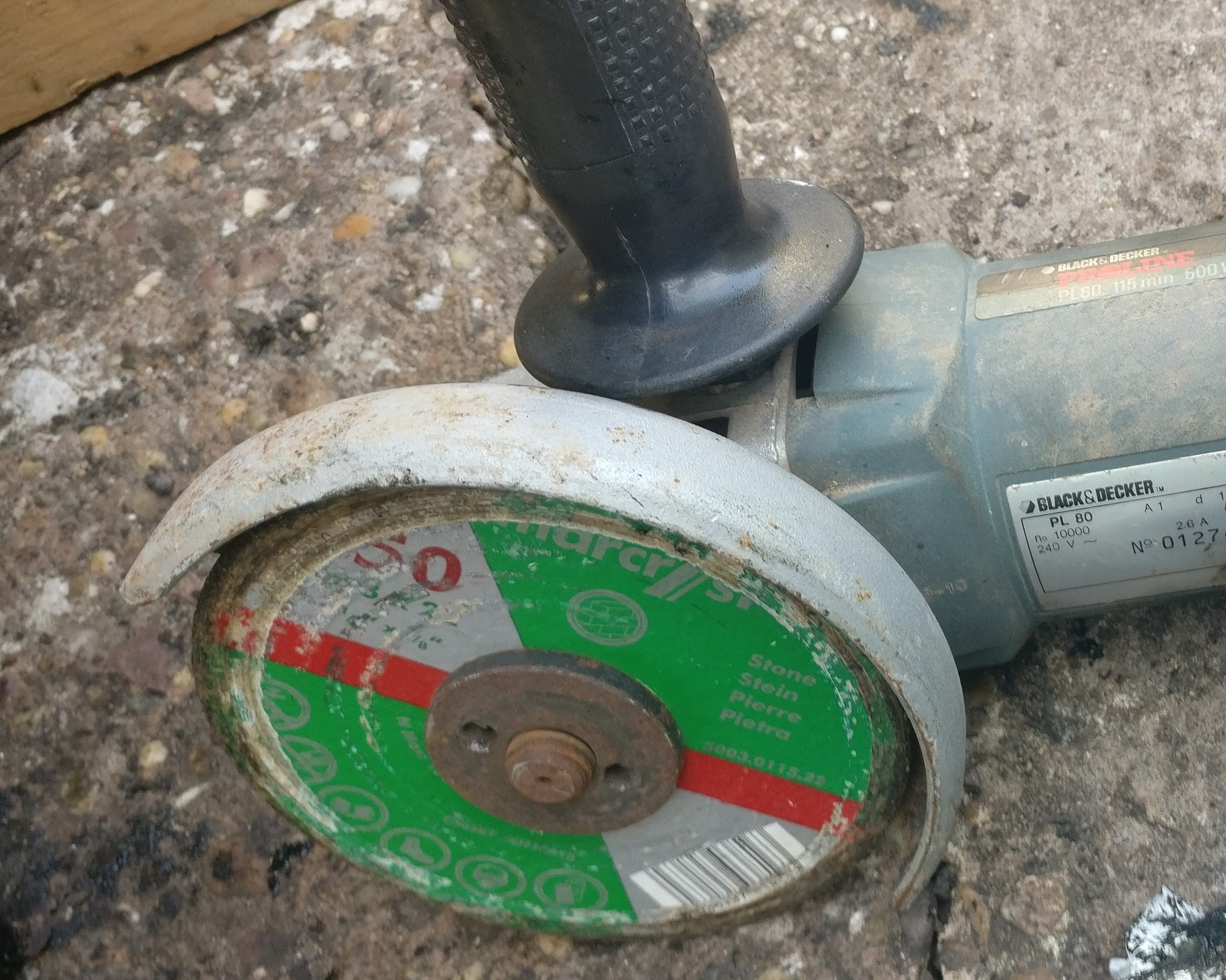

I could not drift off the stub axle/cv so took an angle grinder to the ball race after cutting open the boot.
Released stub axle/hub assy from driveshaft.
Removed strut assy (3 bolts at top).
Stub axle inner spline was then able to drift off the driveshaft (driveshaft splines look OK).
Left stub axle soaking in a pool of Plus Gas overnight (it had drained down in the morning).
More Plus Gas.
Set strut on wooden blocks and hit stub axle with a drift and a lump hammer (slight movement but then stuck again).
More Plus Gas.
Fitted puller assy and loaded puller (no movement detected - on an in-situ attempt the movement was the wheel nuts bending).
Hit M25 bolt a few times with a sledgehammer.
Able to rotate puller bolt with a lot of creaking and eventually driveshaft dropped out.
Applied Plus Gas around wheel hub/bearing assy.

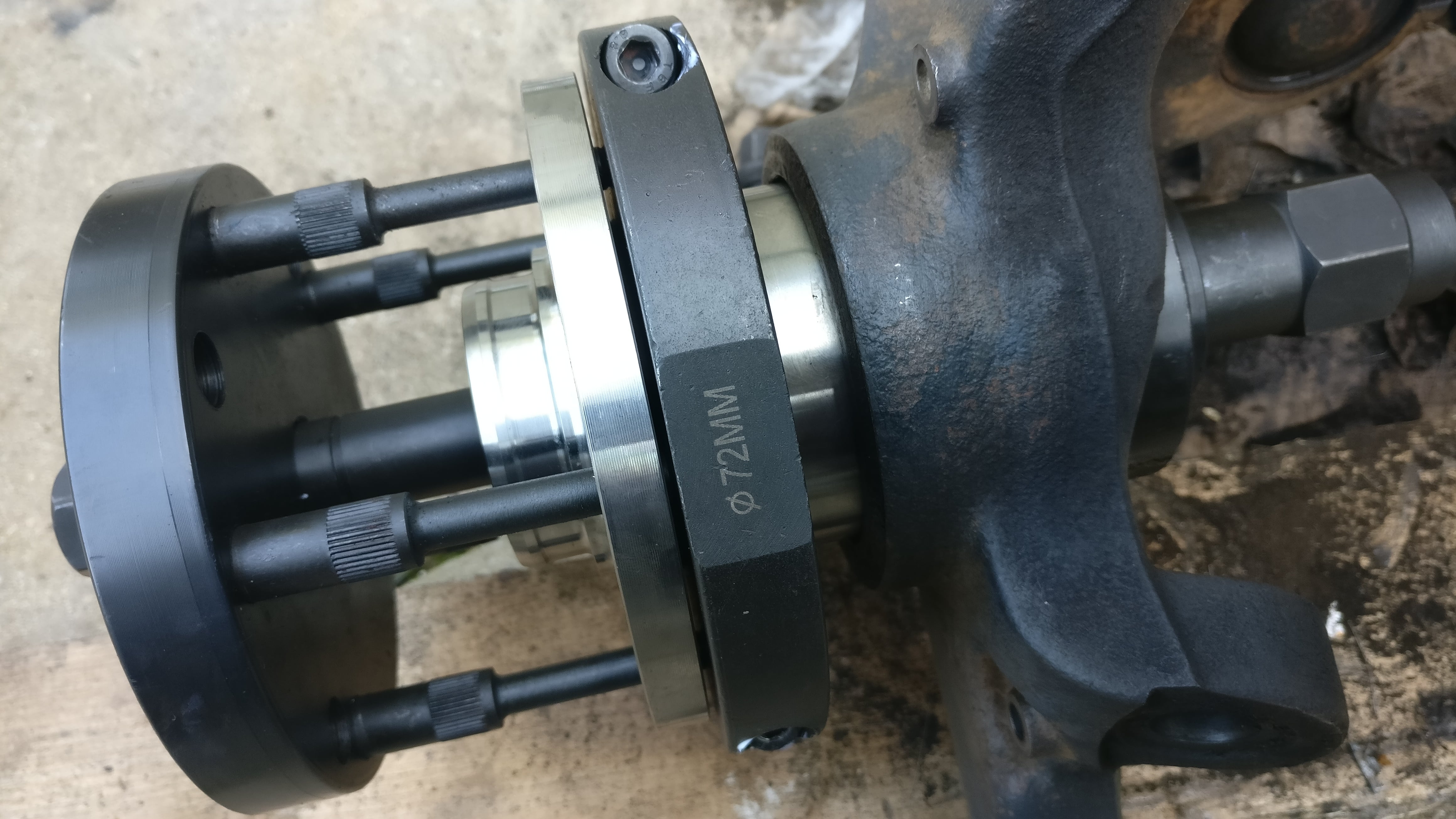

Fitted 72mm bearing extractor tool.
Used long breaker bar and after more creaking old bearing/hub assy came out.
Cleaned up steering knuckle with a wire brush.
Cleaned up bearing housing and ensured that reliefs (undercuts) were clear.
Applied lithium grease to bearing housing (it was all I had at hand).
Used bearing tool to press in new bearing (it went in a lot easier than it came out - minor creaking as it pressed in).
Decided to fit new components (drop link, ball joint, steering rod end) to n/s front due to possible damage from sledgehammer applied to loaded puller. Also going to replace the front strut top bearing since I have one of the pair left over from doing the o/s some years ago - I can't recall but think this is fitted without any grease/lube?.

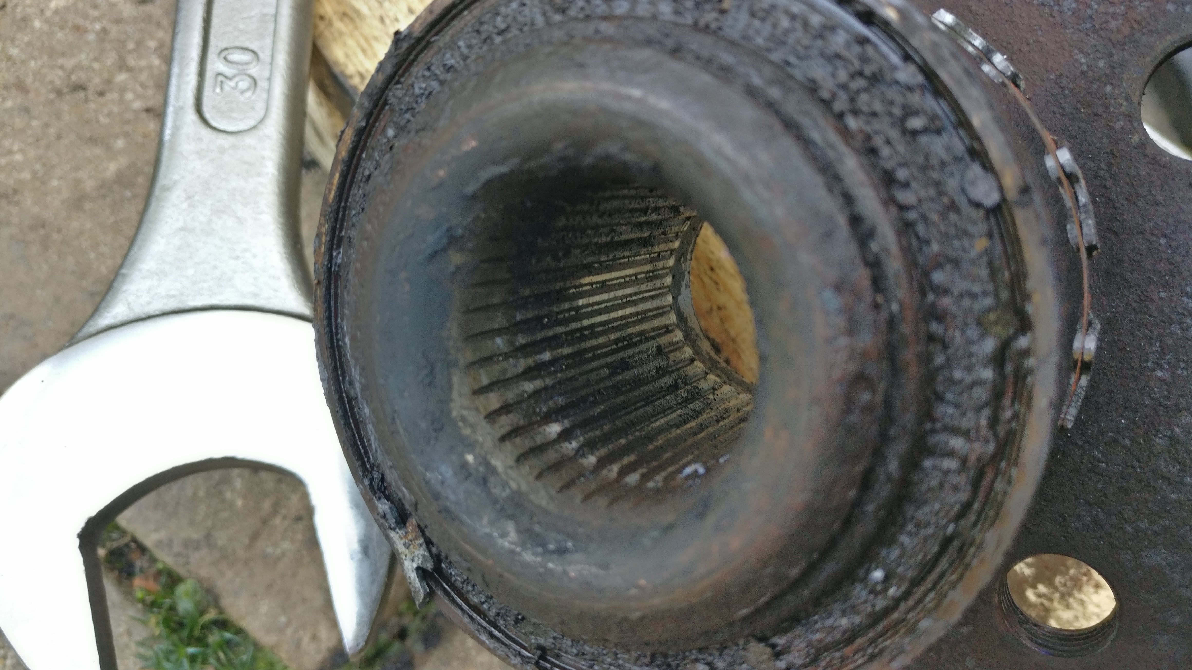

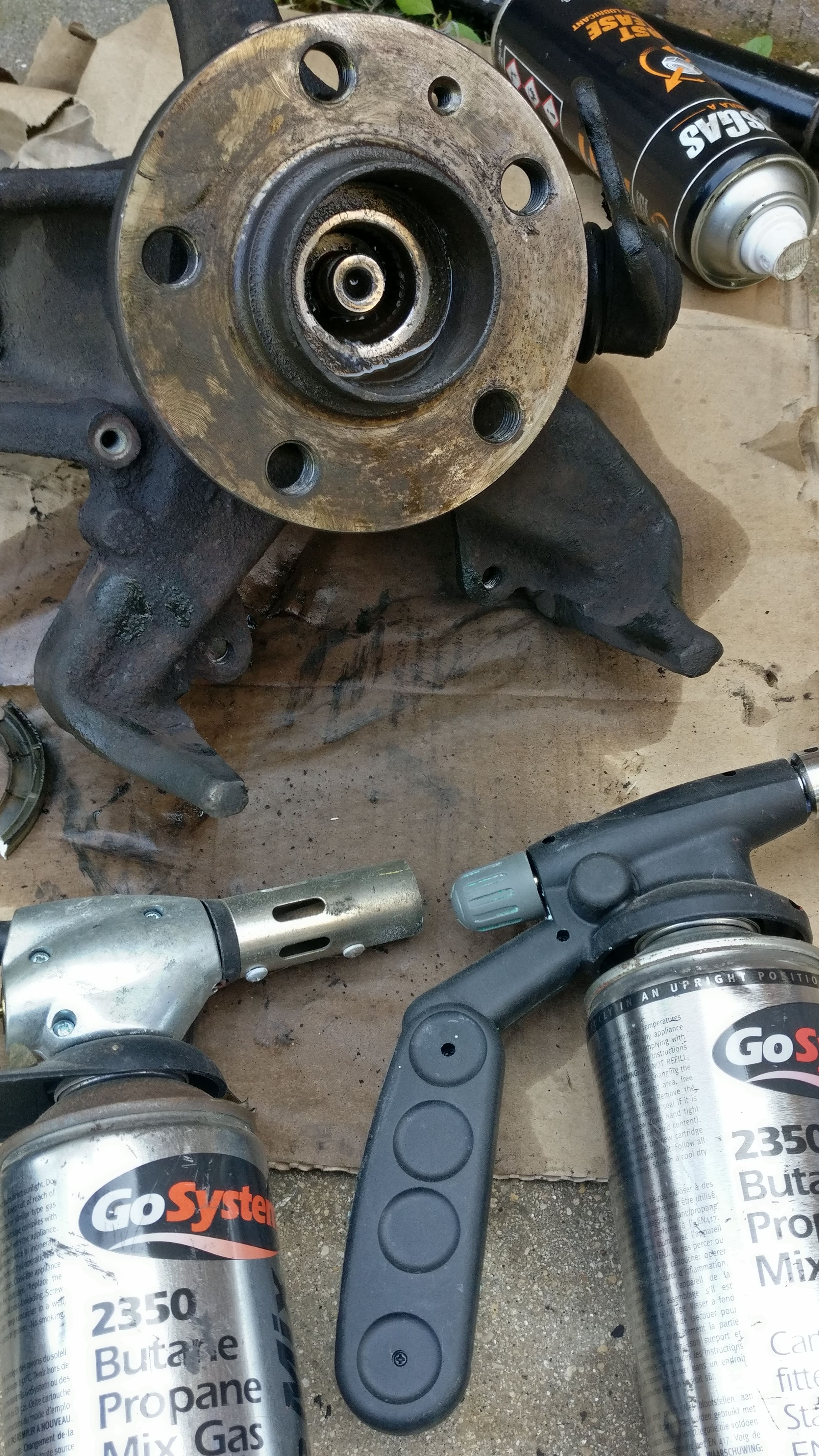

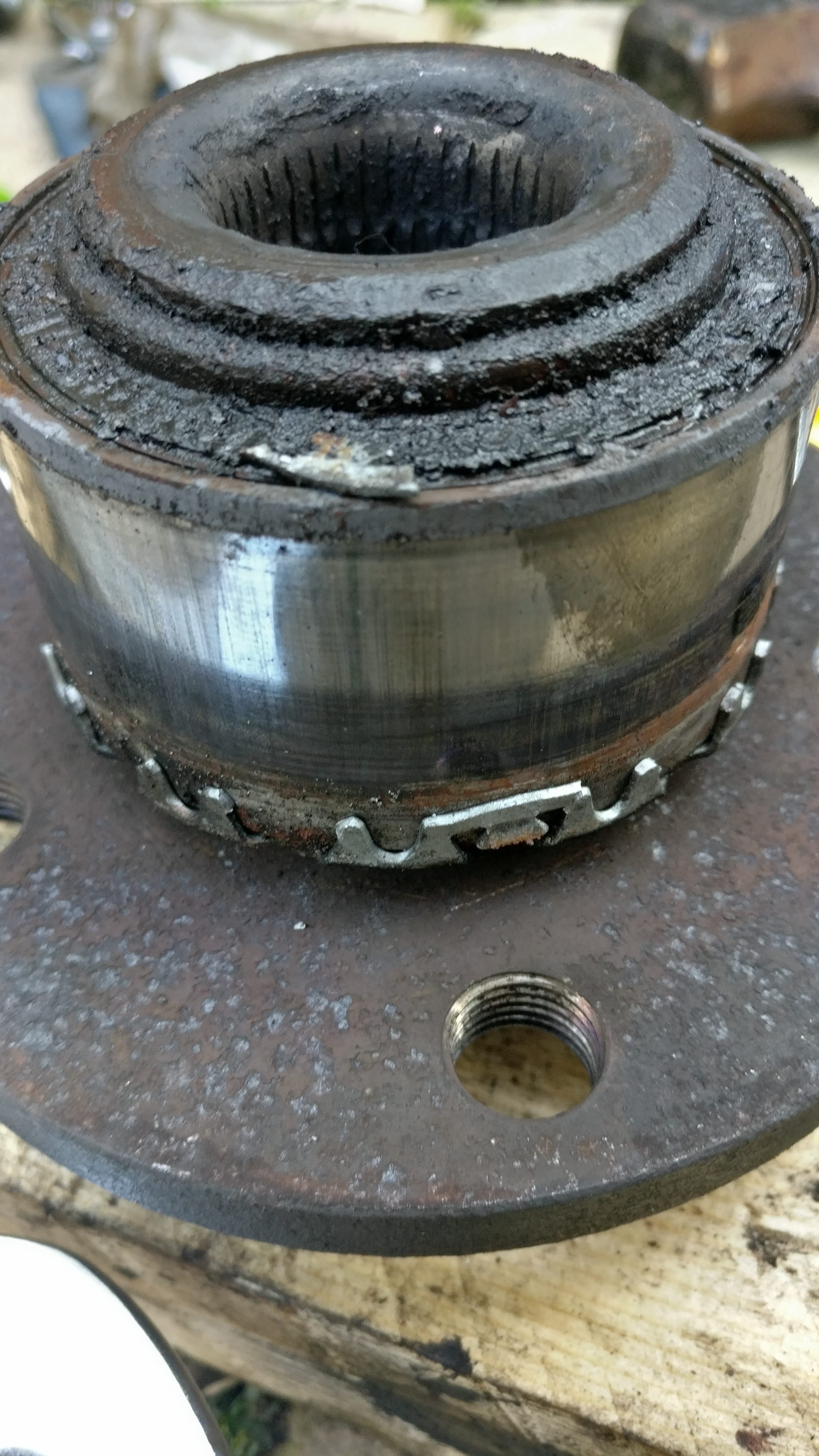

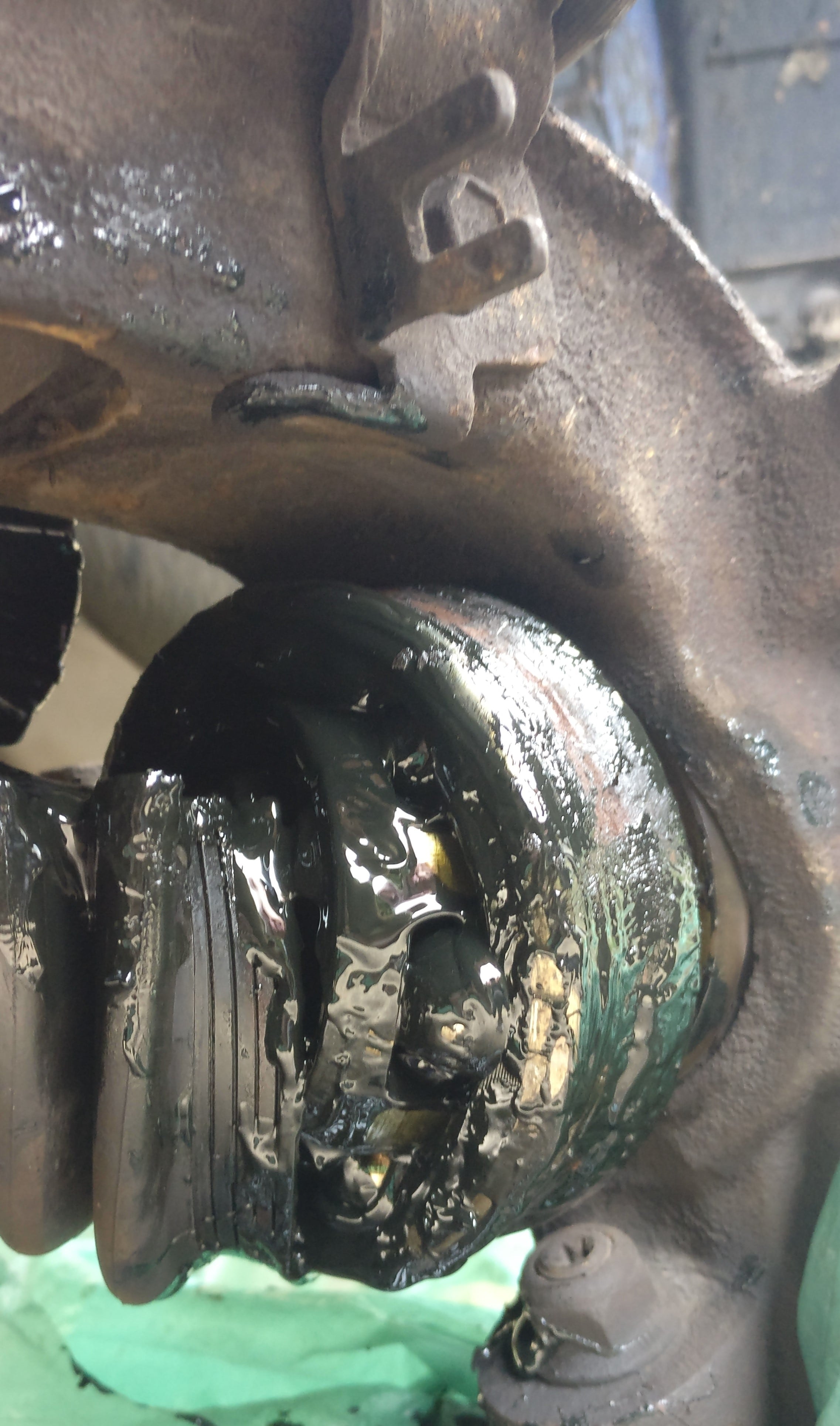

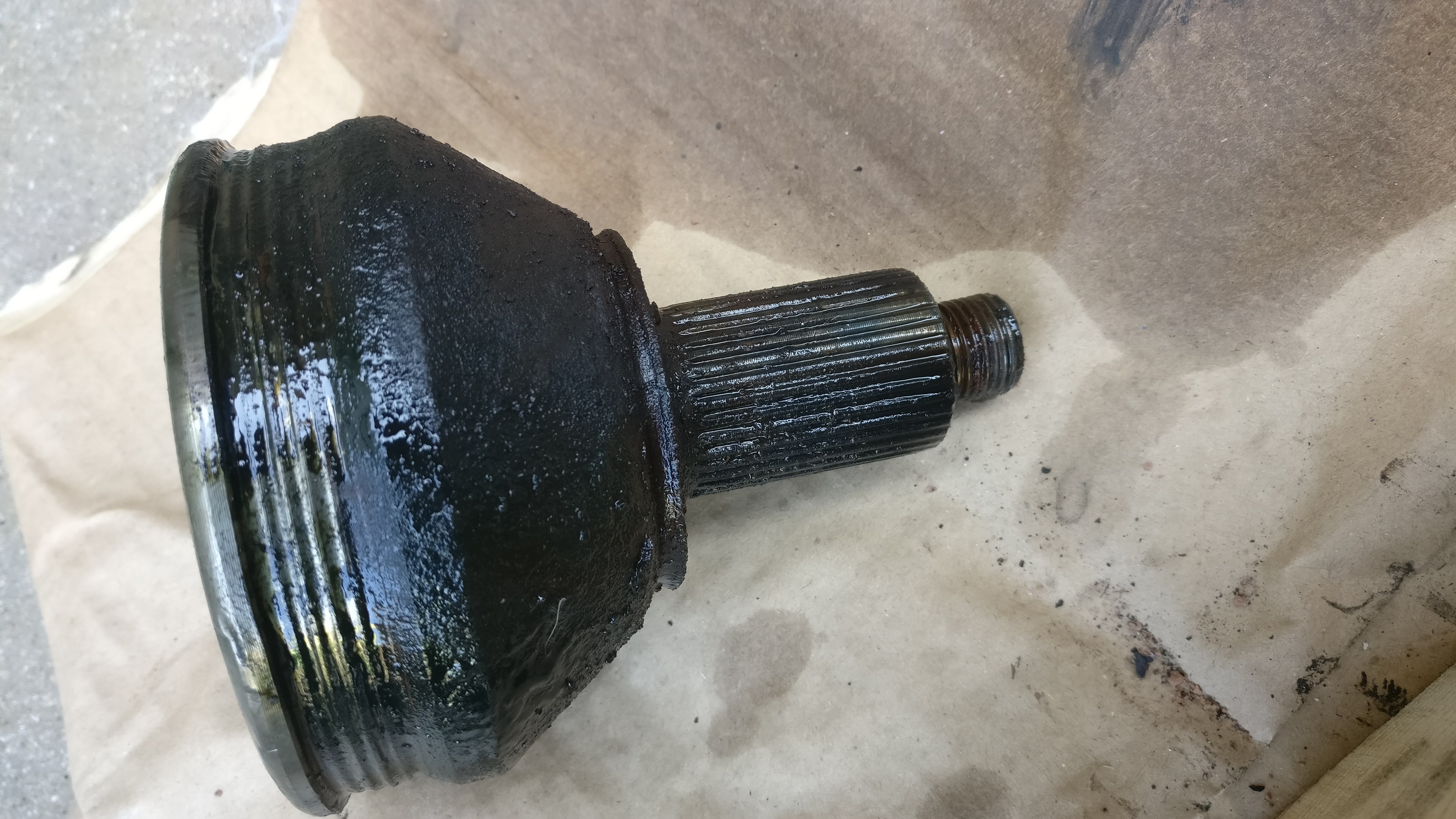

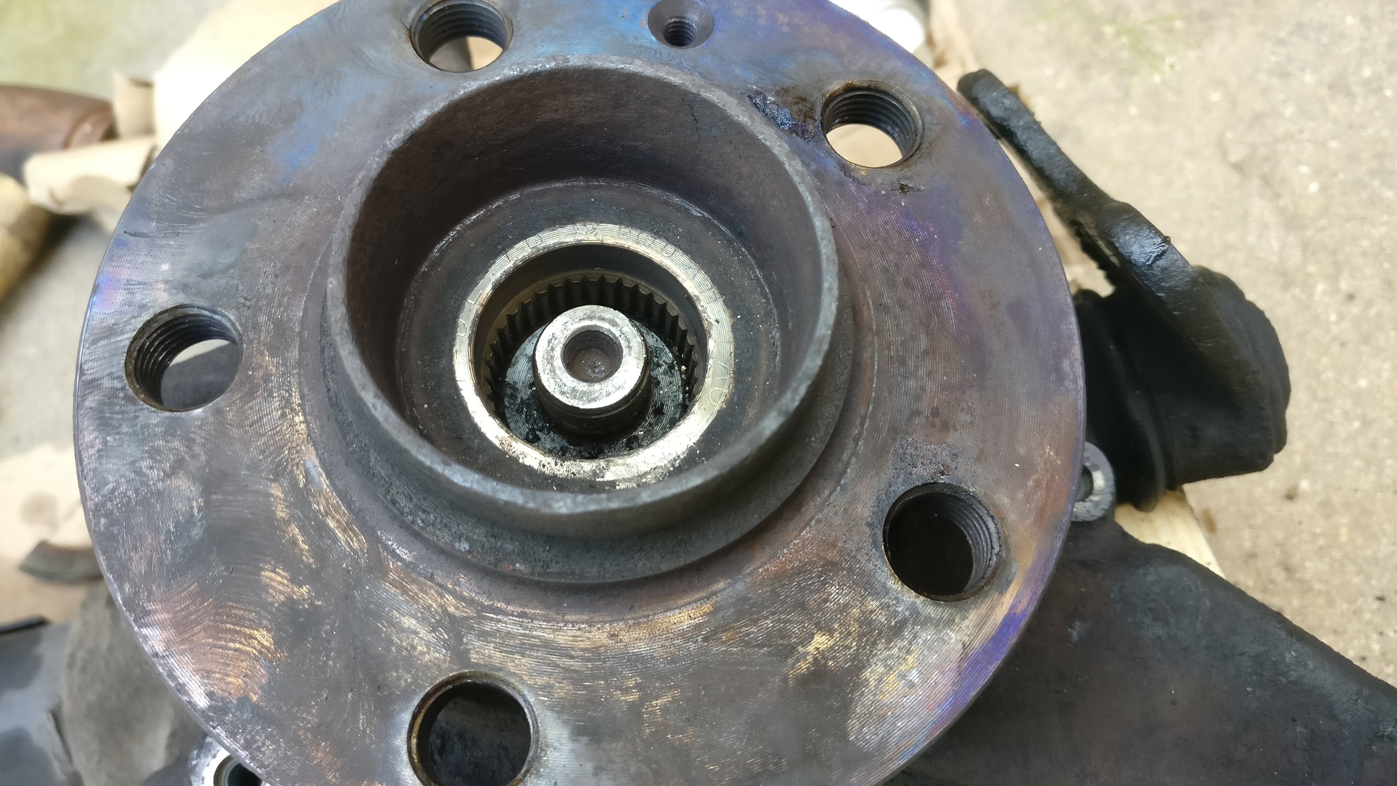

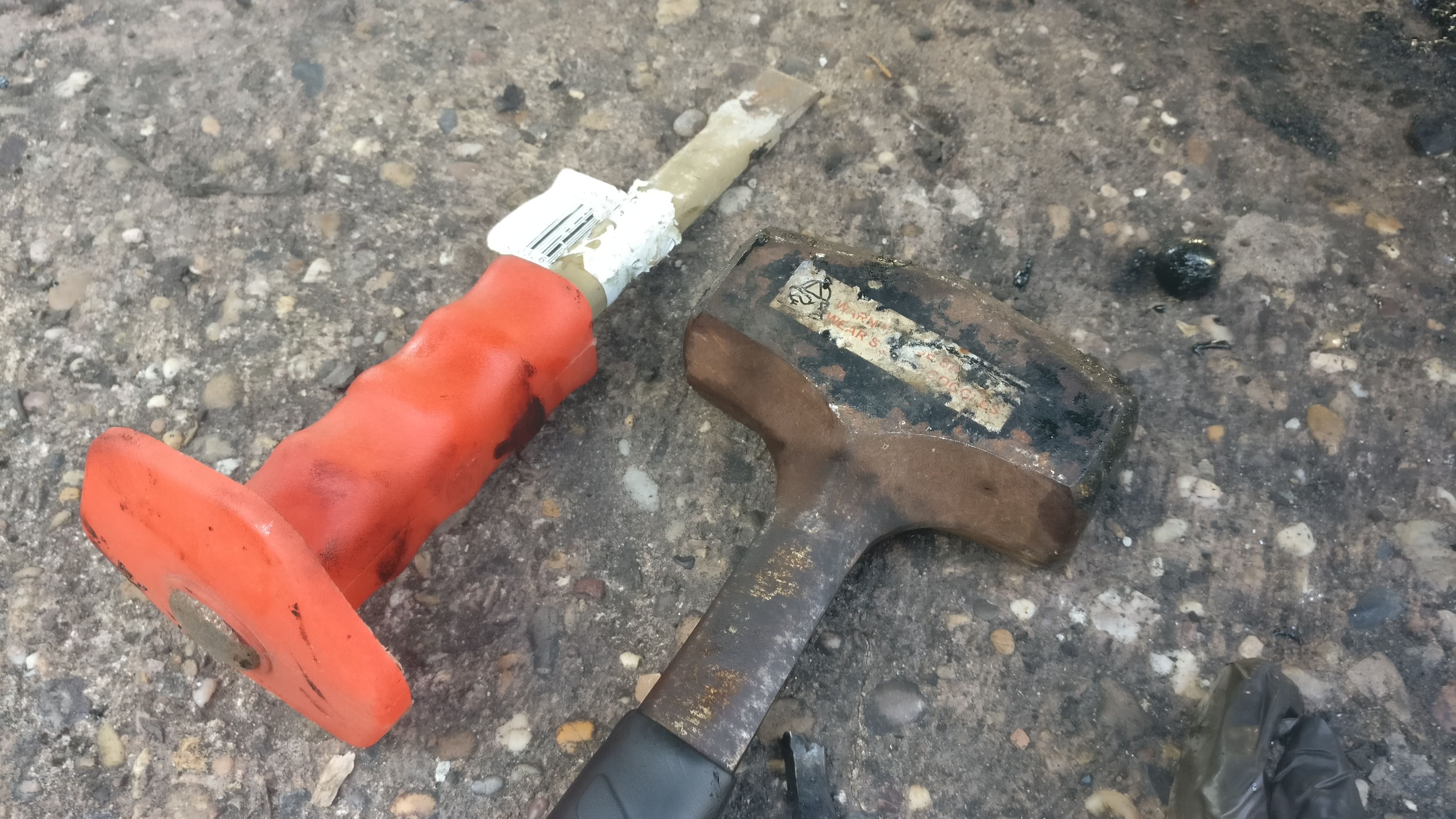

The saga so far in pictures.
Trying to remove hub assy
Firepower

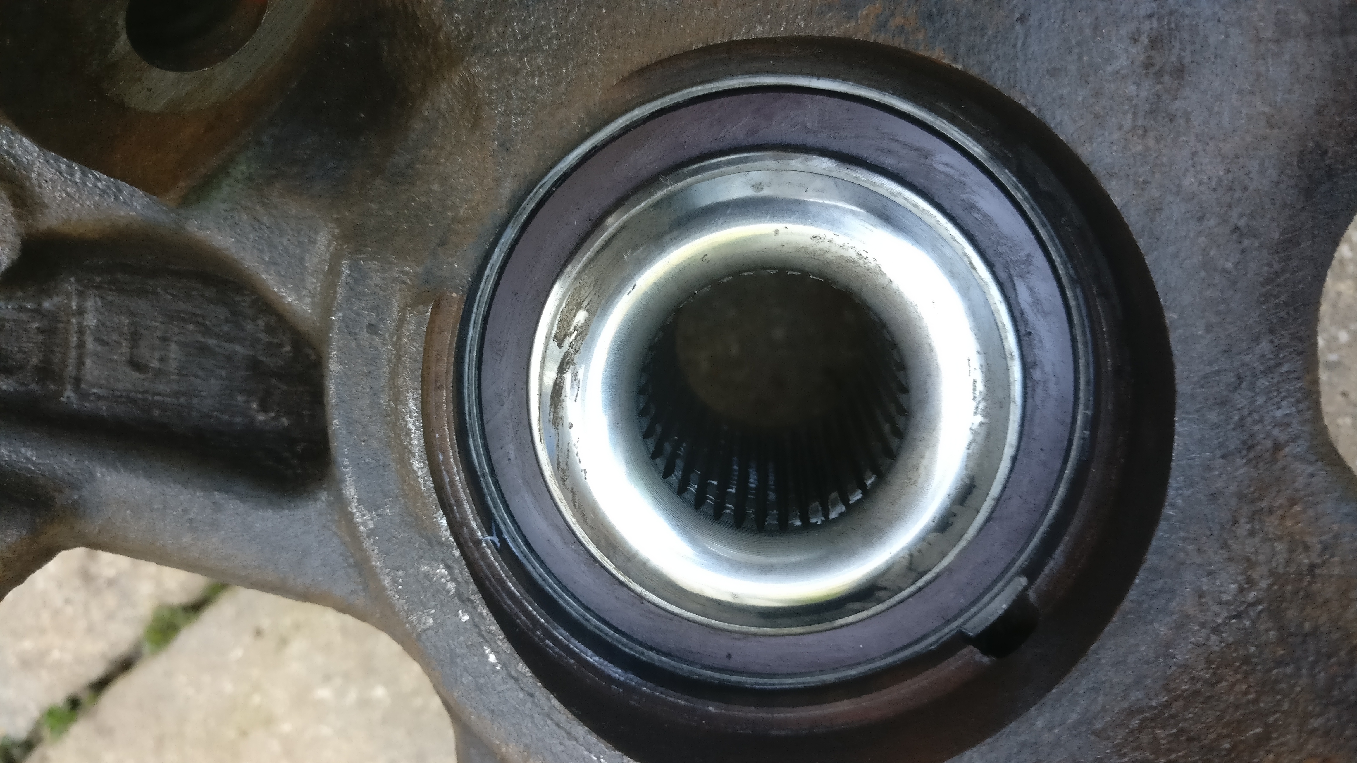

littlepolo
Posts: 836

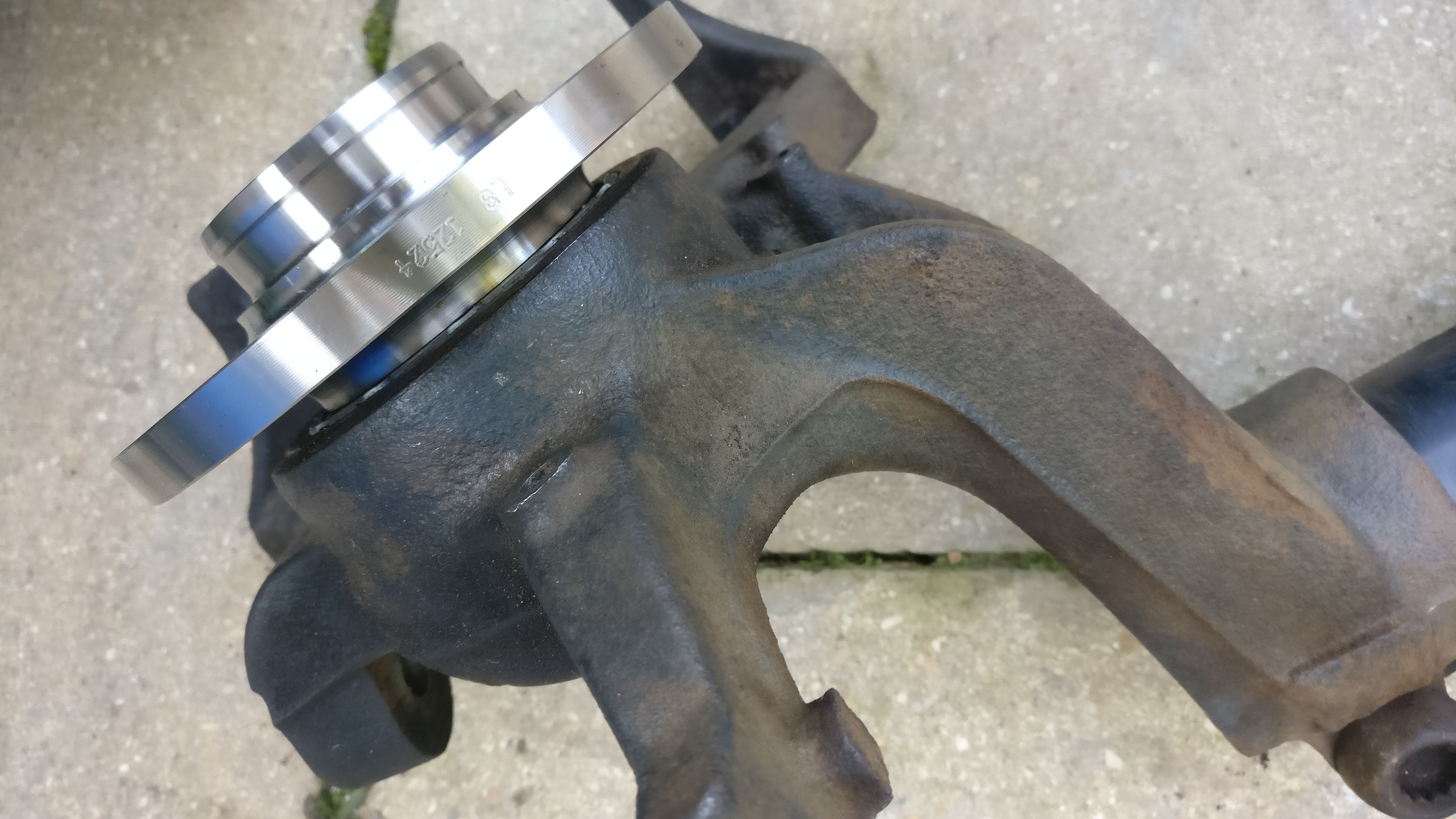

Pressing in the new bearing using the same tool albeit with a different back plate was easy.

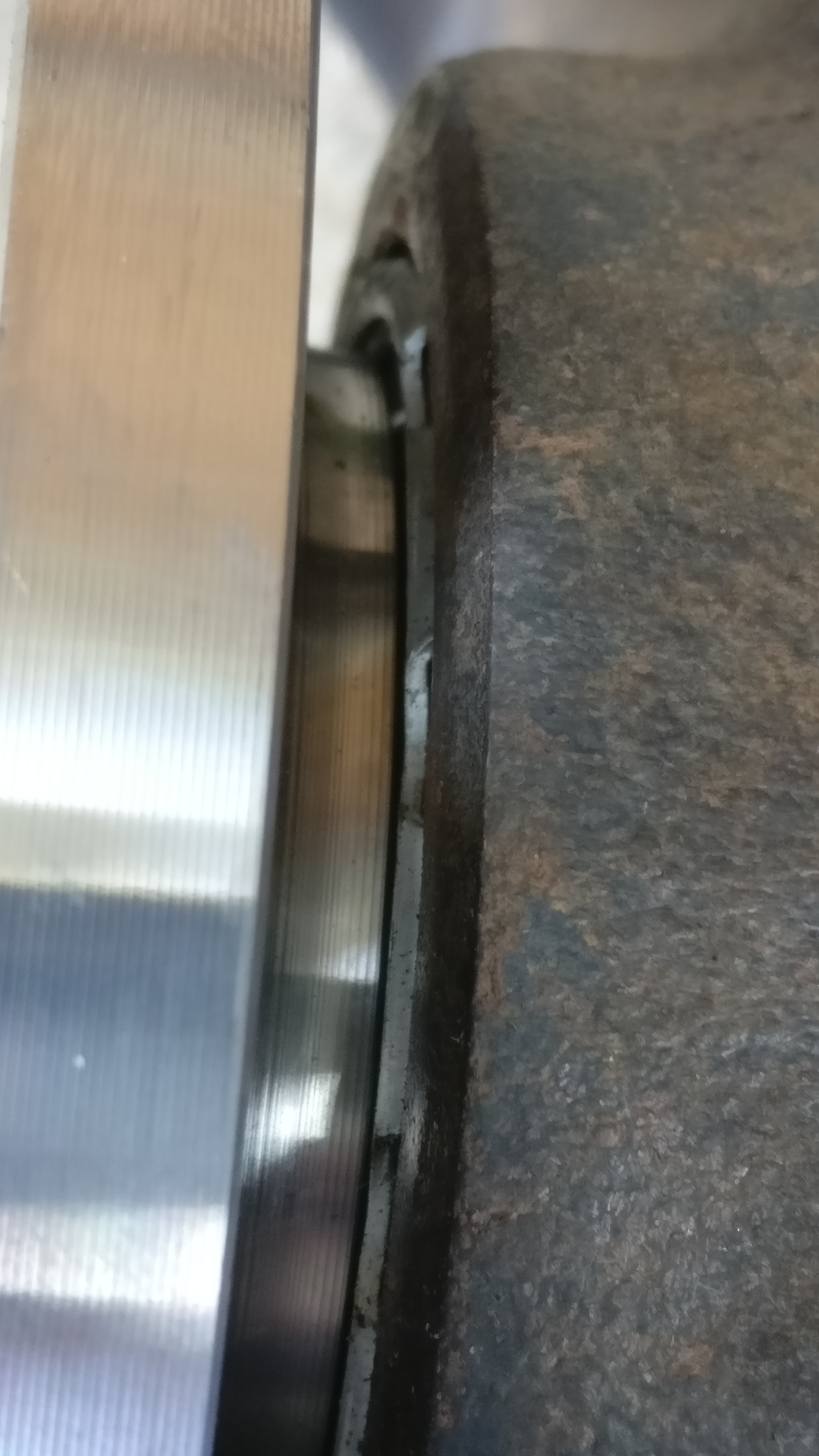

The bearing seems fully seated

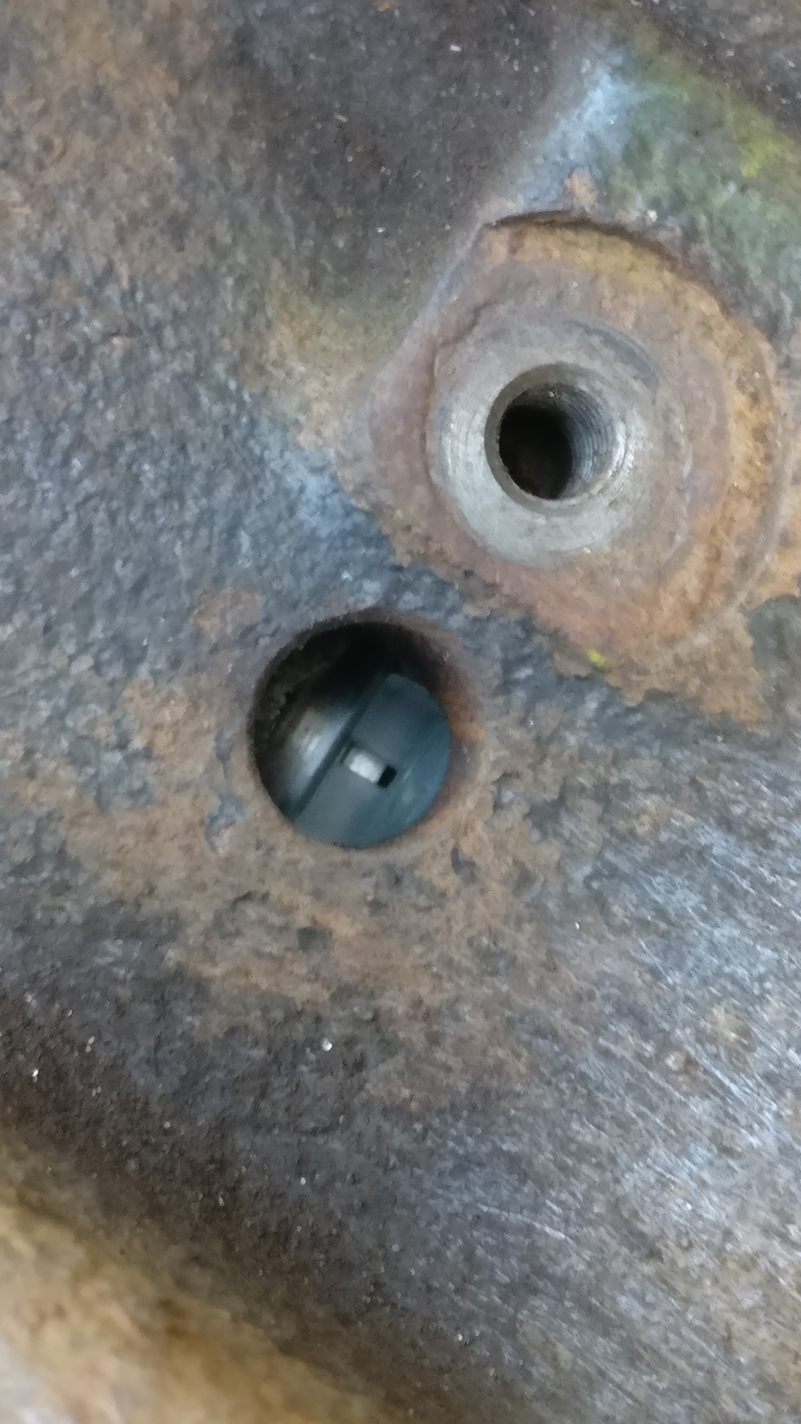

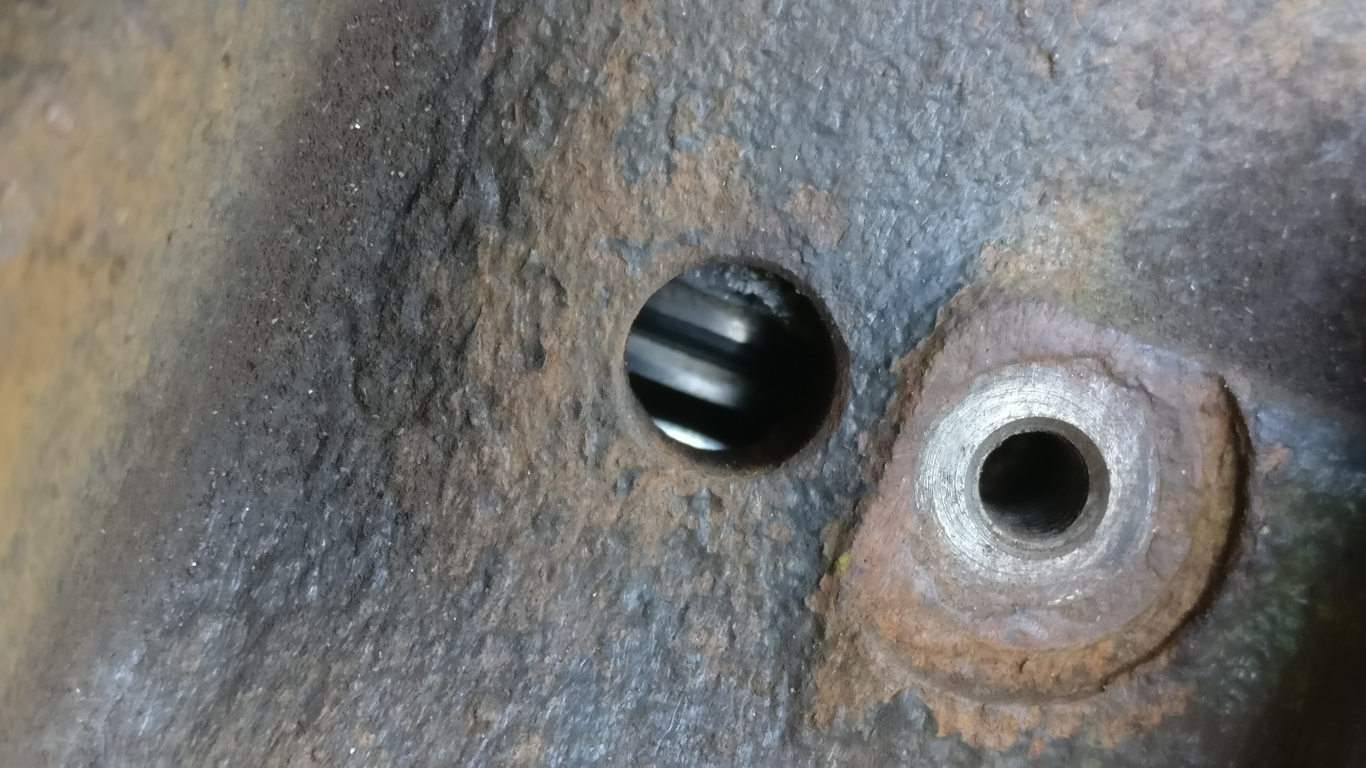

The view through the ABS sensor port.

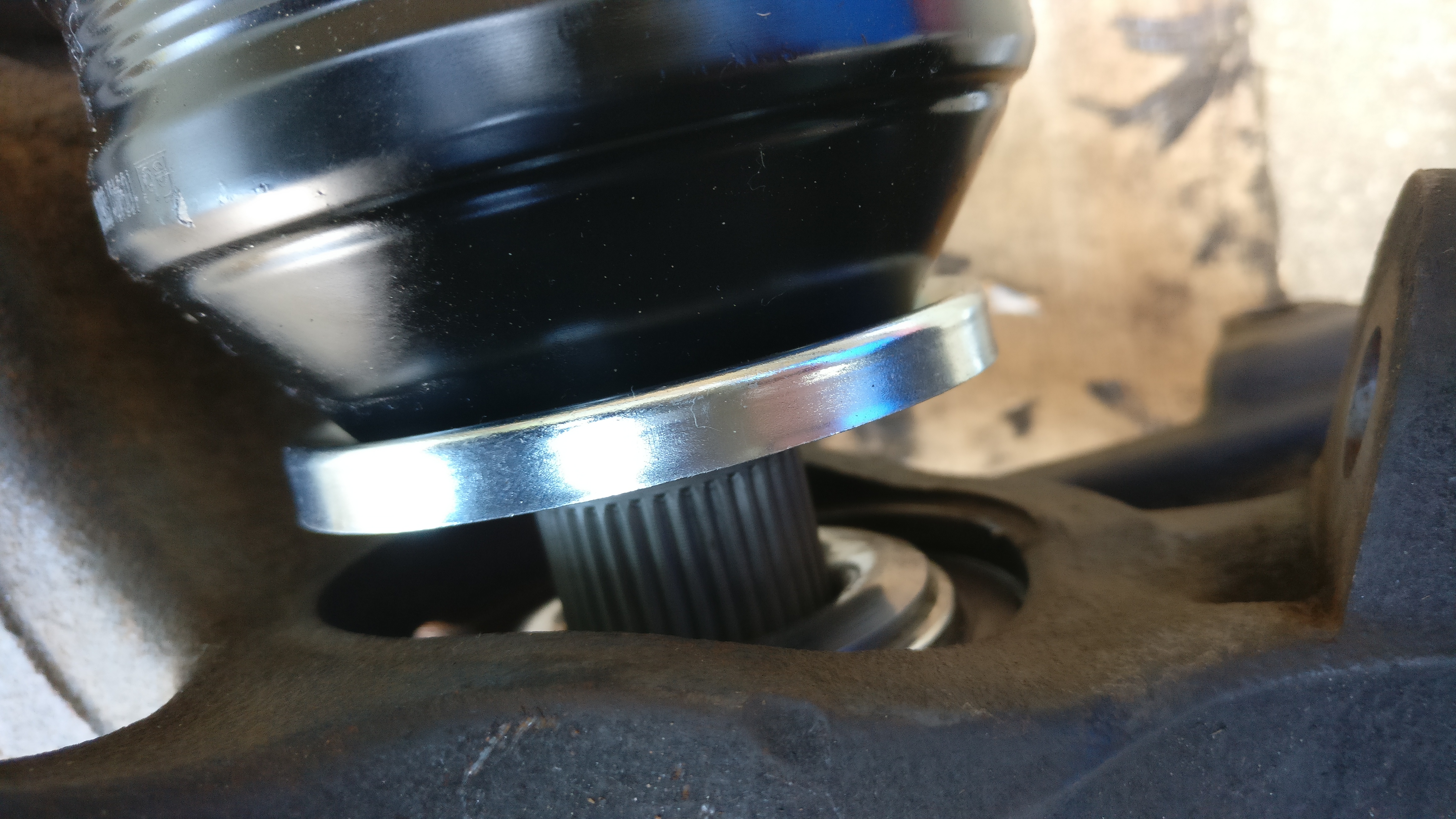

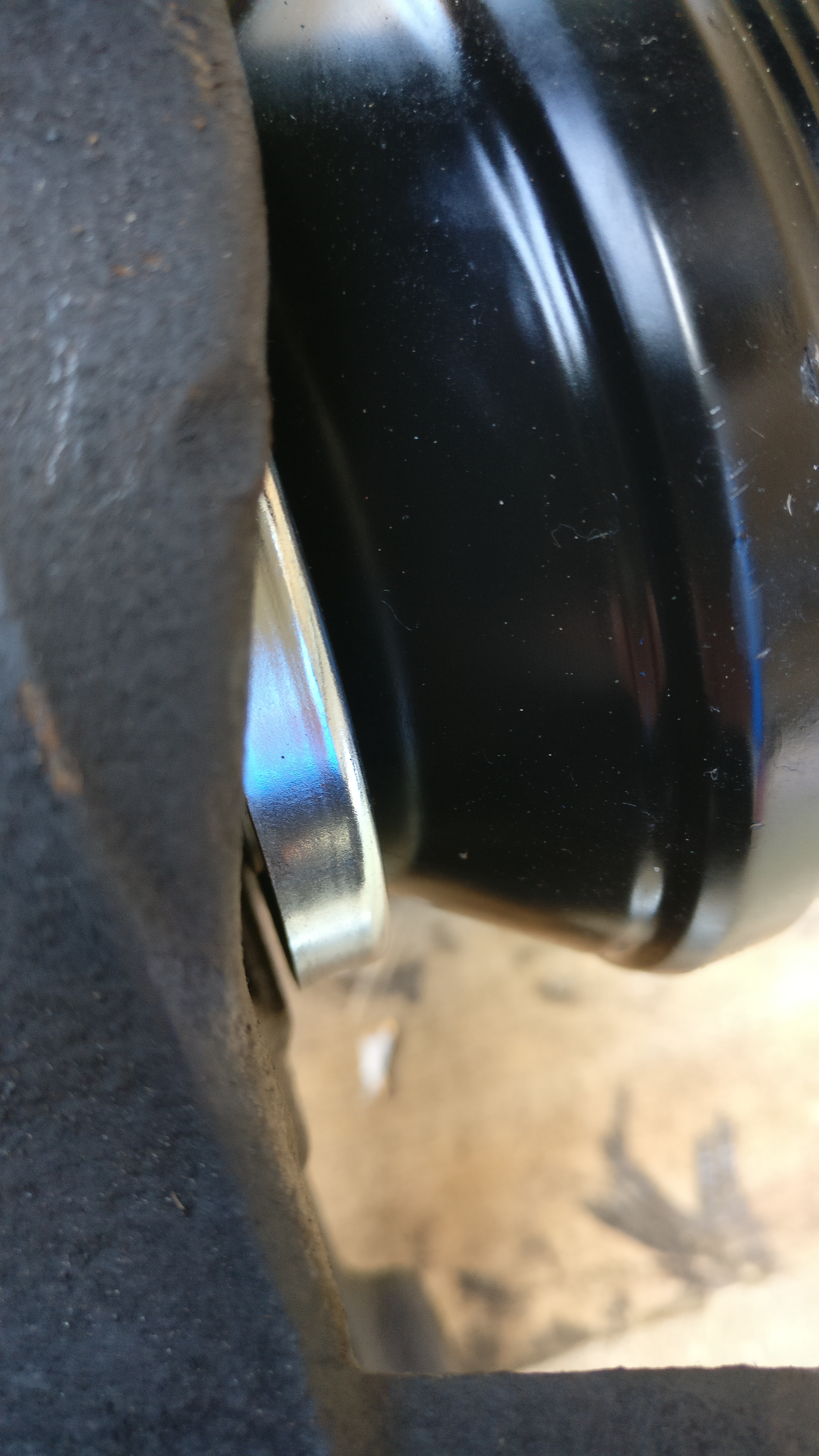

With the ABS reluctor ring fitted position as below. I forgot to check the old one. Does the position look correct?
There is a bit of a gap at the bottom where the stub axle goes into the hub. The part I removed had a plastic ring here (not sure if the gap was fully sealed/closed or not).
