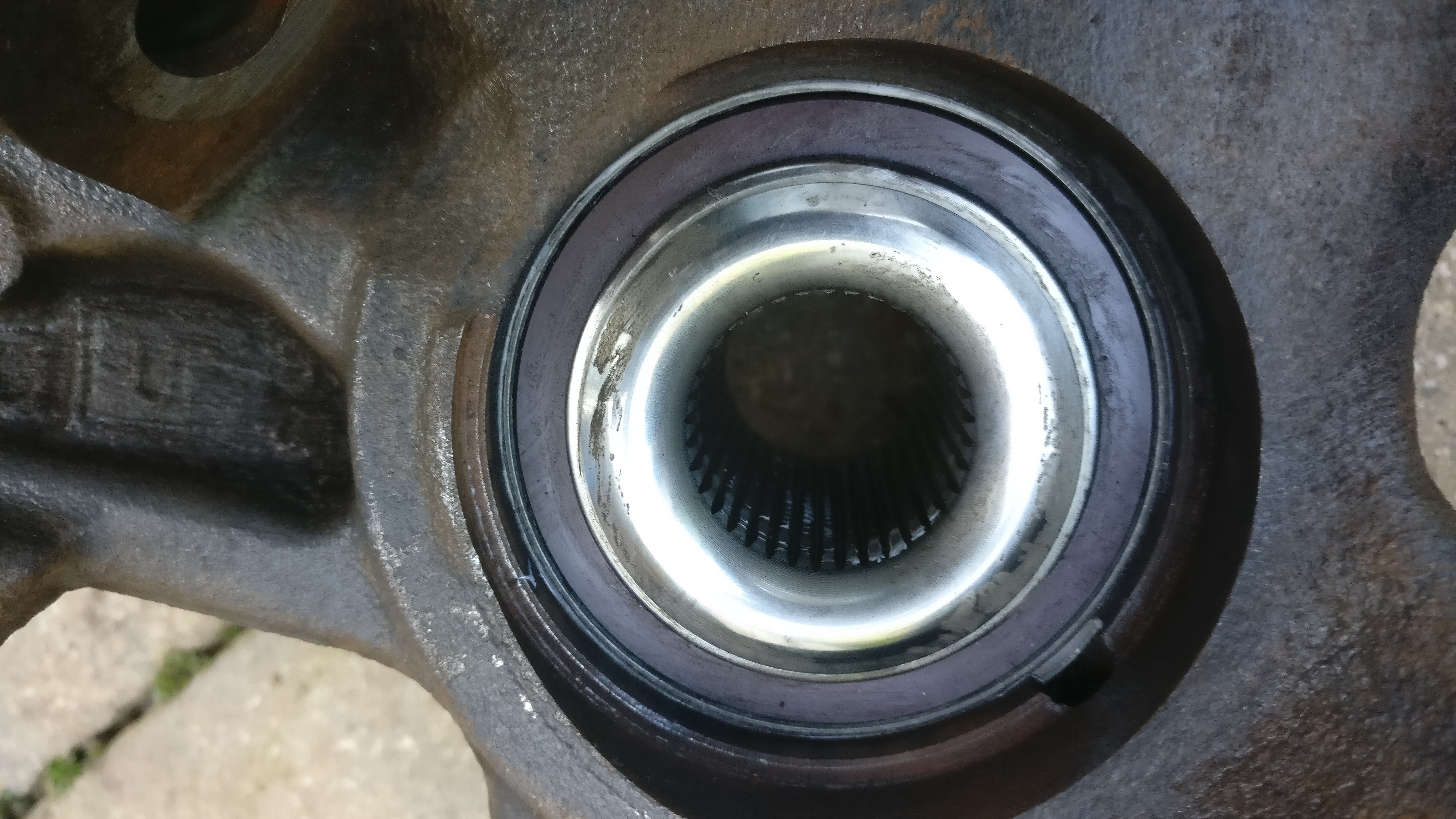

Pressing in the new bearing using the same tool albeit with a different back plate was easy.
The bearing seems fully seated
The view through the ABS sensor port.
With the ABS reluctor ring fitted position as below. I forgot to check the old one. Does the position look correct?
There is a bit of a gap at the bottom where the stub axle goes into the hub. The part I removed had a plastic ring here (not sure if the gap was fully sealed/closed or not).
