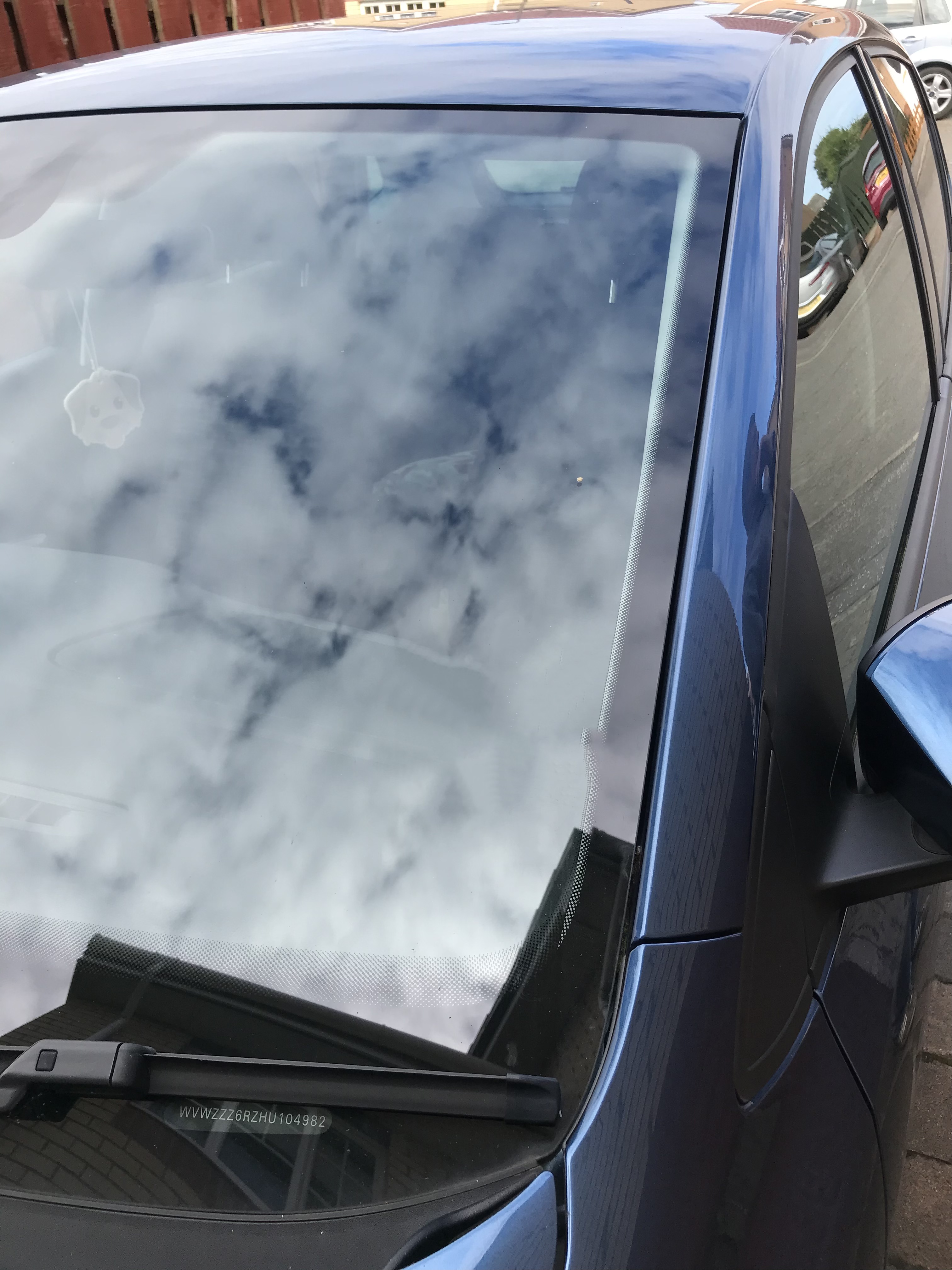

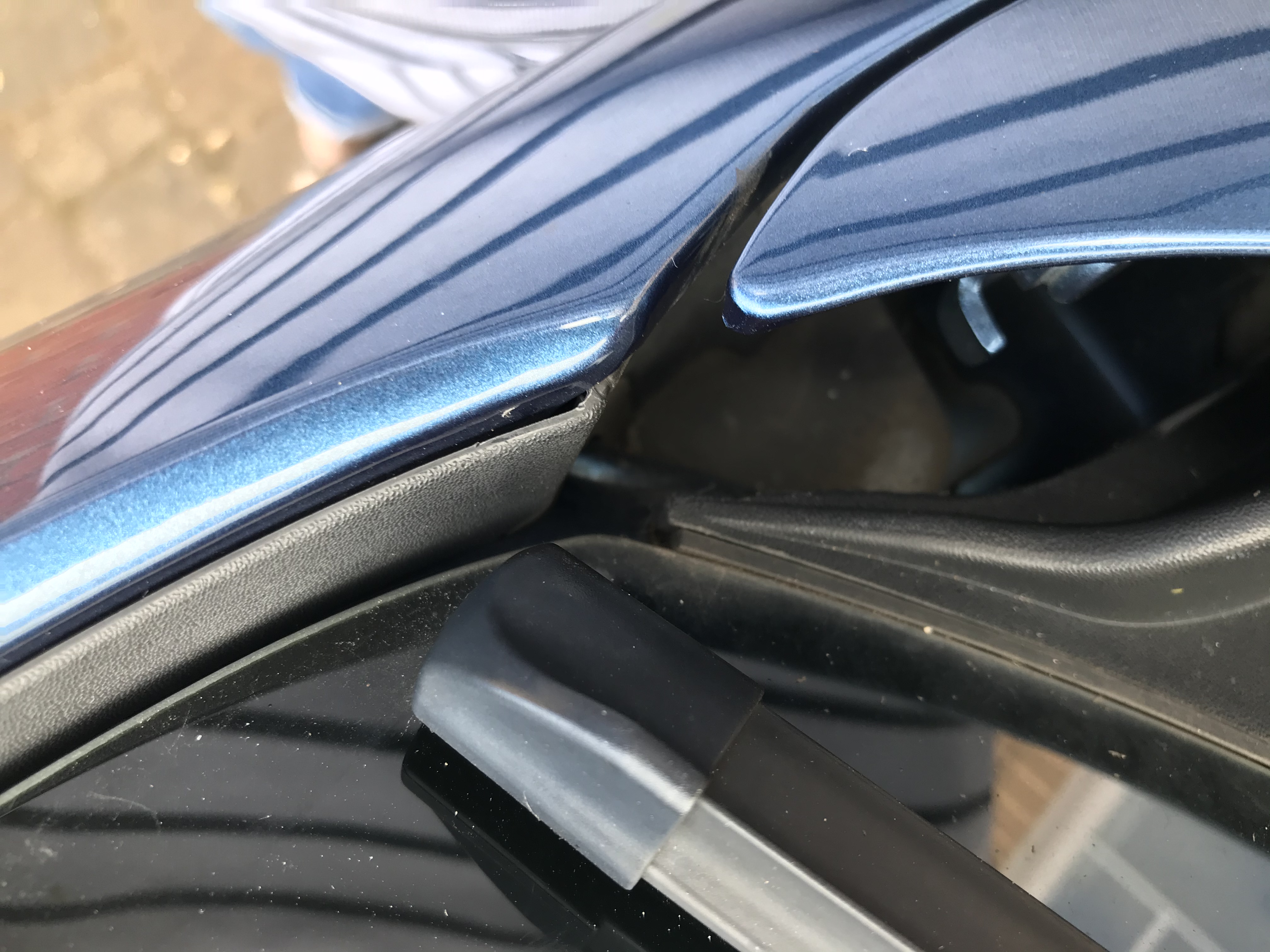

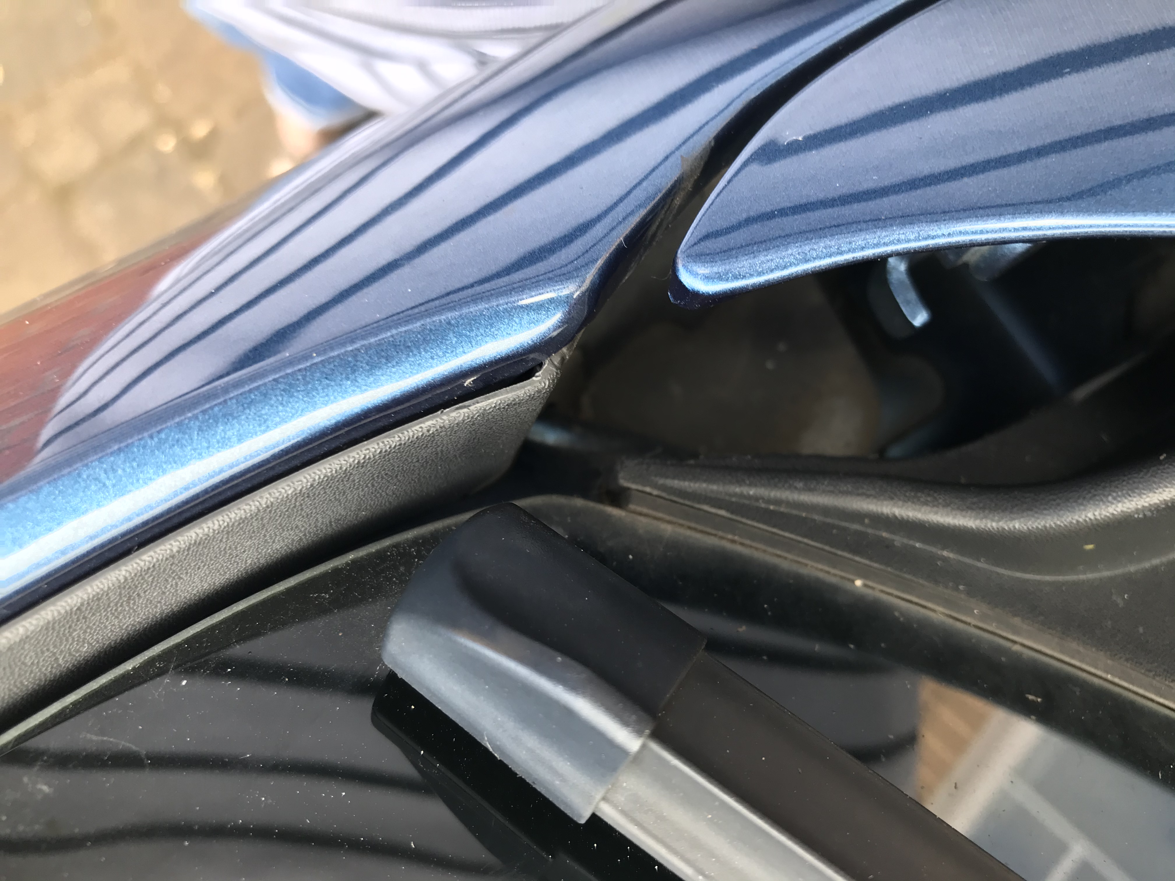

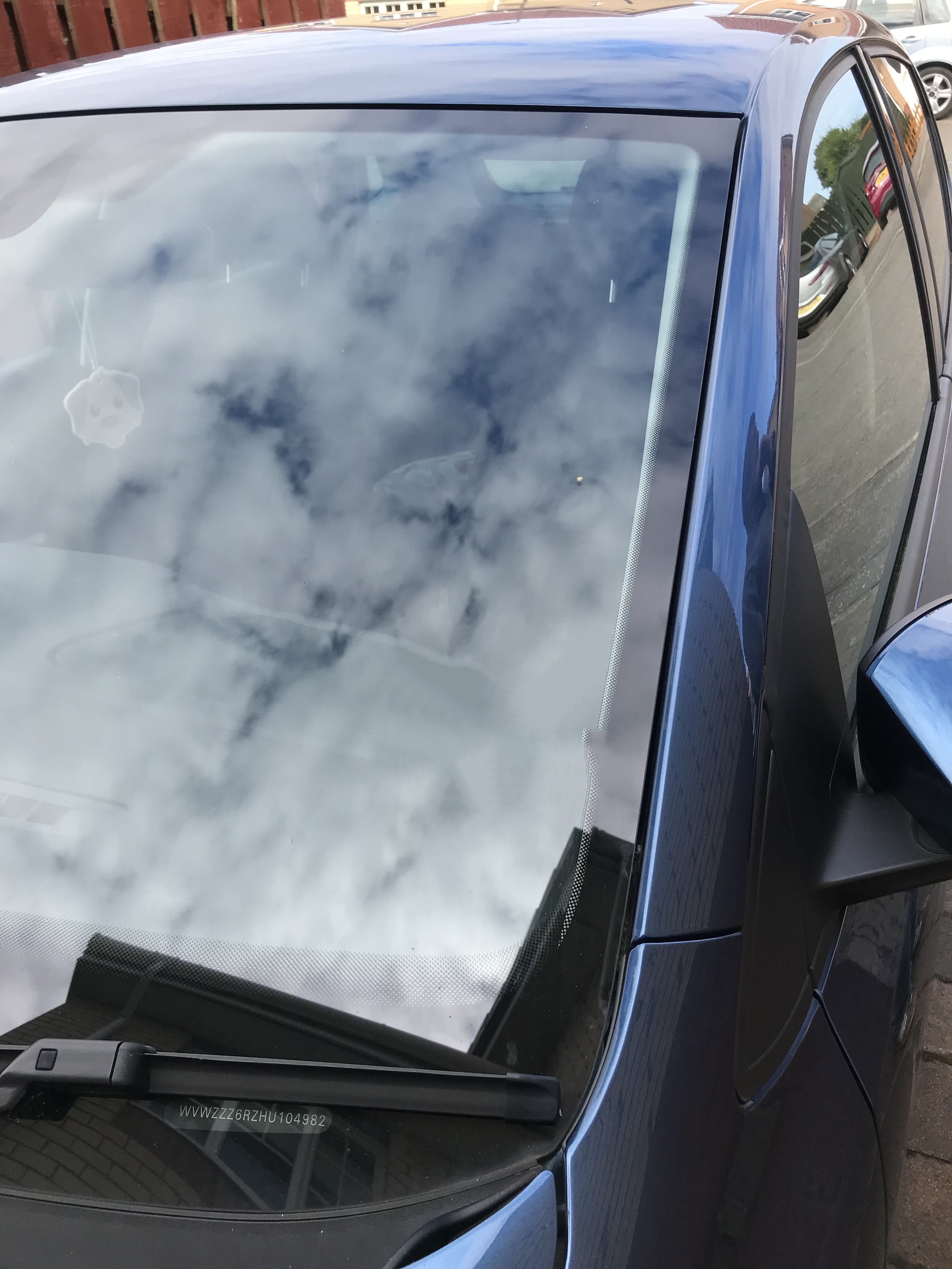

Thanks very much Peter for your PM. I’m unable to PM you as I have just joined the forum.
We don’t know what these things are so attached 2 photos. Are these of any help?
Helen
Helen

If it is a Blue Motion you have, then they all ready have been removed?
Try Google to se how they look like. I can give you the part numbers later if needed.
Left side: 6R0854327A5AP
Right side: 6R0854328A5AP

These are the parts in question, I found lots of pictures of them when googling the part number:Sparkysmum wrote: ↑Mon Aug 31, 2020 1:54 pmI Googled the parts number that were given but unfortunately they didn't appear to return any results - so I'm not quite sure what I'm looking for however the post said that these parts may have been removed already.
It's the black rubber strip that runs along the edges of the windscreen. You see them on all the more expensive models like the Golf and Passat for example, but the only versions of Polo 6R/6C that came with these from the factory are the BlueMotion and BlueGT. I have retrofitted them on my Polo for cosmetic reasons (makes the car look more "finished").

Well, that's a surprise! I didn't think that that was the part being referred to. Unless I misunderstood, RUM4MO had been suggesting that it was the rubber seal around the driver's door that was the likely culprit.
That said, this windscreen seal that you've shown is interesting, because you reckon that this was fitted only on 6C Bluemotion and Blue GT models, and yet my Bluemotion Match 1.2 didn't come with it. Instead, there's a whacking great gap down the windscreen's sides.
I must say, though, that ever since I first took charge of my Polo, the impression I had was that the windscreen rubber seals you normally find on cars these days were missing. The windscreen area therefore looked unfinished and my immediate thought was that the abrupt gapping around the glass would inevitably cause turbulence and wind noise. But since then I've not done sufficient long journeys, particularly motorway journeys, to test for that. I think I checked at one stage with RUM4MO, via a PM, whether there should be rubber sealing all round the windscreen, and he replied no; his wife drives a 2015 Polo 1.2 SEL. I therefore assumed that mine, a 2017 Polo Match 1.2, shouldn't have them either.
A look at the appropriate engineering drawing on the nemiga or ifinterface website might give some insight into this, and if the part is shown there should be an actual part no.given.
Is there provision for a seal to be fitted across the top of the windscreen as well (the gap there being much smaller but nonetheless abrupt)? And BTW, does the seal at the windscreen's side extend on to the roof?
I notice that on these later Polos there's no guttering as such, and consequently you find that, unless you keep the windows shut, rainwater (especially massed droplets left on the roof after rain has abated) pours off the roof and into both your lap and the window- switches! Hence my query about whether the side-seal extends on to the roof, to become guttering (that's to say, a means to stop rainwater from just pouring down the sides of the vehicle).

However what I’m hearing is that the non existence of the rubber thingy along the edge of the windscreen leaves a gaping big gap which probably causes wind turbulence and this awful rushing wind noise when I’m driving at 50+mph?!!
And therefore there’s no solution?
