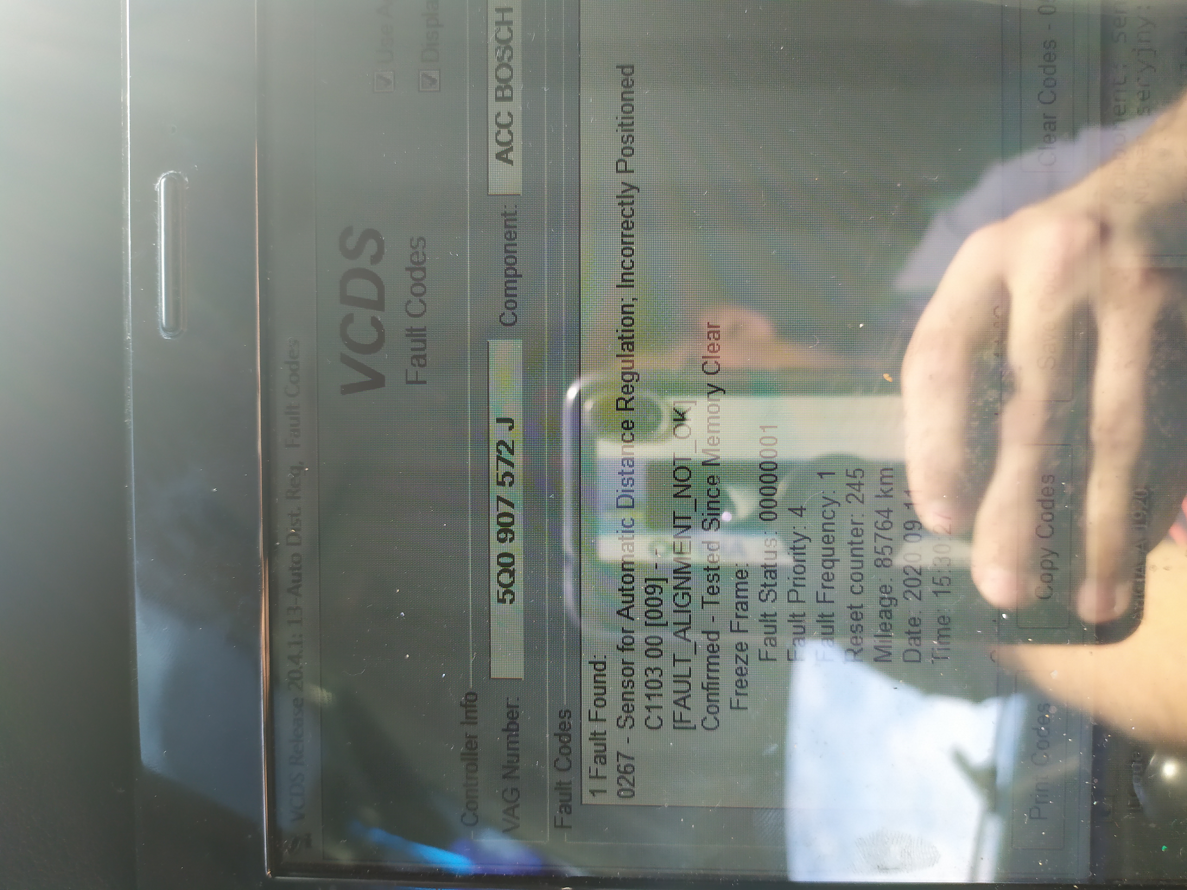

Can anyone help me?

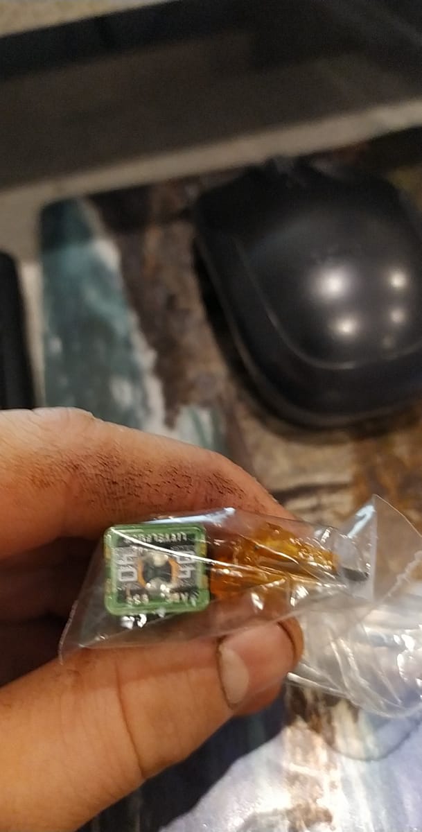

Today I installed the blind spot assistant, disconnected the battery, connected the assistant, took the first scan:
Friday,11,September,2020,14:47:24:12281

Address 13: Auto Dist. Reg (J428)       Labels:| 3Q0-907-572.clb
   Part No SW: 5Q0 907 572 J    HW: 3QF 907 572
   Component: ACC BOSCH MQB H10 0654
   Coding: 2B00600159FFC728949C810560400600000000000000000000
   Shop #: WSC 01357 011 00200
   ASAM Dataset: EV_ACCBOSCHVW416 002006
   ROD: EV_ACCBOSCHVW416_002_VW37.rod
   VCID: 3E253BD560F54A6B617-806A
4 Faults Found:
0267 - Sensor for Automatic Distance Regulation; Incorrectly Positioned
          C1103 00 [009] - -
          [FAULT_ALIGNMENT_NOT_OK]
                    Fault Status: 00000001
                    Fault Priority: 4
                    Fault Frequency: 1
                    Reset counter: 245
                    Mileage: 85764 km
                    Date: 2020.09.11
                    Time: 14:38:42

1 Fault Found:
19204 - Databus
          U1123 00 [009] - Received Error Message
          [ESP_02 Botschaft - SNA_Check]
                    Fault Priority: 6
                    Reset counter: 245
                    Mileage: 85764 km
                    Date: 2020.09.11
                    Time: 14:37:32
                    Motor status: 01
                    System status: Driving mode
                    Supply voltage: 13.75 V
                    Temperature: 64.0 °C
                    KFC: 4B
                    KFA: 00 04
                    Environmental conditions: 7F
                    uAdSensI_U1V2Filtered_gdu16: 1.20 V

Re: GOLF 7.5 FL R-LINE
I'd suggest to do a basic setting of the steering angle sensor and ESP unit and see what happens. Take it for a drive.
Posts: 8968
iichel wrote: Fri Sep 11, 2020 3:29 pm I'd suggest to do a basic setting of the steering angle sensor and ESP unit and see what happens. Take it for a drive.
As you are on the ross-tech forum you should be cautious with the suggestions regarding the MQB platform.
Not everyone does things the same way, and it may be that it creates a bigger problem than is already present.
It's just a friend recommendation. :wink:

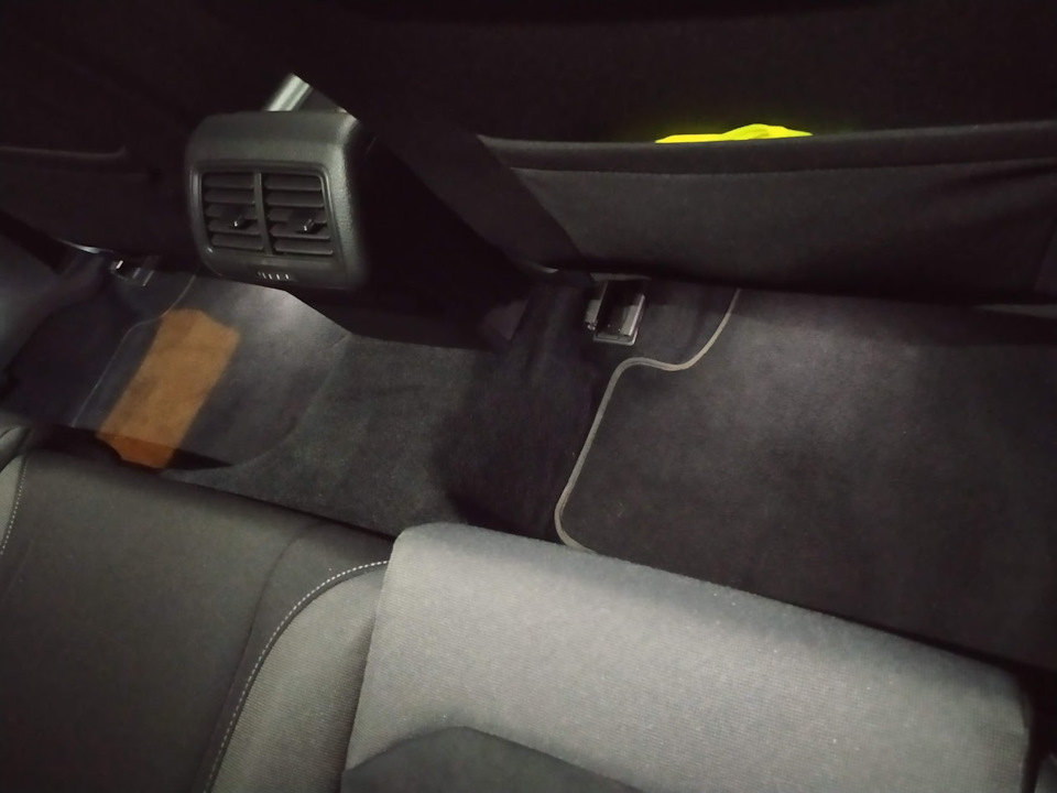

rear leg lighting
2x 5G0947409
2x 3B0972712
4x 1J0971972

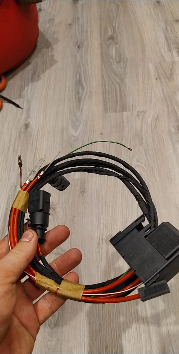

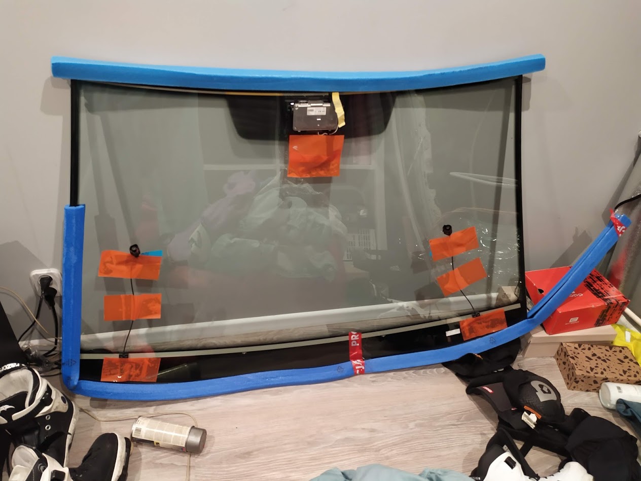

Waiting for the wiring harness for the windshield.
camera calibration only by odis?
greetings :D

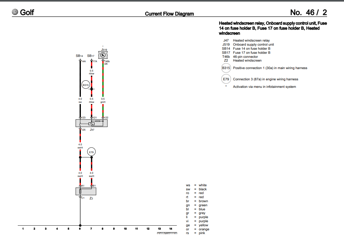

Cable harness for heated glass is already installed :D :DI have to finish the wiring harness for the a5 camera but heated windshield first :D Tomorrow, maybe I will have the opportunity to find out if the department
:P
