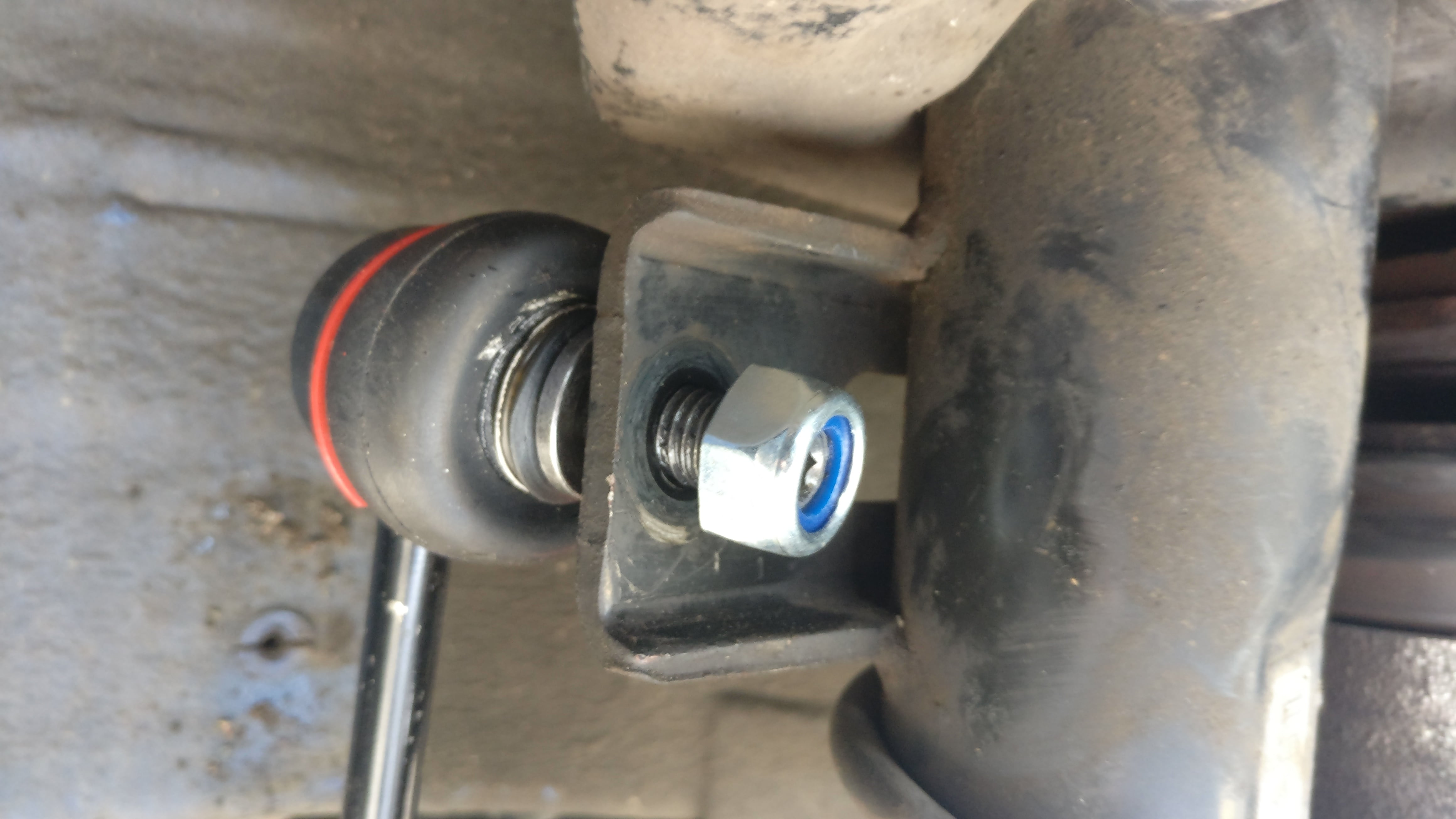

This is the Febi part. The car is on a stand on the n/s. Does that explain why the rod seems too long and won't fit in?
- Posts: 6079
Re: FEBI 19518 Front Anti Roll Bar Link Rod
To make a judgement on that you would need to have both sides either up on stands or both sides down on its wheels - doing it that way would let you see if it fitted into the ARB end without you needing to flex the ARB.

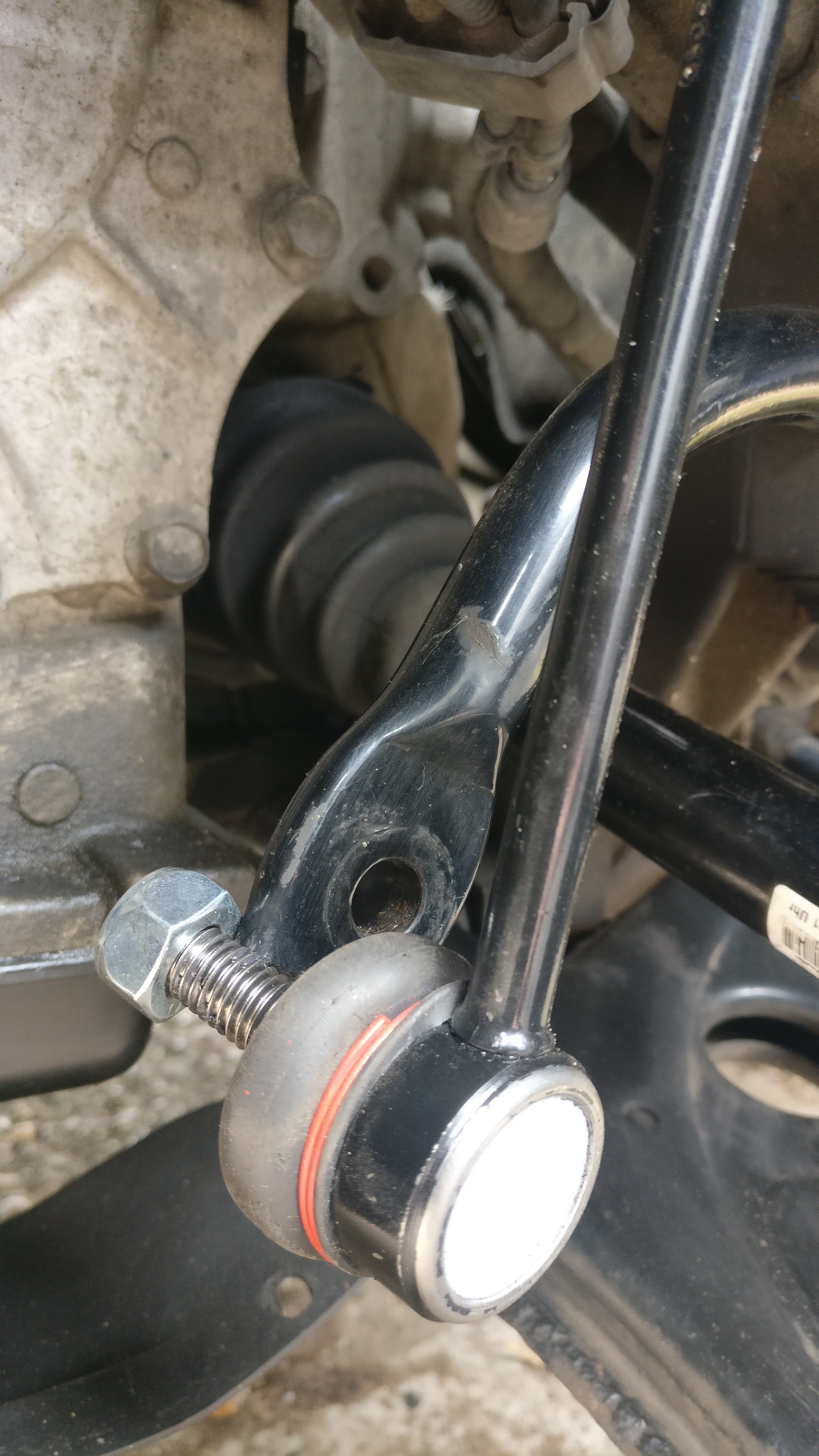

littlepolo
- Posts: 836
Started to jack of the o/s and the anti roll bar came within reach. Those links must take quite a bashing.
