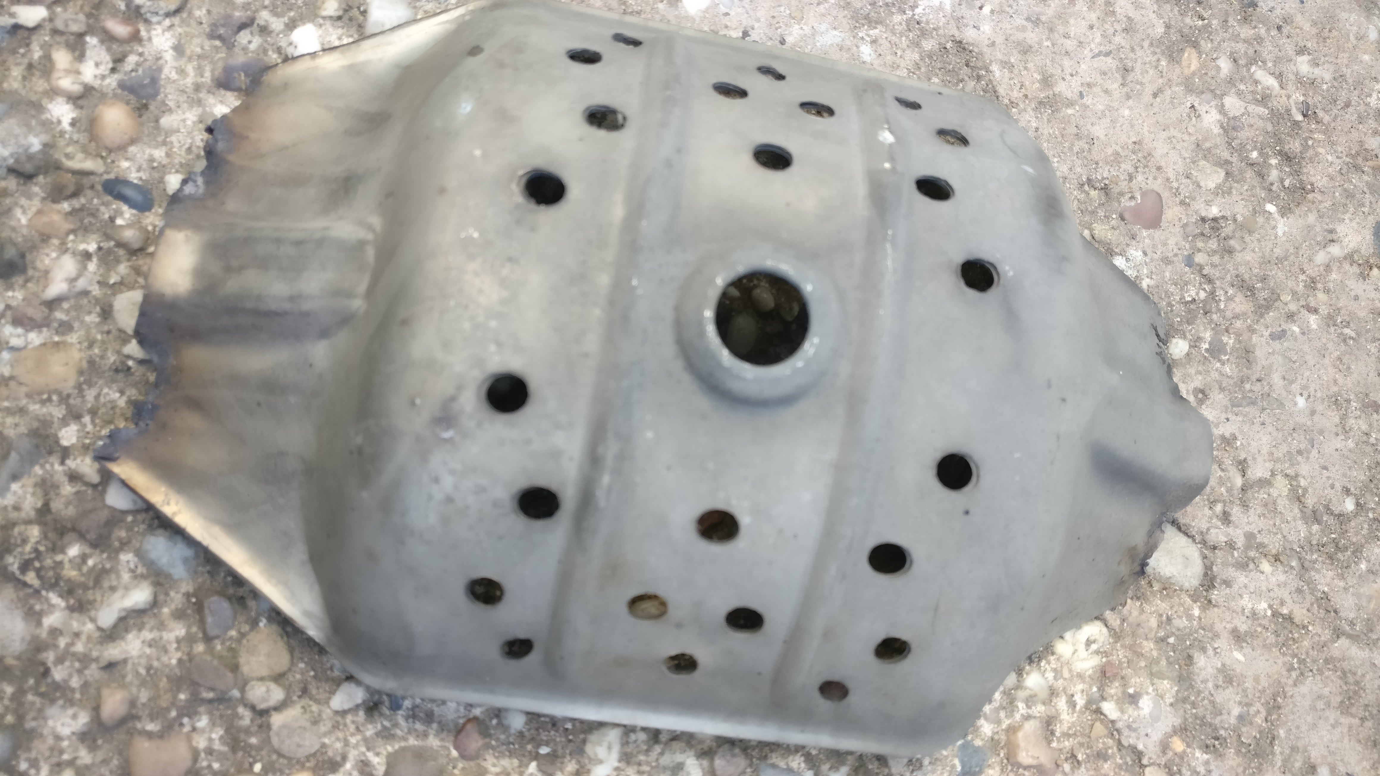

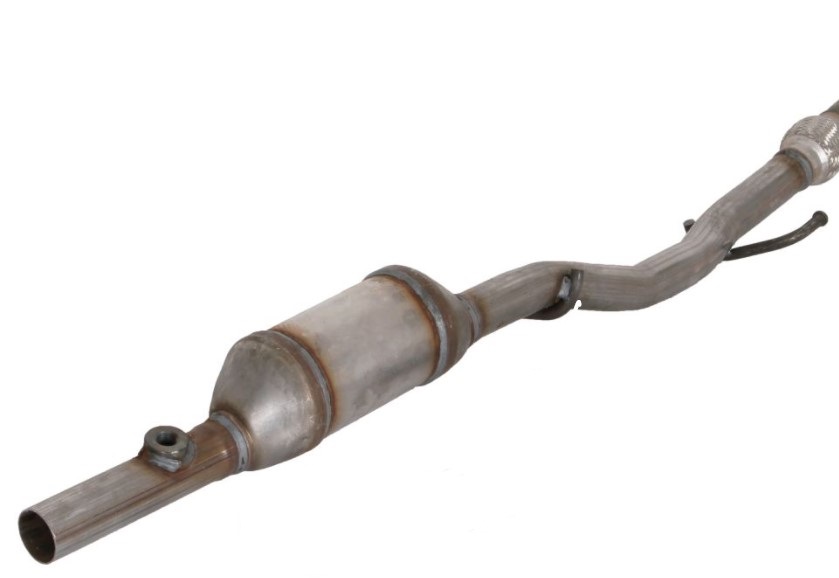

While I was driving a few months ago I heard the sound of something hitting metal. I stopped at the roadside and found what looks like a heat shield/guard of a cat. When I later looked under the vehicle, cat is just a smooth metal casing as per photo below.
I'm wondering if the heat shield/guard fell off the Polo or if I just drove over one that had fallen onto the road.
Is a heat shield/guard fitted to the Polo underbody cat?

I seem to remember that VW Group cars tend to have heat shielding fitted to the bodywork - in the early days cars tended to have a heat shield on the cat though.
So, which cat is on the way out, at a guess I'd think that it would be the manucat, ie the first one that forms part of the manifold, but that is purely a guess, other than checking the running temperature on the casing, I'm not sure that anyone could point out which cat was underperforming - though you would need to have a reliable figure for the running temperature of both when working correctly at a known ambient temperature etc.

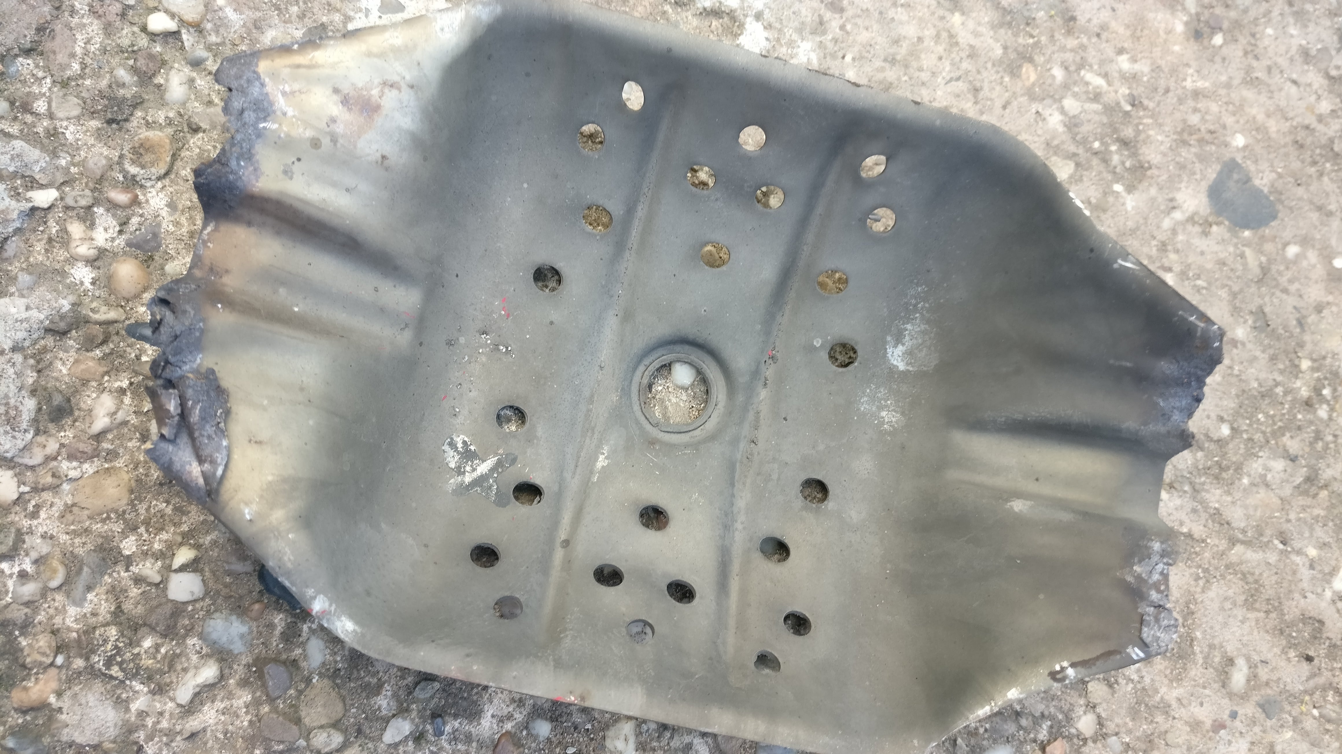

Do these look familiar?
Would a missing shield be an MOT fail?
