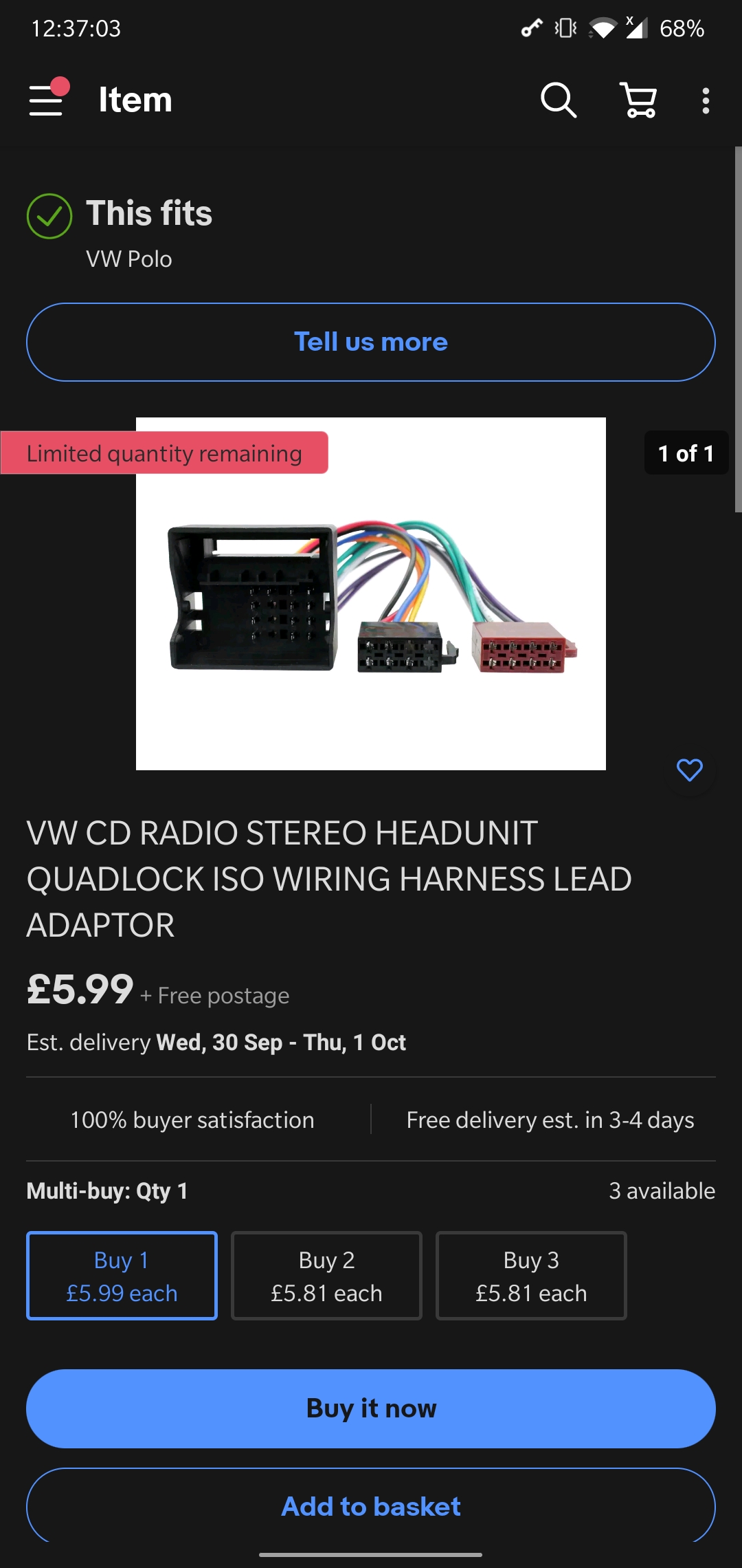

So I wouldn't be able to use this adapter and then plug the radio cables into this?Image
Bepis
Posts: 332
Drives: 2017 6C GTi Manual
Location: North West
Re: Radio help
Post by Bepis »
If you were to use that adapter you would still have to get an ISO to DIN adapter which is normal and your radio may come with one like mine did but you would need to get switched power from the cigarette lighter by splicing into it.
Then you would need a powered FAKRA to DIN aerial adapter which you also need to supply with power. On my radio, there is a 12v feed that comes out of the radio which is a blue wire labelled "power antenna" I imagine the DIN connectors are fairly standard so you would use that to power the aerial.
If the adapter is wired correctly and the two things mentioned above are taken care of then I don't see why it wouldn't work.
