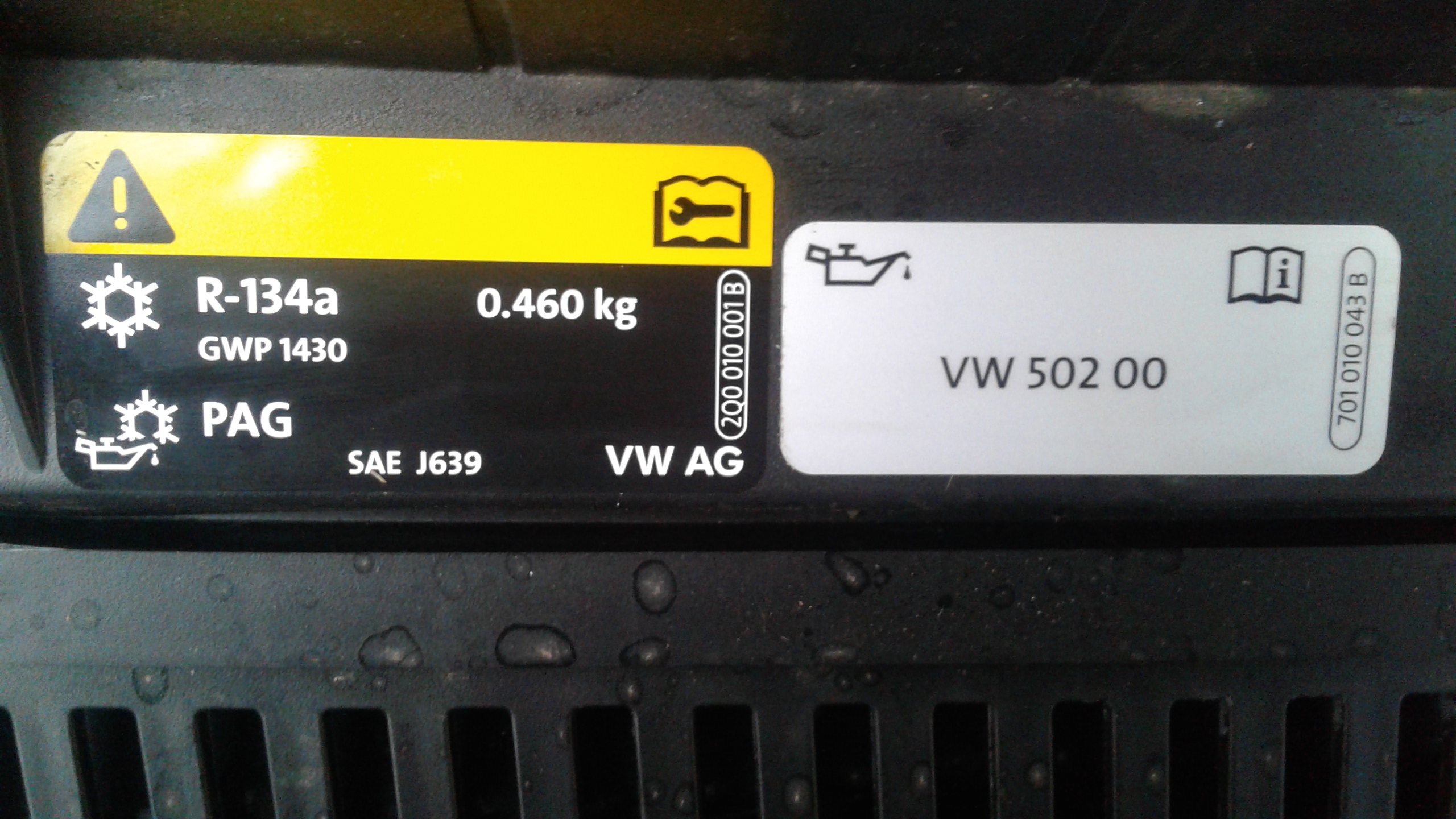

To pick the correct engine oil for your car, you should be looking at what is the approved VW specification engine oil for your car's engine.
If you open the bonnet and look at the front section of the engine bay, you should see a grey label.
For my Polo the correct engine oil specification is VW 502 00, as shown in the photo below.
My Polo have the 1.6 MPi petrol engine, with engine code: CWVB.
But your Polo GTi have a different engine, so your engine could require a different engine oil specification.
Once we know the engine oil specification, we can go buy engine oil which is approved by VW under that specification.
For example, within the VW 502 00 specification there could be more than one viscosity, from what I know there are 10W40, 5W30 & 5W40 etc...
So, pick the viscosity which suit the climate pattern at where you live.
The main idea is the engine oil need to be approved by VW under the specification which fit your car's engine.

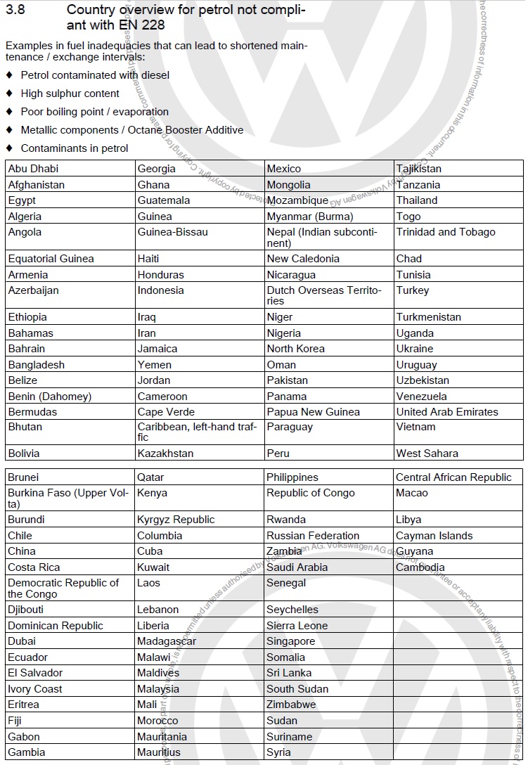

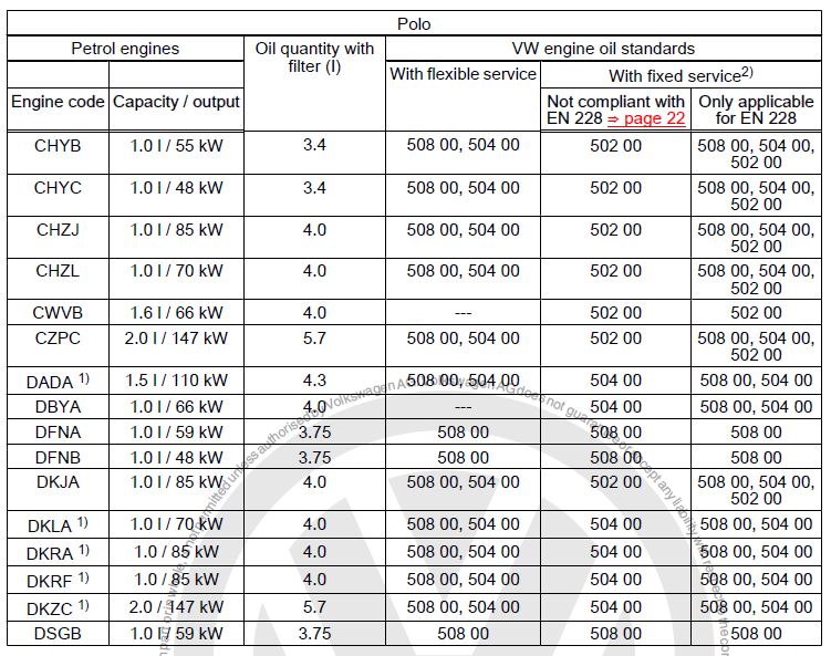

Alternatively, if you know your engine code, you can look at the chart below:
Below is a list of country which is not compliant with EN 228 standard, FYI:
