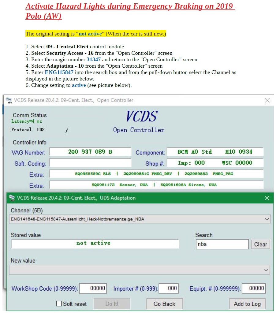

"Automatic Hazard Lights Activation during Emergency Braking" - Enable this function using VCDS
ho8882000
Posts: 158
Drives: 2019 (AW)
Location: South Africa
Post by ho8882000 »
Enable the "Automatic Hazard Lights Activation during Emergency Braking" function using VCDS, the method is shown below:

I'm almost 100% sure here in the UK this is a standard feature and has to be coded to a new vehicle as standard so UK Polos should have this anyway.
Posts: 3847
Re: "Automatic Hazard Lights Activation during Emergency Braking" - Enable this function using VCDS
Stuart_Rendall wrote: Wed Oct 14, 2020 10:41 pm I'm almost 100% sure here in the UK this is a standard feature and has to be coded to a new vehicle as standard so UK Polos should have this anyway.
You’re correct Stuart, it does seem to be a standard feature on UK Polos; page 62 of the owner’s manual or if accessing the online version of the manual on www.Volkswagen.co.uk it’s under Safety -> In an emergency -> Making you and your vehicle safe;
Depending on the vehicle equipment, the brake lights flash rapidly if you brake sharply or initiate full braking at a speed of more than 80 km/h (50 mph). This provides an especially conspicuous warning for the following traffic. If you then continue to brake, the hazard warning lights will be switched on automatically at speeds under approximately 10 km/h (6 mph). Once the vehicle starts to accelerate, the hazard warning lights will switch off again.

SRGTD wrote: Wed Oct 14, 2020 10:52 pm
"Depending on the vehicle equipment"

I'm sure my GTI here in ZAR has this feature already to be honest.
