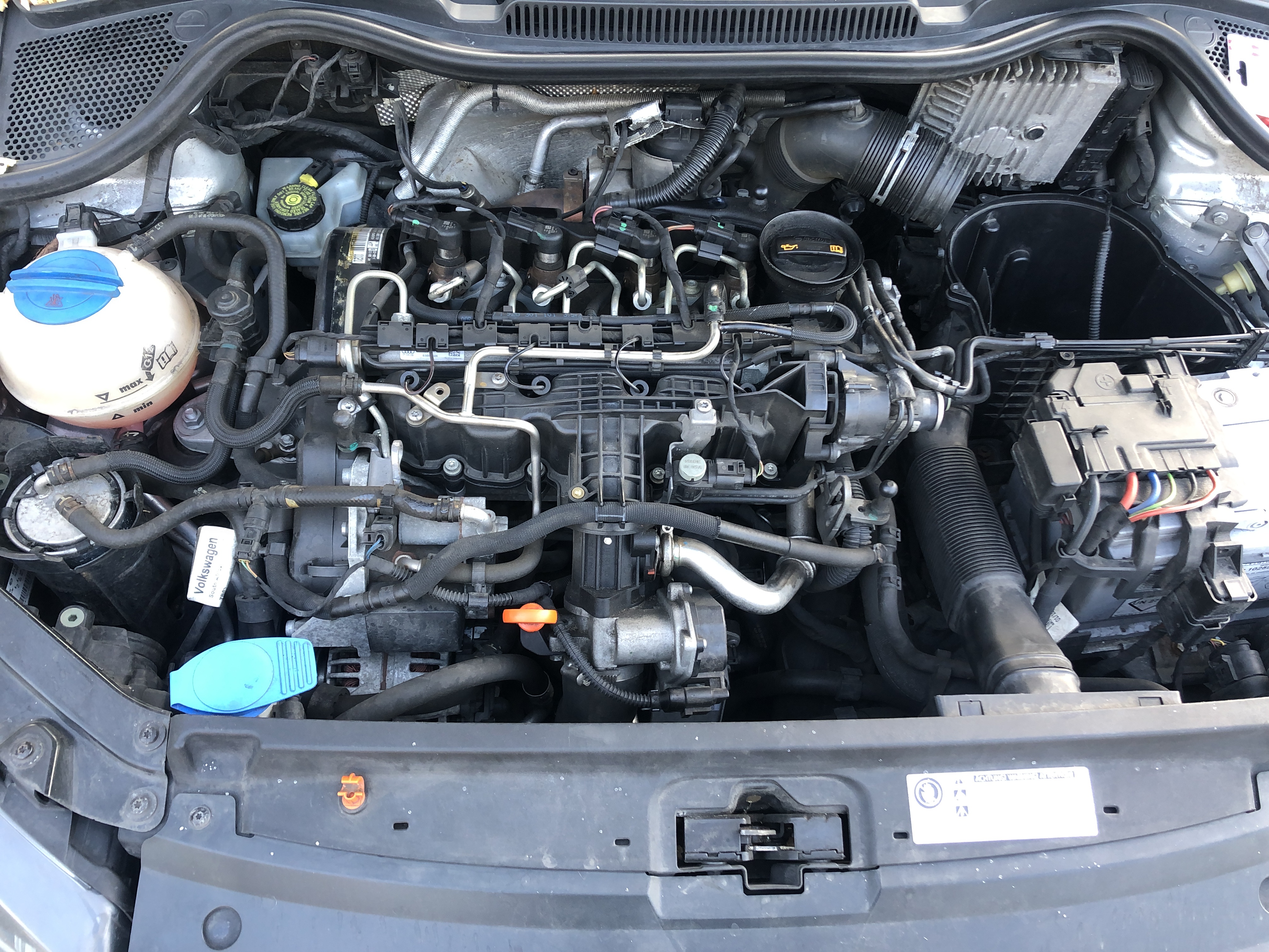

I can’t see any leaks no cracks in the air filter box or pipes anywhere, I’m starting to think maybe map as I sometimes have odd idles and sometimes hesitation when pulling away especially in 3rd gear. Anyone know where to locate map sensor on a 6r 1.6 tdi

I have noticed my g12 coolant seems to be dropping quite quick.. Any idea on what this could be? Also where would I find the map sensor
