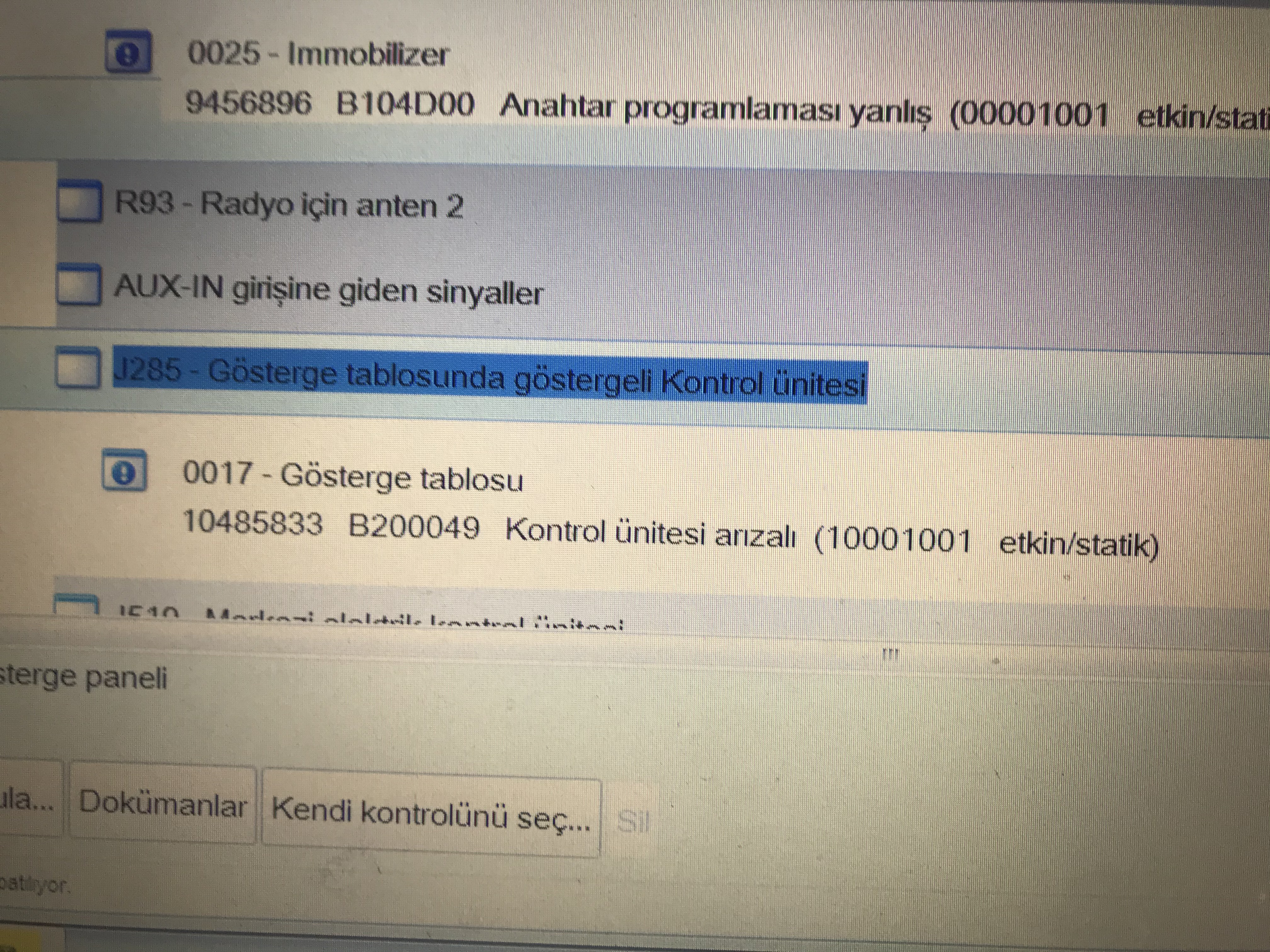

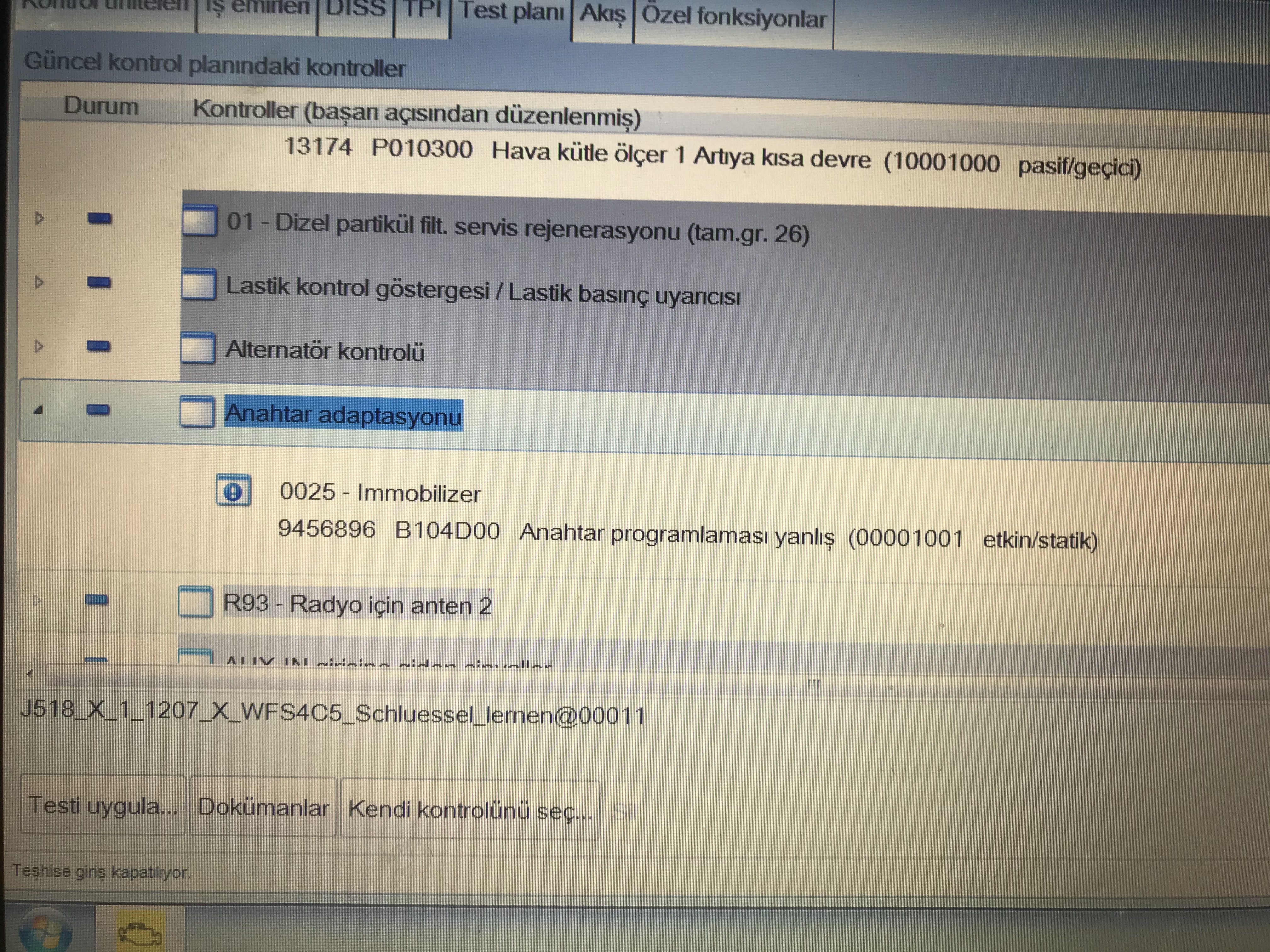

Post by gorkem »
Translation :
J285 - Instrument Cluster - Instrument Cluster Unit
0017 - Instrument cluster
10485833 B200049 Control module faulty (10001001 active/static)
Translation :
Key Adaptation
0025 - Immobilizer
9456896 B104D00 Incorrect key programming (00001001 active/static)
So these are the errors.
Re: 6R IMPOSSIBLE IMMO PROBLEM
Your eeprom memory on cluster is f****d up
Remove eeprom, set in soip clip than find flash on net reflash, set it back. And try it again
Checksum doesnt match up, someone f. Up
If you google "10485833 B200049" you will see that is a Hex Sum error in the cluster. There is a chip called Eeprom on cluster that stores hex memory. You eletrician should find a eeprom dump for your cluster and reflash it, and than try to pair the keys to cluster.
I think thats why its rejecting the key programming.
