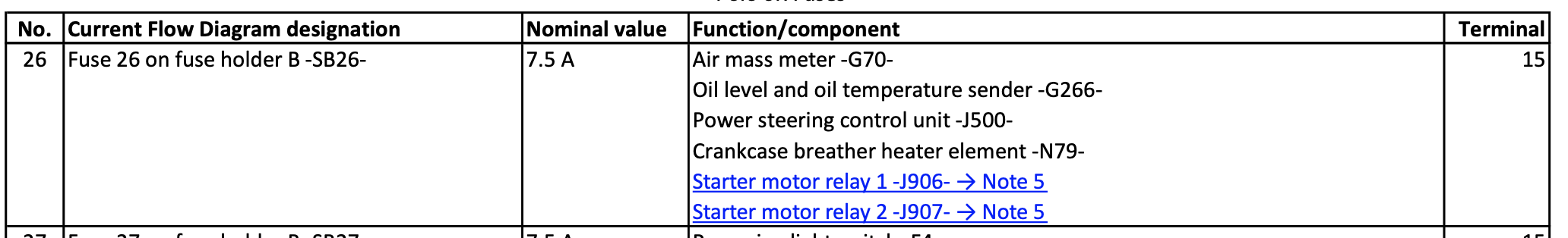

Re: Fuse 26 Blowing, Need help!
So this are the relays powered by fuse 26.
The starter relays are placed in the bottom row of the relay carrier, second and third one from the left.

So... now you remove all other devices in that list to see what's going on.
Air mass meter is the easiest, that's located right next to the air filter. Next the power steering unit which is a lot harder to reach and next up are the other two (even though I think your TDI doesn't have the crankcase heater element)
