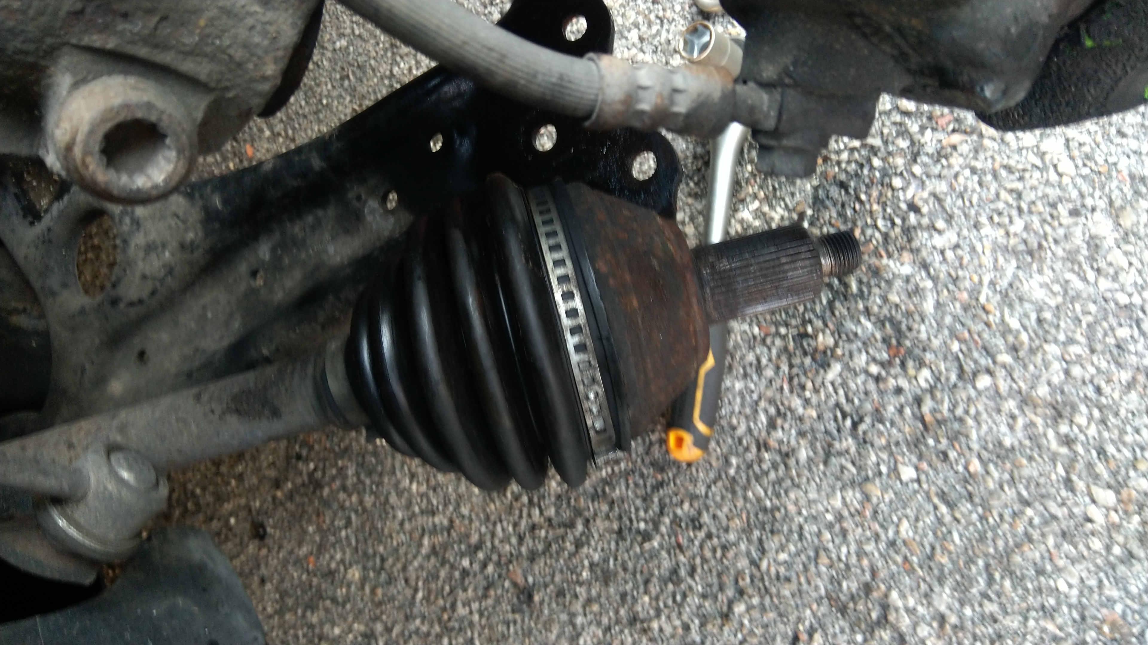

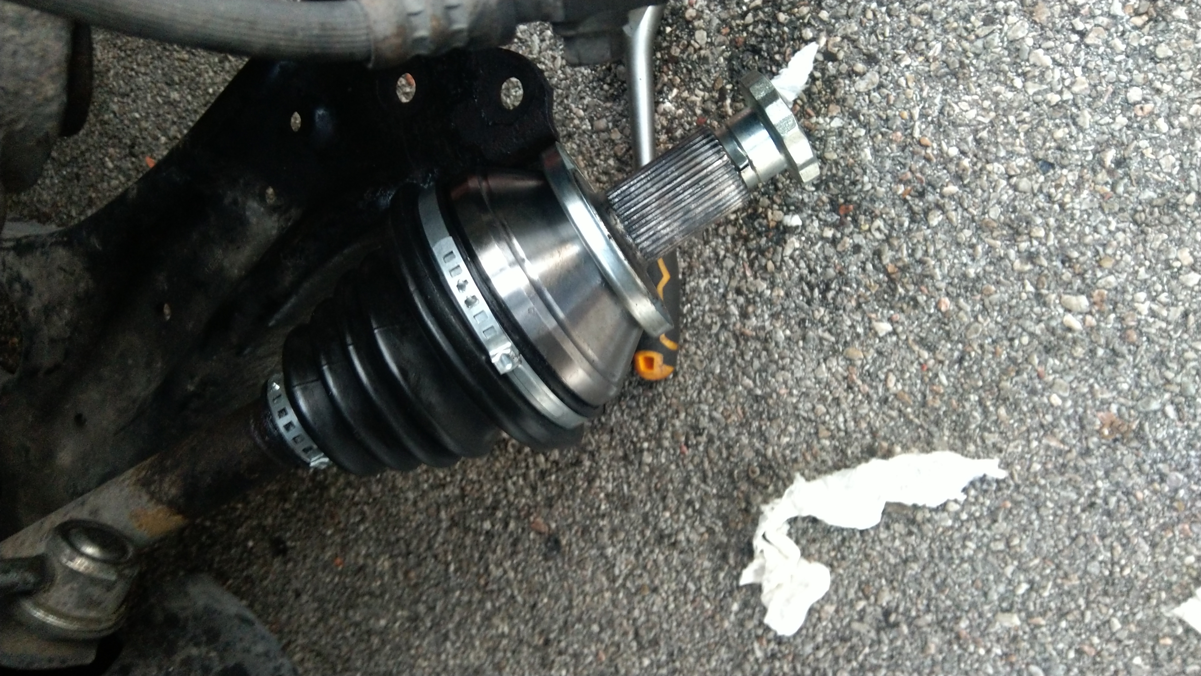

Did mine today, 36 mm thin wall socket for axle bolt, 16 mm spanner to hold bolts for ballj oint, and 16 mm socket for ball joint. Use ceramic grease and grease all threds. Its pretty simple.
Also use 500mm or longer breaker bar, also your toqrue erench can do it also.
If working with hand tools, hammer the 16 mm socket on ball joint nuts to avoid stripping.
36 mm 50Nm+45° by VW workshop manual.
