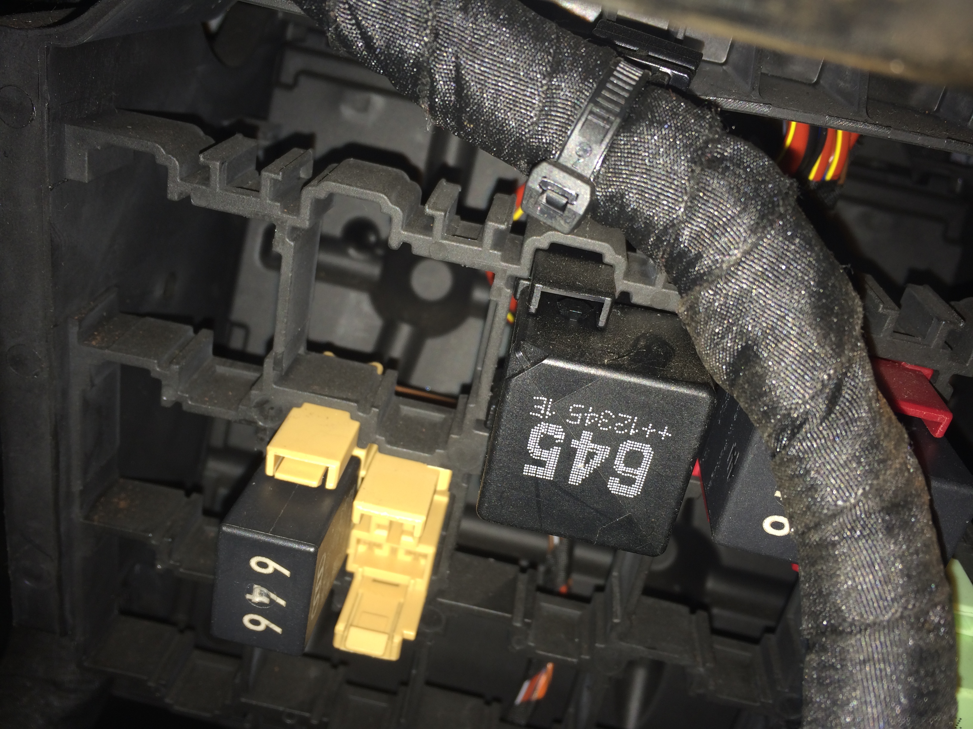

Update- I removed the lighswitch from the dash and put a short in between pin 7 and the pin opposite (red wire). Dipped lights still not working but could hear and feel the relay energising and deenergising. It appeared to be roughly where you pointed the relay out (number 7) but isn’t the type that’s labelled in that diagram, it’s a 646. Anyways I swapped this one out for another 646 and same thing happened. I’ve attached a photo to show what my relays look like. Does this mean the light switch and relay are ok and the fault lies somewhere else?

Yes, for your 6R model (2013) there are other diagrams for the arrangement of the relays, however, the relay you swapped is the correct one.
