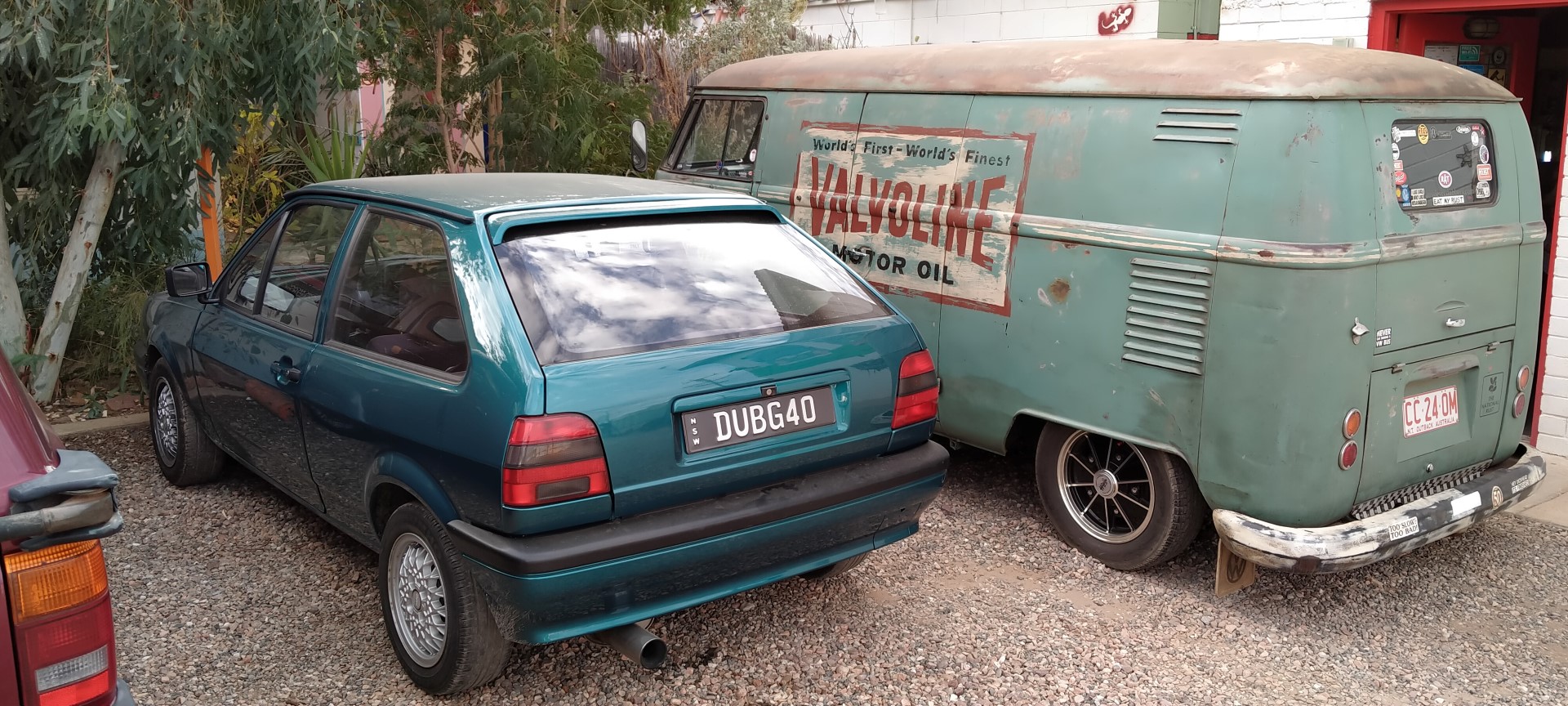

IMG20200720163929 (Large).jpg (533.59 KiB) Viewed 14854 times
