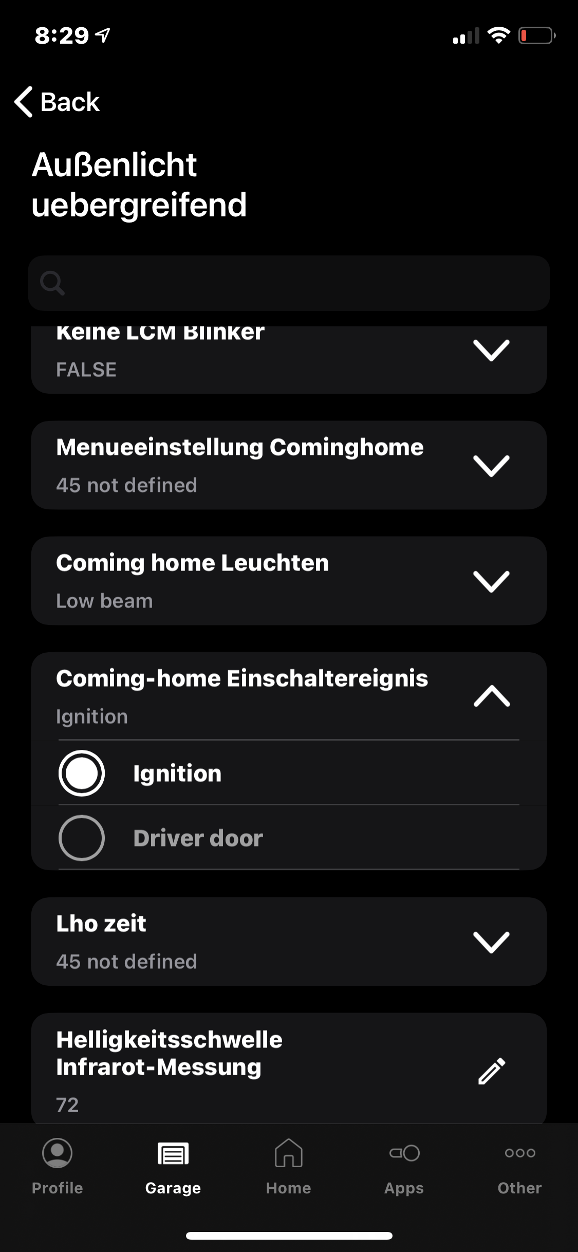

Hi I notice that my car when its dark and I open the doors (using the command) the light come on on for 5 sec. like I chose in car media, but when I close the doors the light do not turn on and I have also 5 sec. chosen in the media. My other car when I remove the key and open the drivers door the light immediately turns on. Is there a problem?

I thought it was automatic without needing flash the high beam.Is it possible to modify using obdeleven?
Teee
Posts: 104
Drives: Polo gti +
Re: Coming home leaving home
Post by Teee »
Yes it is possible with OBDeleven
01. central electrics [09]
02. Adaptation
03. Außenlicht_uebergreifend
04. Coming home verbaustatus
05. Default is manual change to automatic
06. Security access 31347
Hope this helps.
Edit- also to change when it is activated you have 2 options ignition off & drivers door open
02. Adaptation
04. Coming-home Einschaltereignis
05. ignition or driver door (default is ignition off)

I made that changes and it working perfectly, thanks Teee.
