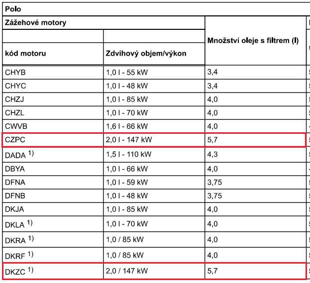

Deffinitly more than that. It is 5,7 liters for pre and post WLTP GTI's. (with filter change, not sure why would anyone do it without)
I took this screenshot straight from document downloaded from erwin (Jan 2019)

Definitely 5.7L, too much to get away with a 5L can - my service breakdown was charged at 6 x 1L units.

monkeyhanger wrote: Tue Feb 09, 2021 11:37 am Definitely 5.7L, too much to get away with a 5L can - my service breakdown was charged at 6 x 1L units.
Mine service breakdown was also charged at 6 x 1L and I did 3 changes myself and it always was around 5,6-5,7L.
