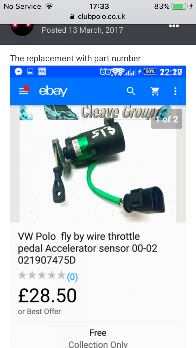

Could it be something like this ?
Re: Tickover speed increasing
I would inspect via diagnostics throttle position sensor while car not running 0%, and 100% fully pressed.
If you have it reading more than that then it has an issue. -Diagnostics
Surely it can be checked via multimeter but im not sure how to do it.
Diesel smell can happen as many say dpf rengen, and egr clogg.

Well, I got the car back. The problem was still there, ticking over at 1800rpm then if you blip the throttle it drops to 800. I ordered a new accelerator pedal from ebay. I then went on youtube and looked at loads of videos regarding vw accelerator problems. I found one video, albeit for a 2.0 TDI, the video said to get in the car, push the accelerator to maximum with your foot, then keeping your foot on the pedal turn on the ignition (don't start the engine) keep the ignition on for a minimum of 10 seconds, then release the pedal and turn off the ignition. I tried this and then drove 6 miles to fill up with petrol, the problem has not occurred since. its early days but its hopeful.
