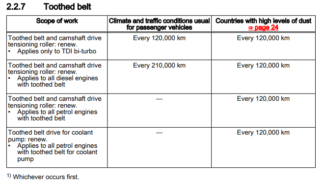

Hello all.
My girlfriend has just purchased a petrol 2018 VW Polo SE 1.0 TSI 95PS (does anyone know which engine code that is by the way?). I downloaded a workshop manual from TrueGear but this is what it says regarding the timing belt, or as VW call it, the "toothed belt":
The first two cells only appear to apply to diesel engines. Why isn't there a service interval (in miles and/or years) in the cells relating to the petrol engine?
Someone clear this up for me.

One explanation could be, VW Group intend that the cam belt in the EA211 generation of engines, and probably any newer versions of that engine family, it a "belt for life" - and as such, has not been included with other parts for periodic replacement.
Now that does not mean that it will last for ever, what it does mean, like many other parts, it will last until it fails, which, depending on your view wrt preventative maintenance, might not give you a warm feeling as if or when it fails, serious engine damage will take place.
I would hope that in line with this "longer life" in terms of cam belt, the tensioning roller will also have been "beefed up" and hopefully normally outlast the engine, as in the past many cam drive failures with VW Group products have been prompted/provoked by other items failing and forcing a cam belt failure, one of them, the water pump has been removed from this drive train so that is good in my world.

Hello, RUM4MO. So what you're saying basically is that it's a rubber belt designed to last the life of the car but the be on the safe side I should consider replacing it after 8 years or so?RUM4MO wrote: Wed Mar 03, 2021 10:40 amOne explanation could be, VW Group intend that the cam belt in the EA211 generation of engines, and probably any newer versions of that engine family, it a "belt for life" - and as such, has not been included with other parts for periodic replacement.

Most of the rationale around changing timing belts at 80k miles/120k km is to do with the water pump. No real issues with the timing belt itself, but VW were (maybe they still are, haven't looked) fitting crappy plastic water pumps that were driving off the timing belt. When the pump seizes, it shreds the belt. For this reason, VW used to insist on changing the water pump with the belt at 80k miles.
Perhaps we have more resilient metal water pumps now(I believe they are/were available as a replacement for water pumps that failed under warranty.
Its possible that other markets don't get the same terms for replacement as they get a better water pump fitted as standard that is far less likely to seize.
If I was keeping a VAG car to more than 80k miles and had a plastic water pump, i'd replace the belt and pump at the defined interval.

This family of engines don't have the water pump driven by the cam belt.monkeyhanger wrote: Thu Mar 04, 2021 6:49 am Most of the rationale around changing timing belts at 80k miles/120k km is to do with the water pump. No real issues with the timing belt itself, but VW were (maybe they still are, haven't looked) fitting crappy plastic water pumps that were driving off the timing belt. When the pump seizes, it shreds the belt. For this reason, VW used to insist on changing the water pump with the belt at 80k miles.

I emailed my local VW dealer regarding this and they replied with this information:
Why is this not in the owner's manual or even the service manual? Madness.

Perhaps it's not official guidance, but the recommendation of someone that wants to relieve you of £700?amperland wrote: Thu Mar 04, 2021 7:01 pm I emailed my local VW dealer regarding this and they replied with this information:
5 years seems a pretty short life for a timing belt these days, appropriate for a car from the 80s.
