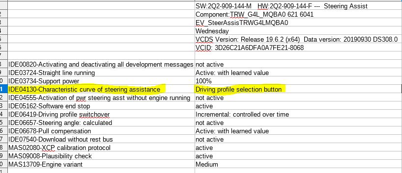

Re: Is it possible to stiffen the steering for better feel?
Post by ho8882000 »
It is possible to make the steering heavier permanently on a 2Q2 steering rack.
Use VCDS, go to "44 - Steering Assist" control module, then go into "Adaptation".
Look for this channel:
"IDE04130-Characteristic curve of steering assistance"
And change this channel's setting to "Dynamic".
