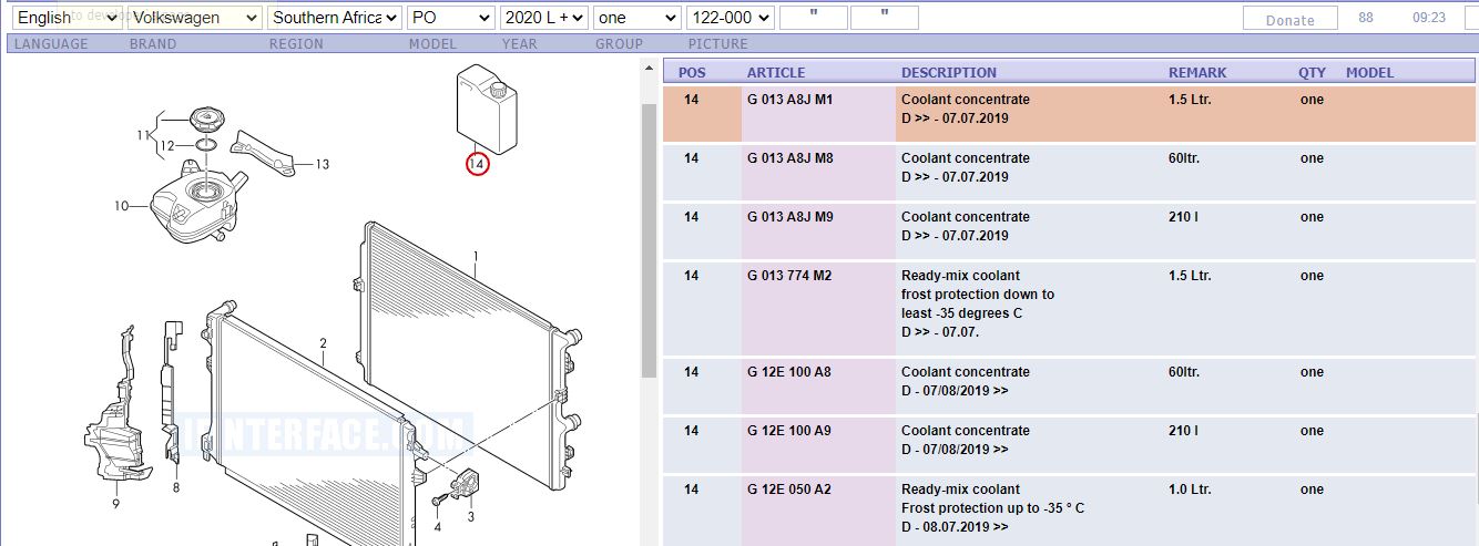

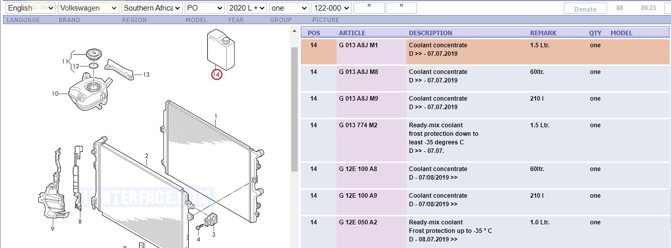

I think you should refill the coolant to the "Max" line, when the engine is cold.
And observe if the coolant level will drops again.
Another important note about coolant, if your car is manufactured before the 07-July-2019 it is filled with G13 at the factory.
But if you car is manufactured after the 07-July-2019, you car is filled with "G12 evo" coolant at the factory.
It is better to get the correct coolant and not mix the two, FYI.

ho8882000 wrote: Fri Apr 02, 2021 8:10 pm Another important note about coolant, if your car is manufactured before the 07-July-2019 it is filled with G13 at the factory.
Good info, thanks! Mine is May 2019 so would be G13.

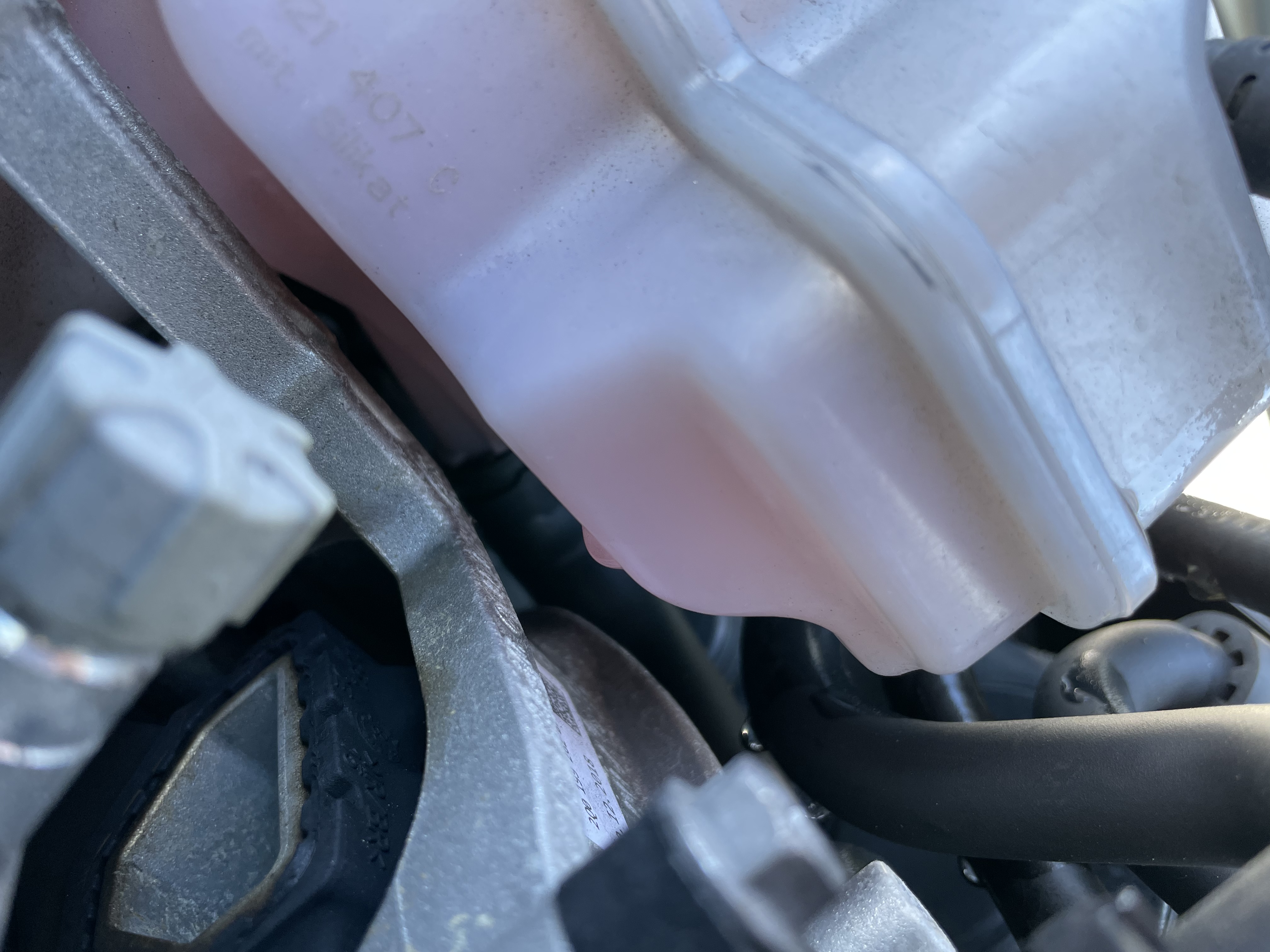

A quick update. I topped the car up with a small amount of tap water today, just to be safe and get myself and my partner home safe. I noticed there was a small droplet of pink fluid coming out from what appears to be the bottom of the coolant tank. Can’t fully confirm if that’s where the leak is coming from. At first I thought it was some water that spilled from the top up, but I dried everything off and could still see the pinkish fluid.
2 hour trip home and luckily no issues and no warning lights. I was pretty anxious though. Great end to the holiday. :lol:
Called VW earlier today, I’m booked in for the 31st of March. Earliest appointment I could get. :roll: Luckily the car is under warranty until May, so pretty convenient timing for something to go wrong! Will post back when I have an update.
