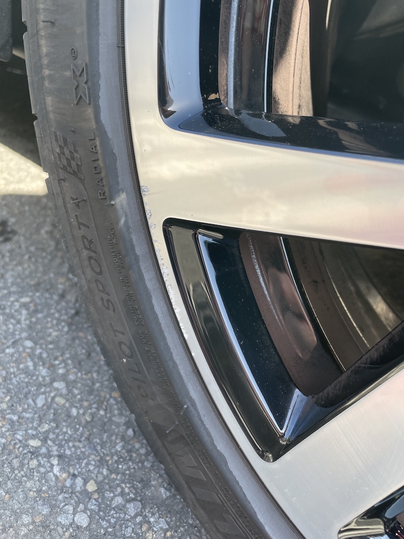

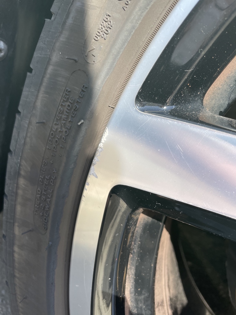

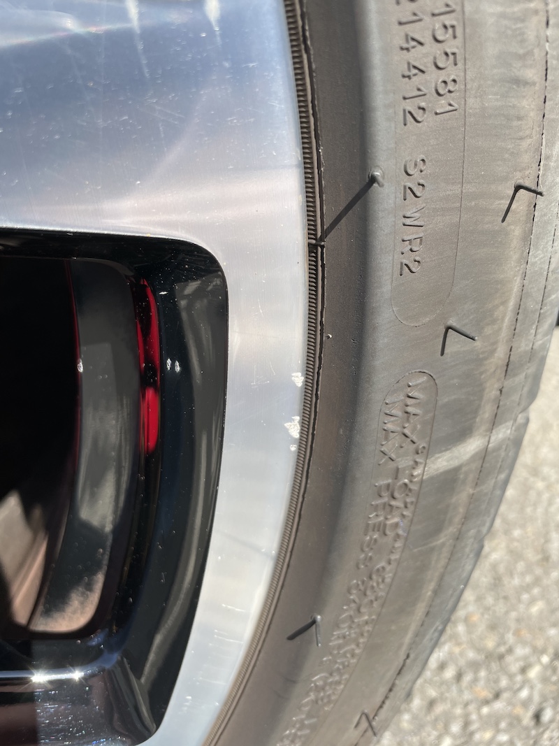

Afternoon all.
Did my first clean for about 9 months today and unfortunately noticed some damage to my front right alloy. I know for certainty I’ve never hit/scratched any of my alloys as I’m so paranoid when it comes to parking.
I’ve heard some horror stories regarding diamond cut alloys so I’m always sure to be careful when parking.
I’m assuming it might have been a stone chip / general wear and tear and now white worm has started? Bit gutted as it’s noticeable and looks like it’ll get worse. Under the assumption not much can be done?
Some pictures:

I have a similar small scratch on one of my rims hecause the installer struggled with getting the tyre wall over the rim during install (Michelin PS4 as well). It can be repaired but as always it costs money.

@S_94; it’s never nice to discover alloy damage. Has anyone else driven your car that might have caused the damage? e.g. your local VW dealer if your car was back at the dealership for servicing or warranty work or have you had new tyres fitted or a puncture repair during that 9 month period? As @OomStu_ZA had suggested, the damage could’ve been caused by a careless tyre fitter, or possibly a poorly maintained tyre changing machine.
Diamond cut alloys can be refurbished, and looking at the extent of your damage your wheel could easily be refurbished back to new factory condition. A good quality refurbishment of a diamond cut 18” alloy would cost around £80-£90 plus VAT. I don’t know where you’re located in the UK but Lepsons are meant to be one of the best alloy wheel refurb companies - they’re based in Gillingham, Kent and get good reviews on other VW forums. Link to their website below;

Nobody else has driven it and it hasn't been into VW since last May. I cleaned it a few times between May-August and it definitely wasn't damaged at that point. I'm now wondering if I might have caught it on the curb outside my house by accident without noticing, I do always park that side of the car facing the curb so it could have happened.SRGTD wrote: Sat Apr 03, 2021 5:37 pm @S_94; it’s never nice to discover alloy damage. Has anyone else driven your car that might have caused the damage? e.g. your local VW dealer if your car was back at the dealership for servicing or warranty work or have you had new tyres fitted or a puncture repair during that 9 month period? As @OomStu_ZA had suggested, the damage could’ve been caused by a careless tyre fitter, or possibly a poorly maintained tyre changing machine.

If it's a long term keeper rather than PCP for 3 years, rinse and repeat, i'd get the set of wheels powder coated, whiteworm corrosion is almost inevitable at 2.5 years old with diamond cut. If it'll be going in against another, I doubt the dealer would mark your p/x value down for it, are you likely to scrape again? What you should do, while you decide is get that scrape covered with clear lacquer so the bare metal doesn't corrode.

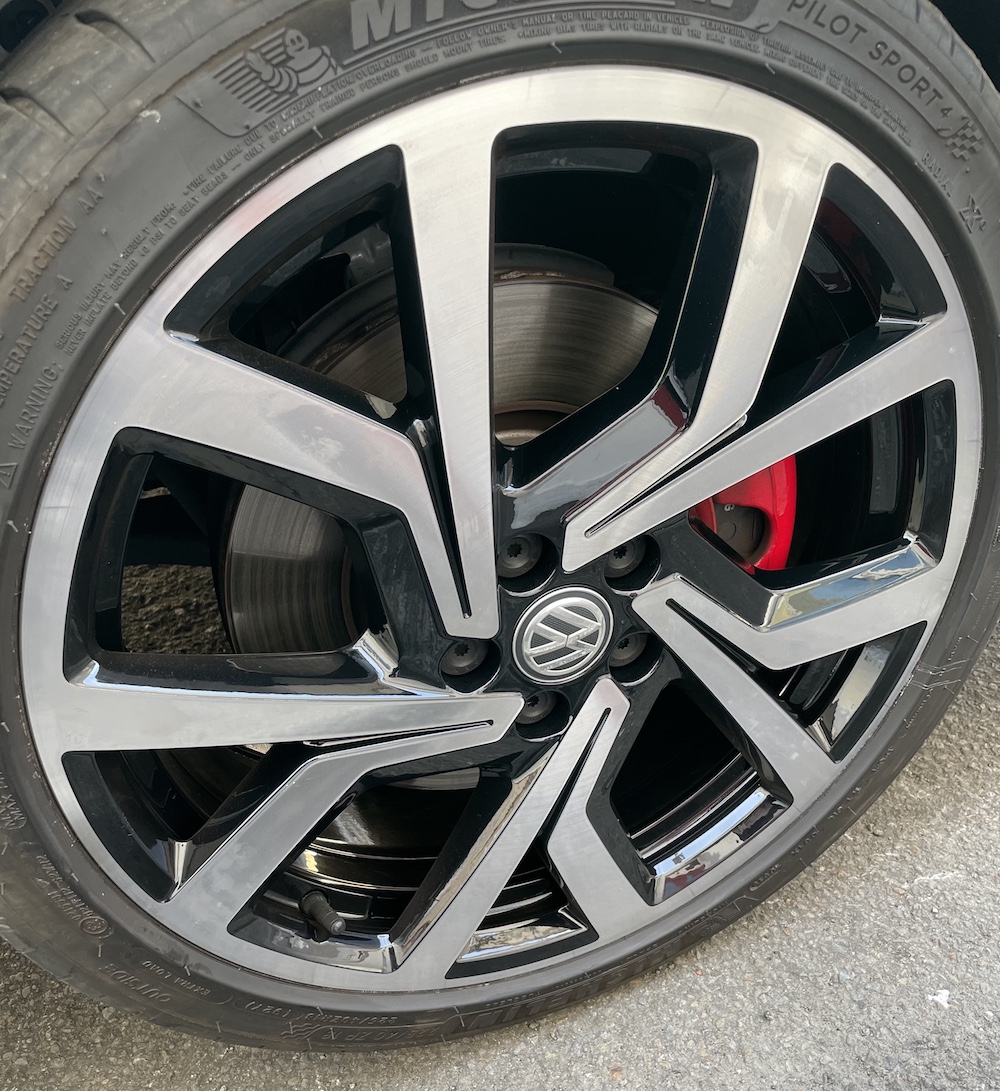

Had the Alloy repaired yesterday (picked up today). Was done by a company called The Wheel Specialist, have to say the service was brilliant and the Alloy has come out looking brand new. Really pleased with the end result. Total cost of repair was £120.

That looks better!
. £120 is about the going rate for an 18” diamond cut alloy.
