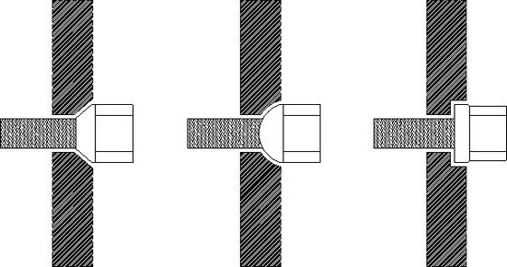

Most aftermarket wheels use bolts with a conical seat - like the bolt on the left of the picture below. VW OEM wheel bolts have a radius seat (also referred to as a ball seat bolt) like the middle bolt in the picture below. It’s really important that the profile of the bolt seat and the bolt hole in the wheel are the same, so the mating surfaces between the bolt seat and the bolt hole in the wheel are a snug, tight fit. If radius bolts are used on wheels that should be fitted with bolts with a conical seat, then it won’t be possible to get that snug fit between bolt and wheel, so there’s a risk the bolts could work loose or fracture.
When buying alloys from reputable alloy wheel retailers, they should automatically supply a fitting kit that include bolts of the correct seat type for the wheels being bought, along with spigot rings if required (if the centre bore size of the wheels needs to be reduced the the Polo’s 57.1 centre bore size).
