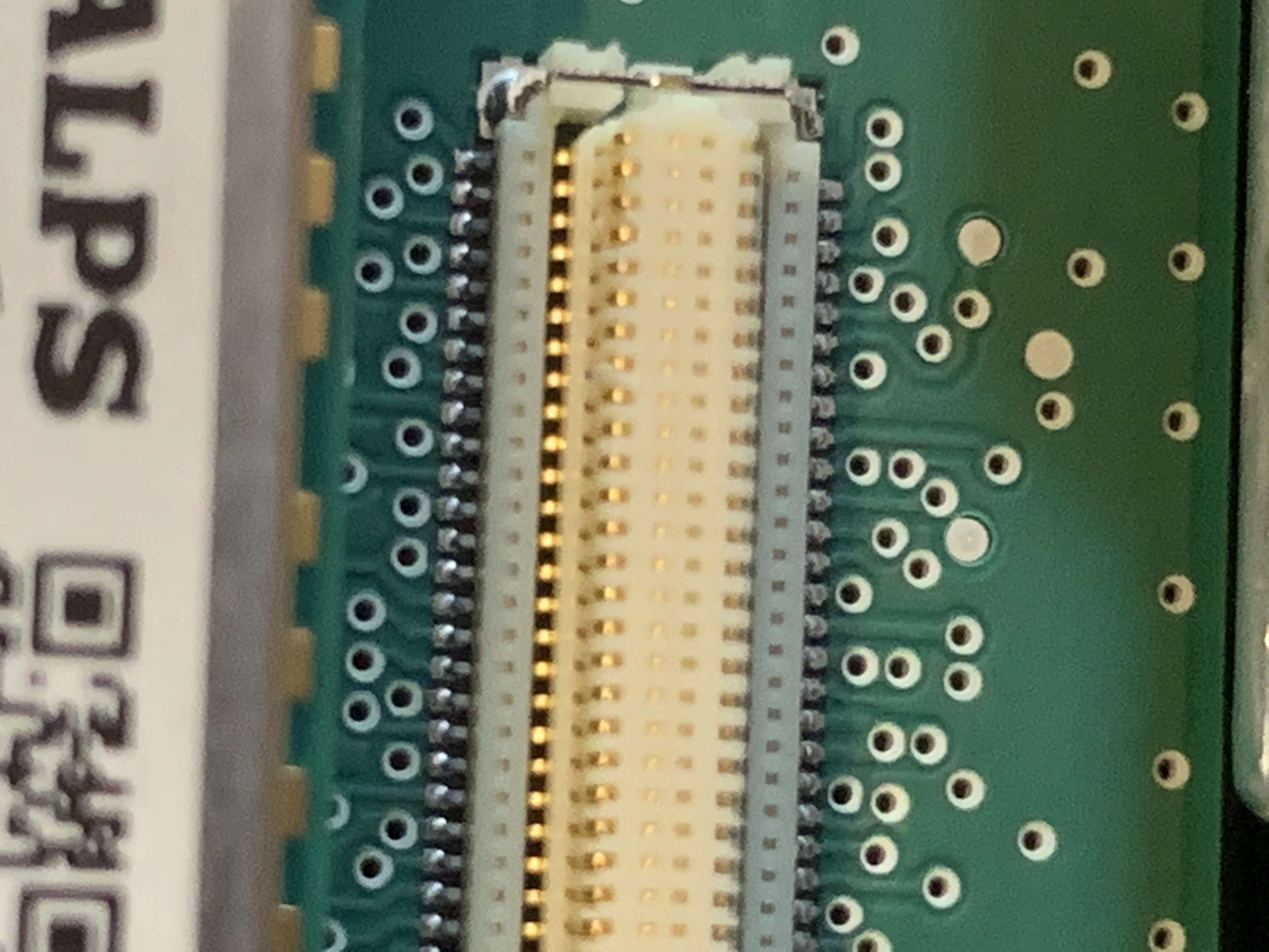

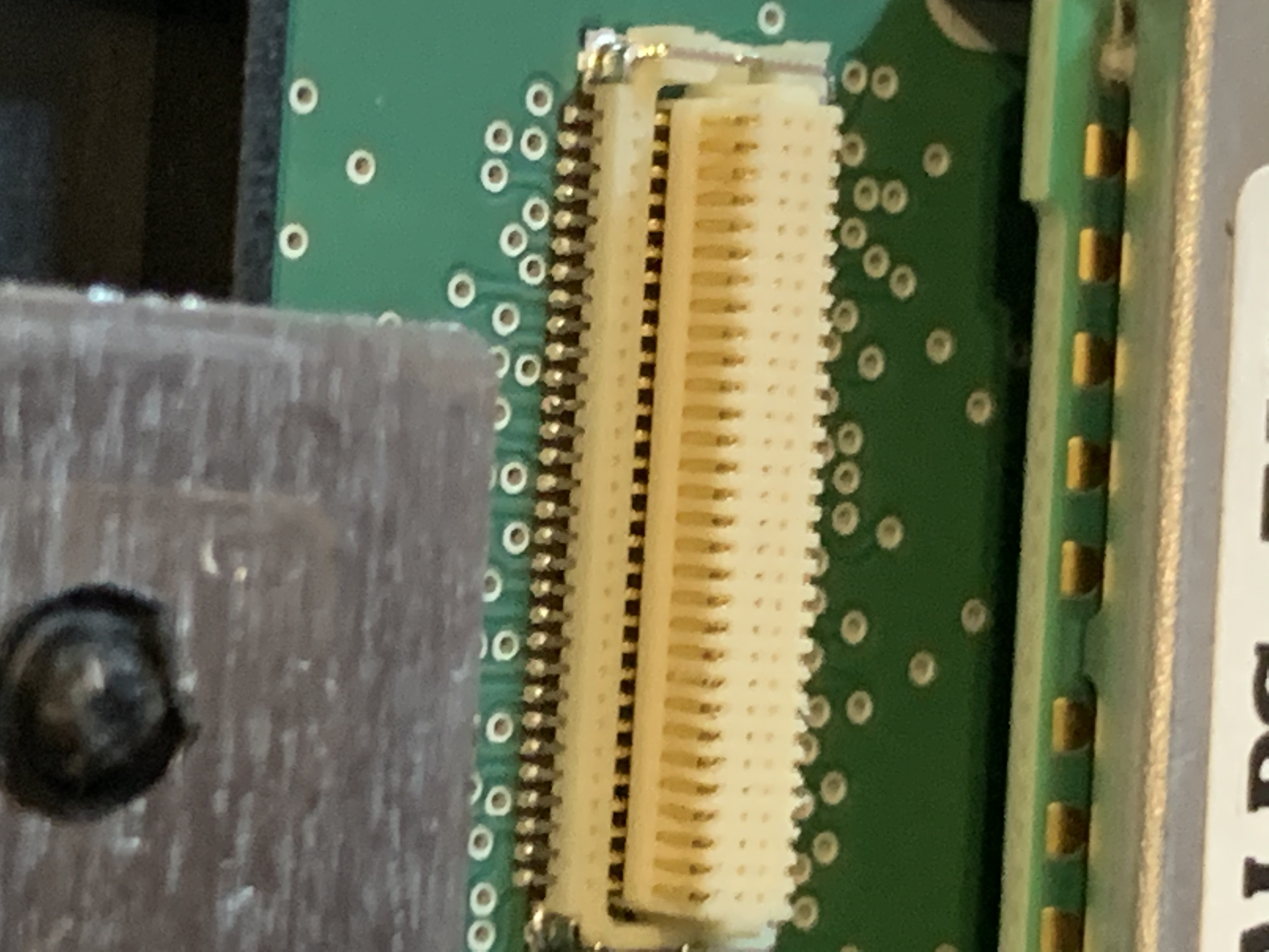

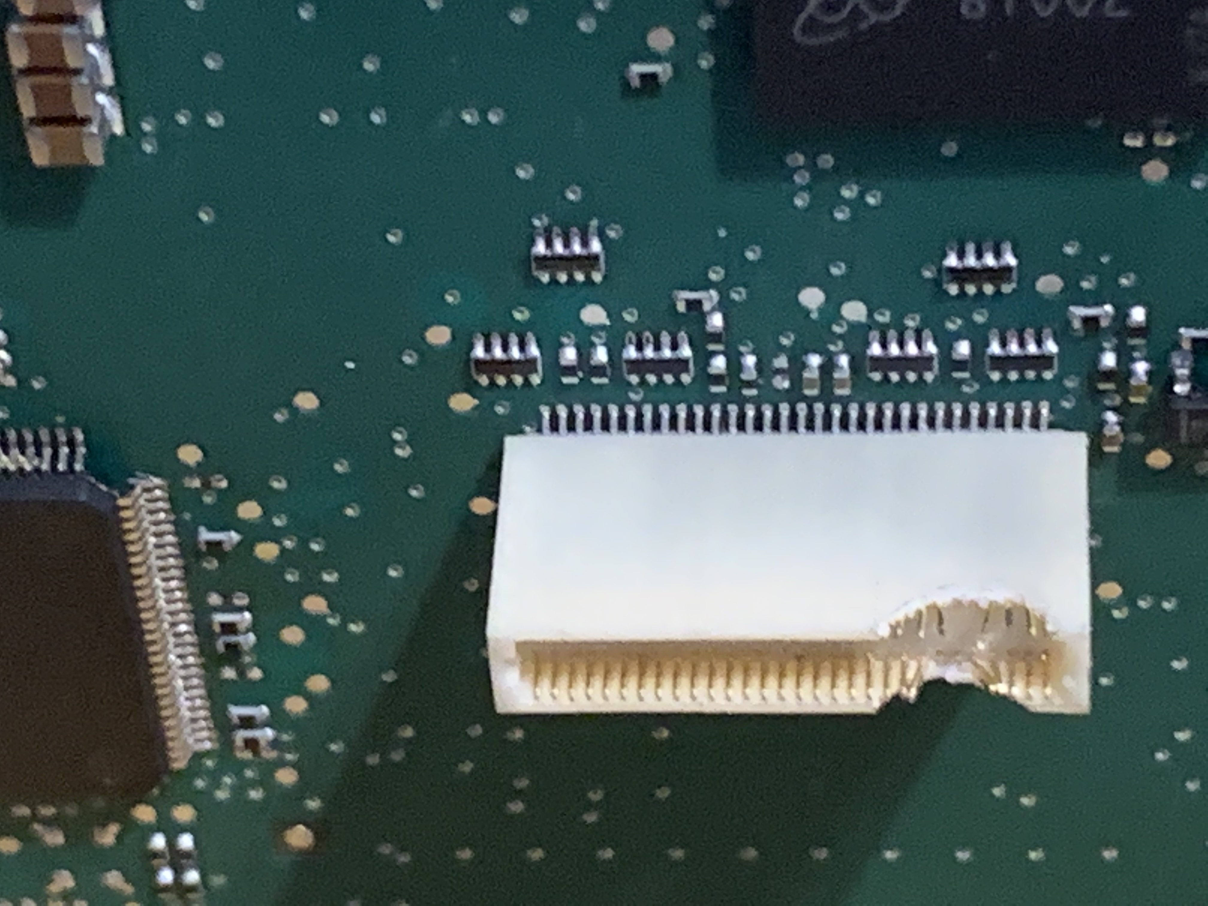

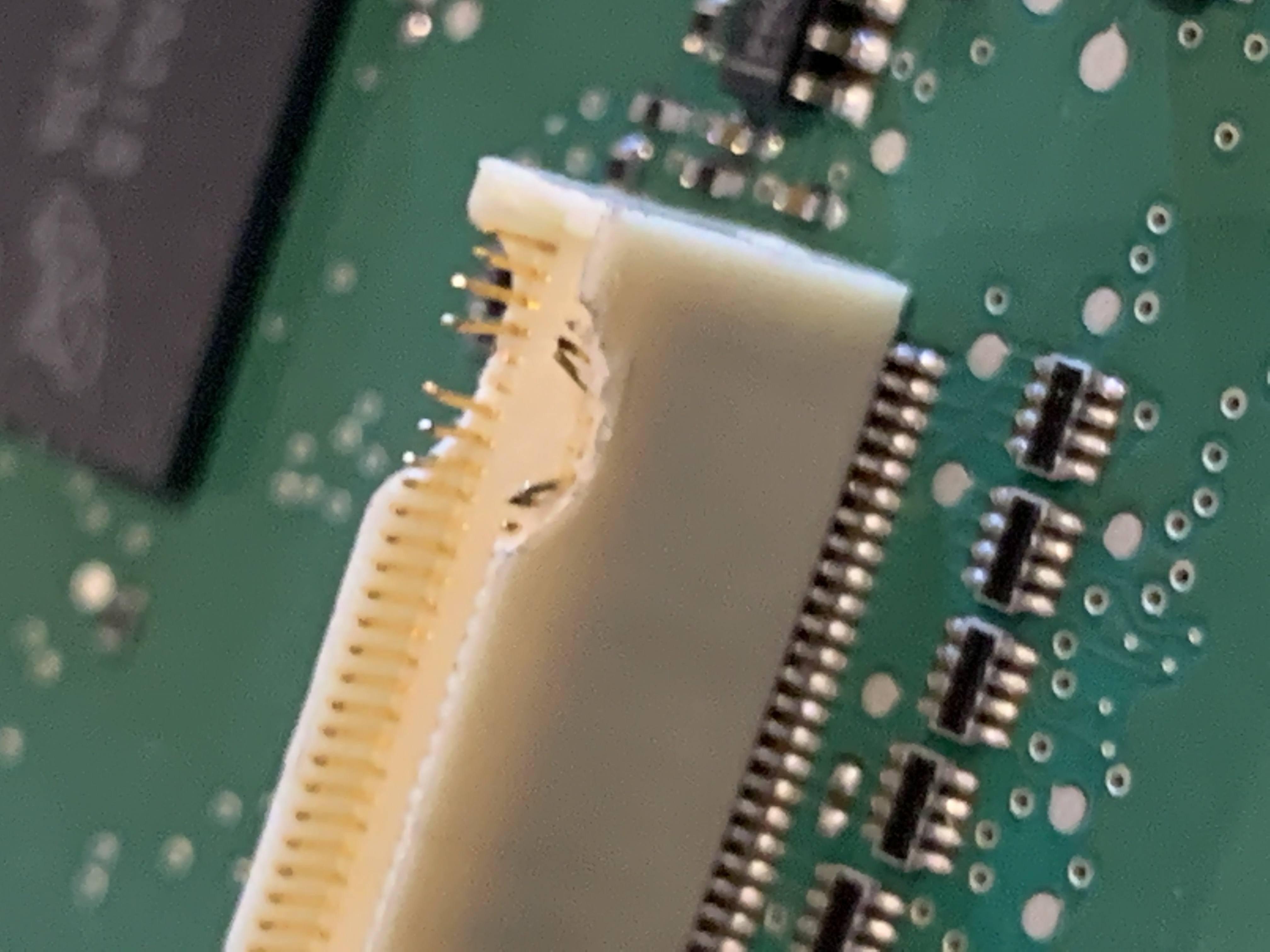

Hi folks,
Can anyone manage to replace a board to board connector on my mib2 unit?
See pics
The dvd drive connector looks okay, but the base board one is toast±!
HELP!

You need to source the connector and take it to some eletronic repair center, like laptop motherboard repair or phone repair and they can swap it. Its pretty easy with right tools

Neither do I, I only opened it as the release key was stuck for releasing it, no bit in the unit either..

60 pin, 2 rows of 30, the height seems the challenging bit, any pcb guys on here who think they could help please drop a message!

Any halfway decent electronics repair place should be up to replacing a simple connector in 30mins or so. You could even do it yourself with a heat-gun and some solder paste, but that could be another disaster waiting to happen.
The difficult bit is sourcing the correct replacement connector. That looks like a Board to Board (BTB), Female Receptacle (F) , Surface Mount (SMT) PCB Header
This is the closest one I could find without any information.
https://www.amazon.co.uk/Ochoos-Female- ... B07QF5QZFW
The problem is! Though many look very similar. However they are substantially different where it matters!! The pins have numerous different pitches. 0.5. 0.6, 0.63, 0.635mm Likewise the heights come in all sorts.
RS/Farnell/CPC all have reasonable part finders.
https://uk.rs-online.com/web/c/connecto ... 4294885285
If you're lucky you may be able to spot a part number on the body that may help your search. You could try measuring it but you need to be very accurate to get it right.
I think your best bet would be to try and find another faulty unit cheaply and scavenge it for parts.

That type of connector is called an "Arrayed-pin" Specifically a BTB (Board To Board) STM (Surface mount) There are literally dozens of variations. First off you need to know the size and arrangement of the actual pads on the PCB. (when they design and manufacture these beasties. Then tend to choose a connector and then lay the boards to suit the connector they've selected)
You've said it's 60 pin but what pitch are the pins, etc. Some layouts are pretty common with lost of connectors that match the layout. However some layouts are not so common so finding connectors that suit will be a pain or even impossible. If you can find something that suits then narrow it down to the correct stack height if you can find something. You may not be able to find an exact match. However you may well find an alternative that fits the pad layout on the board. (even if it means removing both parts of the connector to fit the alternative.)
Have a look on here. It's just the RS parts catalog, but it might help your search.
Surface mount pads by their very nature are small and delicate. Trying to attach wires to them normally end up in the pads leaving the board as it requires too much heat. You might get away with the odd pad, but 60! you've got no chance.
It might be worth a phone call/email to anyone you can find that specialises in car audio repairs. They might be able to tell you or even sell you the part (I wouldn't put money on it though)
