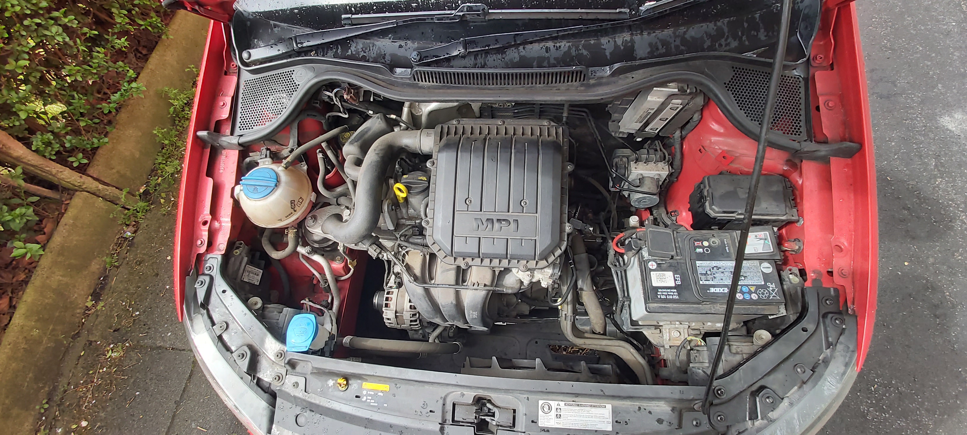

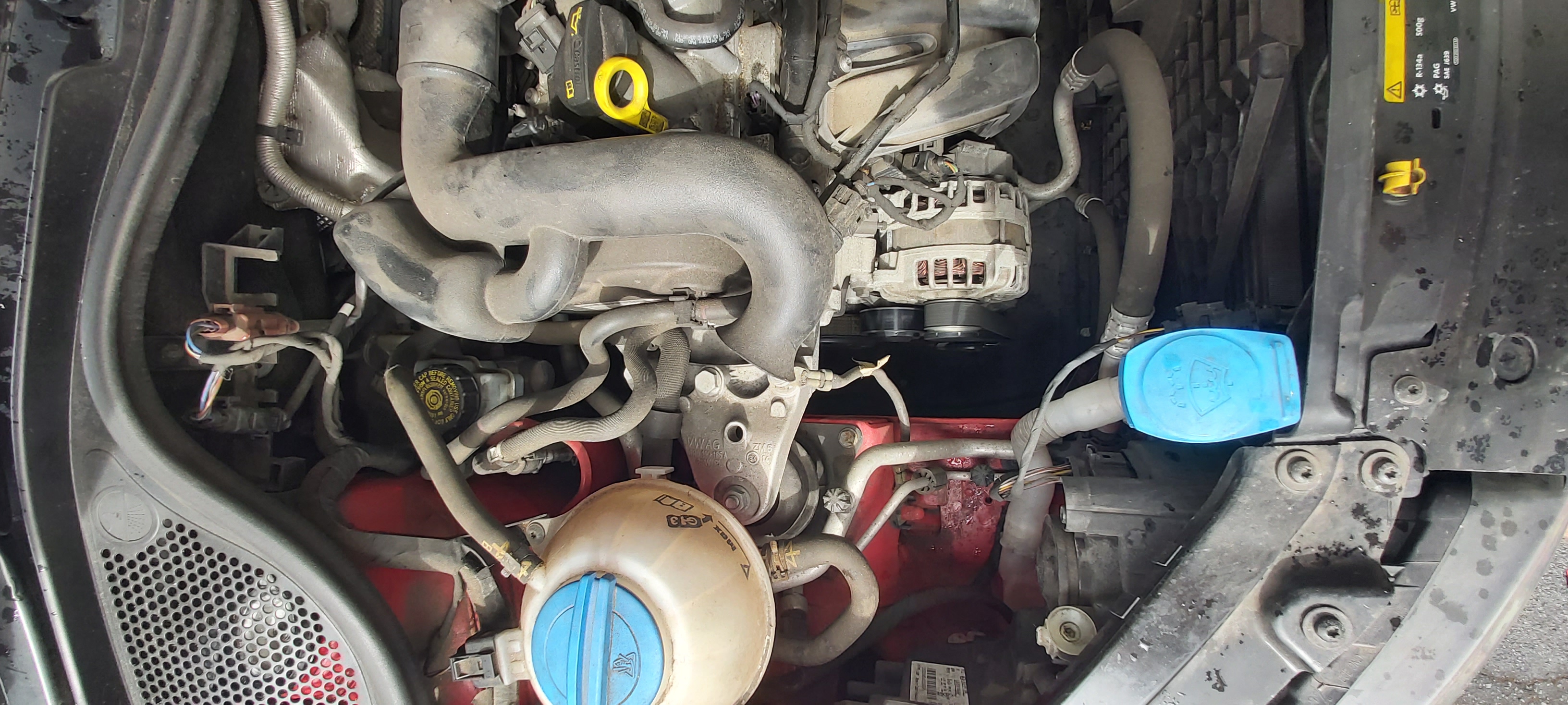

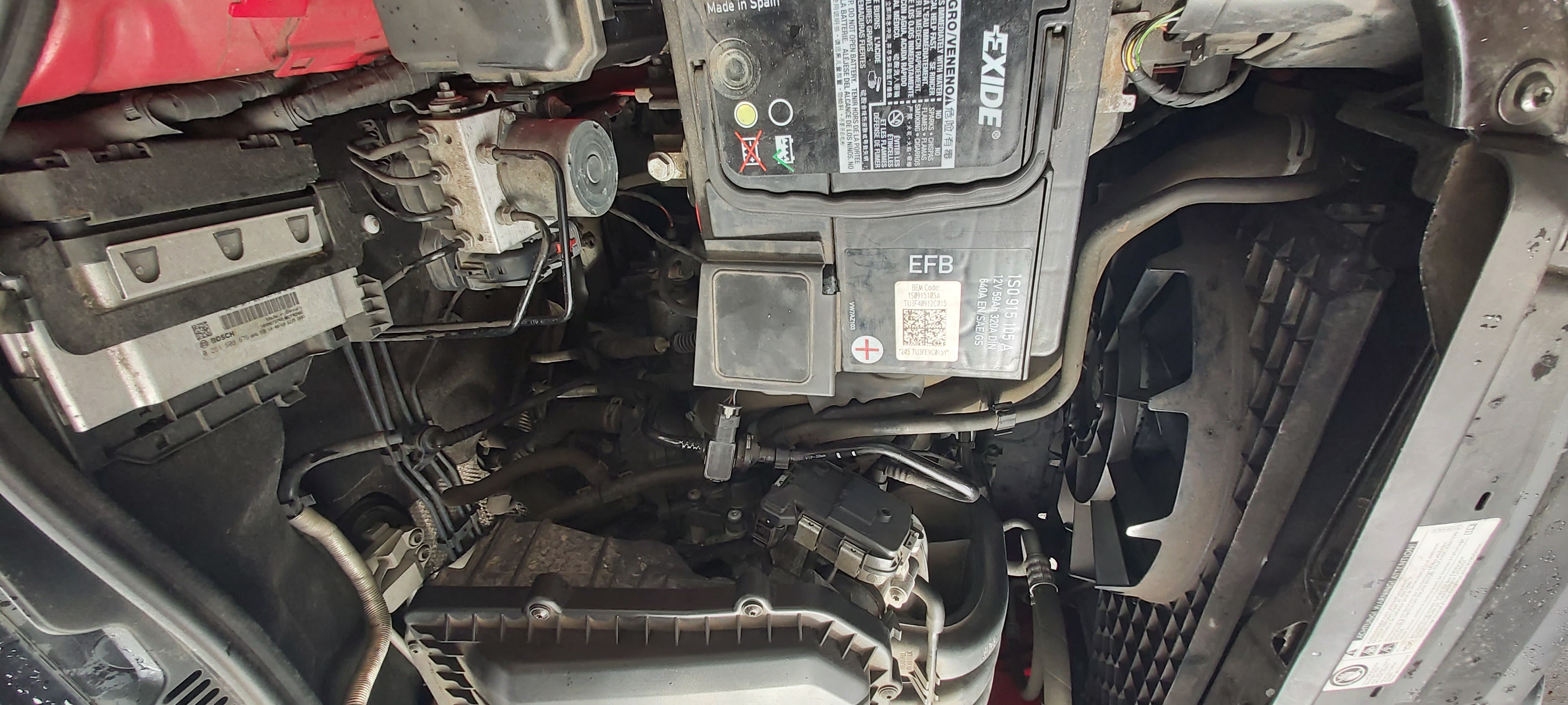

Hi i have the old p0101 issue but unable to locate my maf sensor
I have attached pics of my engine.
I've lurked on here a while and hopefully someone can help me
My car is a 2015 bluemotion, the stop start has also decided not to work at the same time so unsure if related

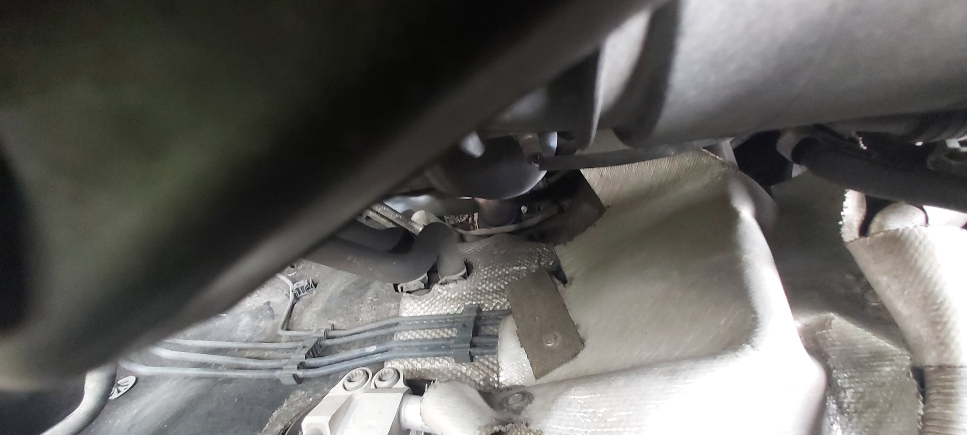

Are you sure it's a MAF sensor and not a MAP?
MAP senor is located on left hand side of inlet manifold. Just behind and above back end of the alternator. You can see it on your 3rd image.

hi mate just with p0101 a mechanic i know said it shows as the maf when he scanned it for me, could u let me know where on that third pic, im not the handiest under the bonnet (i know the alternator only though a previous cars one dying on me on a dual carriageway!)

Sorry I've nothing set up to host images or I'd highlight it for you.
But as best as I can describe. On the 3rd image look at the alternator. Just slightly above and behind it you can see a connector with the wires showing at the front and feeding into a small harness. That's the MAP sensor. it's attached to the inlet manifold (Plastic part to the right)
Can't suss out how to embed Youtube video's, but here's a link showing it's location.
https://youtu.be/AI8q40i1Gic
If you're not too clued up I'd see if you can find a mate who is. If you break the clips getting it out you're knackered. May not be the MAP, but at least you know where it is now. :)

Won't let me add a pic either haha. I'm assuming the one showing a green and brown wire?? Cheers
