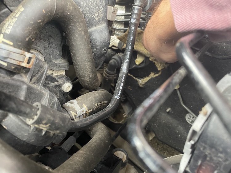

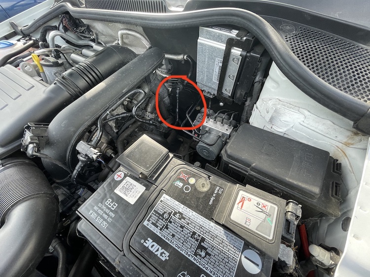

Just to update and hopefully conclude this topic, looks like I have finally found and solved the problem!
That odd rubber bung I posted a pic of before, turns out it was indeed the A/C condensation vent tube, but it had been squashed in!
This must have been the way it was since manufacture, as if it wasn't for me cutting the felt I would never have been able to fix it.
I've tested the A/C on a drive, and touch wood the interior remained dry, and checking under the bonnet the tube was dripping condensation as it should be. Phew! Fingers crossed that was the problem, and I just need to address the mould specs caused by the condensation.

I have the same model and year of Polo as yours, and so have been following your problem with considerable interest. Water leaks into the footwells, whether on the driver's side or passenger's, seem to be fairly common on these 6Cs, and at various times I've even suspected a leak on mine. I've always had a suspicion that the scuttletray-to-bulkhead area was not watertight. However, thus far, my footwells appear to remain dry.
Can you give me and others a more-detailed description of exactly where that AC drain outlet is sited? Normally, is there a tube connected to that drain outlet, a tube that'd carry the fluid downward and deposit it on the ground? How accessible is that drainpoint? Were you able to get to it in the engine compartment only by cutting open the sound deadening on the bulkhead? Is it actually right low down on the bulkhead? I ask because I'd like to check the status of mine.
You say you found that, on yours, the drain outlet had been badly damaged when originally fitted. So, did you therefore buy and fit a replacement drain outlet? The two pics you've provided show a damaged drain outlet and what appears to be a good one.

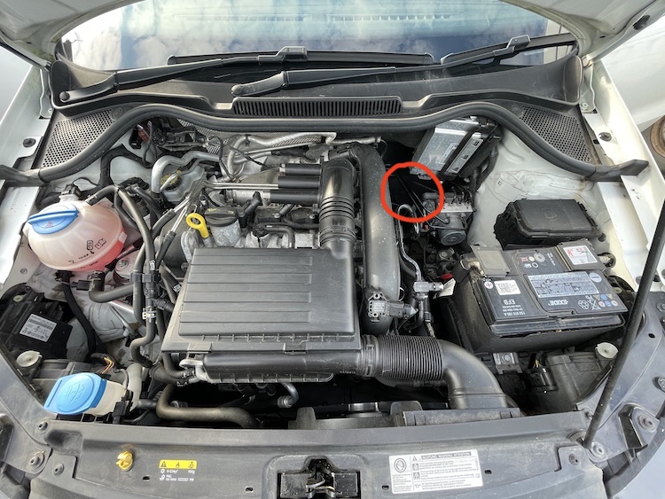

I know that I'm trying to answer someone else's question, and I can't check on my wife's car because it is raining heavily right now, but I think if you look around the area under the bonnet that has been circled in red in the maybe first posting of this thread, you will find a shaped area that that drain valve hides behind.
I should really check the condition of that in my wife's Polo soon!

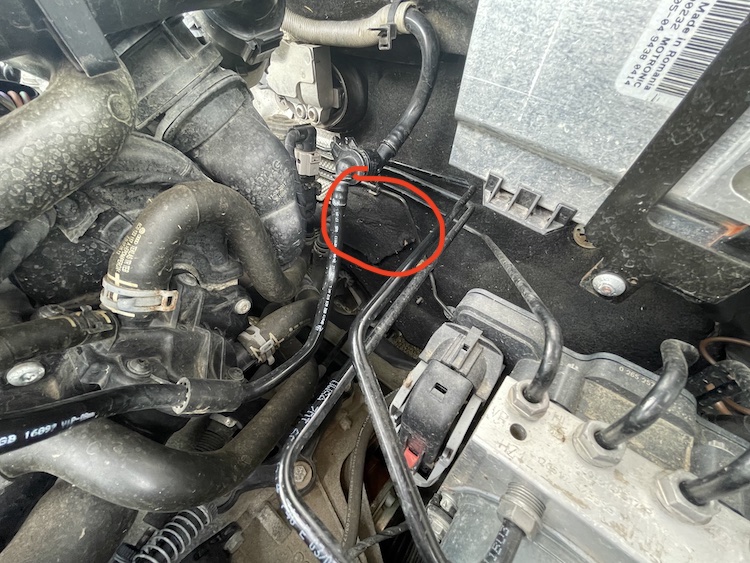

I've looked at that area in my wife's 2015 Polo, removed the sound deadening retaining "nut" and folded back the sound deadening fabric, but could not find that drain, so I'm guessing that it is at the same level as the coolant pipes that go into the heater matrix - is that where it is?

RUM4MO yes I think your correct , I believe the ‘drain’ is part of the heater box assembly so on the production line it would have been fitted from the inside of the car ,this may explain why it’s kinda in the hole in the bulk head but not properly through and doesn’t clear water.

I am too interested more on this, where is this white plug location exactly. My polo can mist up in the rain say when I stop at lights the car cuts off (BM). After about 30 sec mist comes on the windscreen. Maybe it's down to this..
You say engine pic were you circled?

by DarrenR
Sorry for the delay in replying!
I've just gone out and taken some new pics to show exactly where the drain is. Hope this helps identify it! Yes I had to cut the fabric to find it, based on where I believed it should be.
And no, the drain wasn't replaced, the little tube was kinda folded back in itself, and a bit of a wiggle freed it. It was a bit of luck really!
