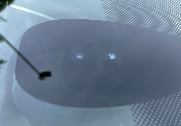

Ok, so lights work flawlessly. It was 5 min job. Thanks for the help! But the automatic wipers dont work. I am not sure if there are 2 types of the sensor and my doesnt have the capability or i just did it wrong. Is there another coding to add the auto wiper option in the infotainment like the rain closing windows?

Yeah, sure. My girlfriend has it on Skoda Octavia 3. Excatly same stalk, but in 1st position it wipes once and then stops. Mine keeps going. And i dont have the option to turn the feature on and off in the menu.

You could try checking the rain sensor live data while sprinkling some water in the sensor area. That would tell if the sensor is well installed and communicating.
