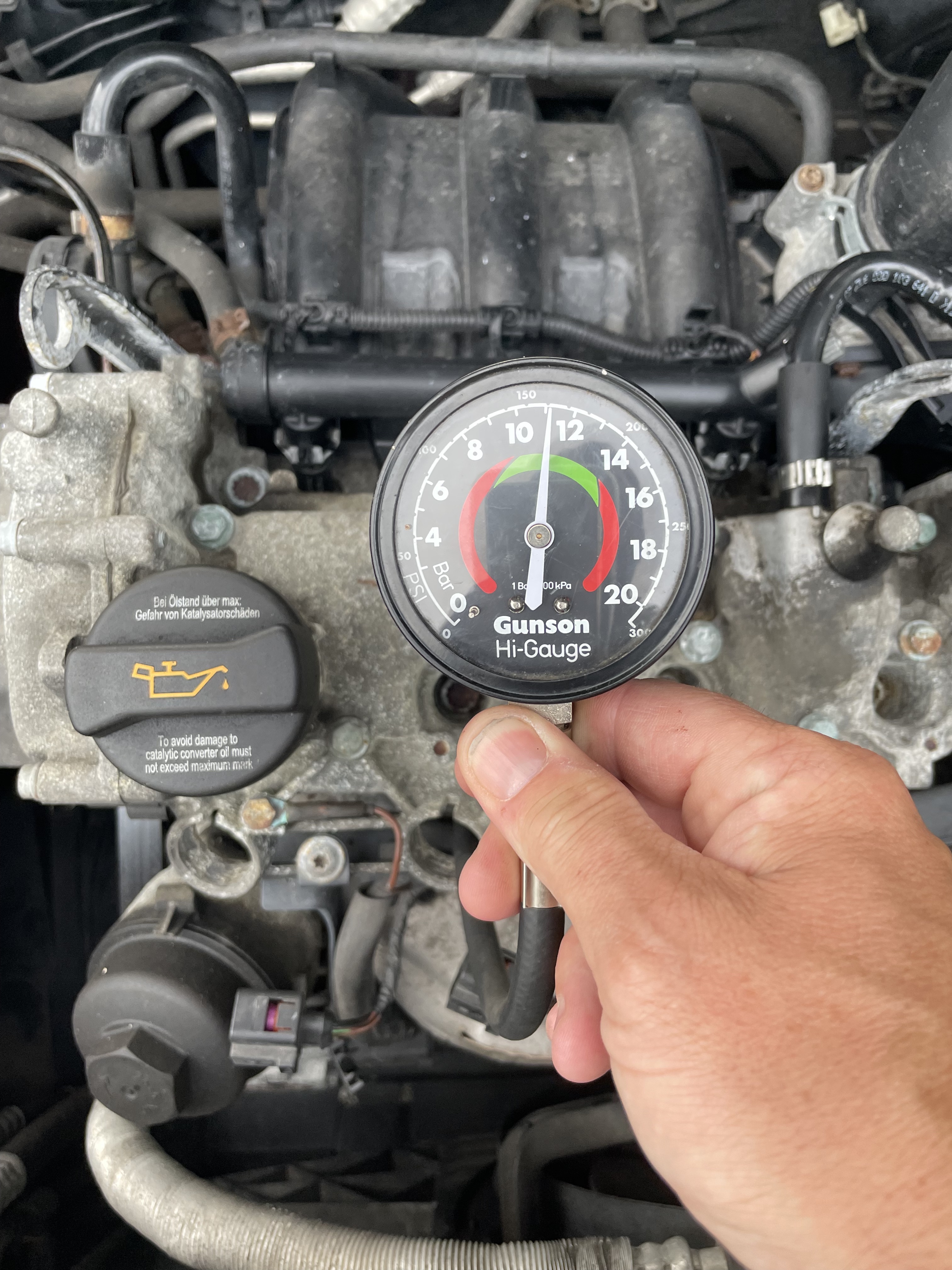

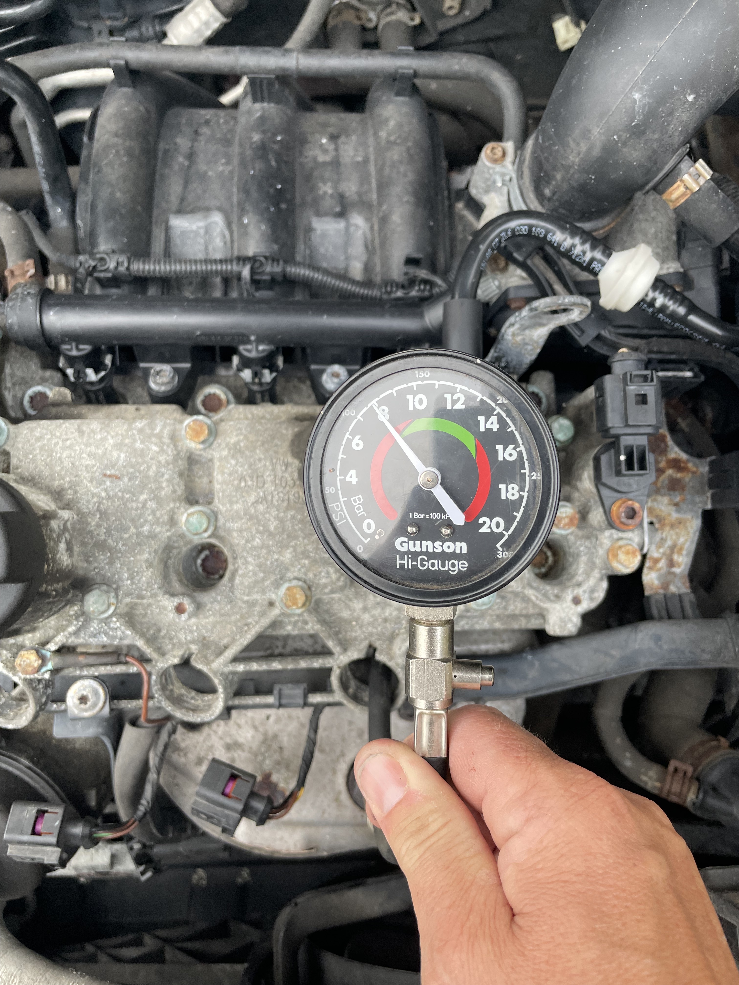

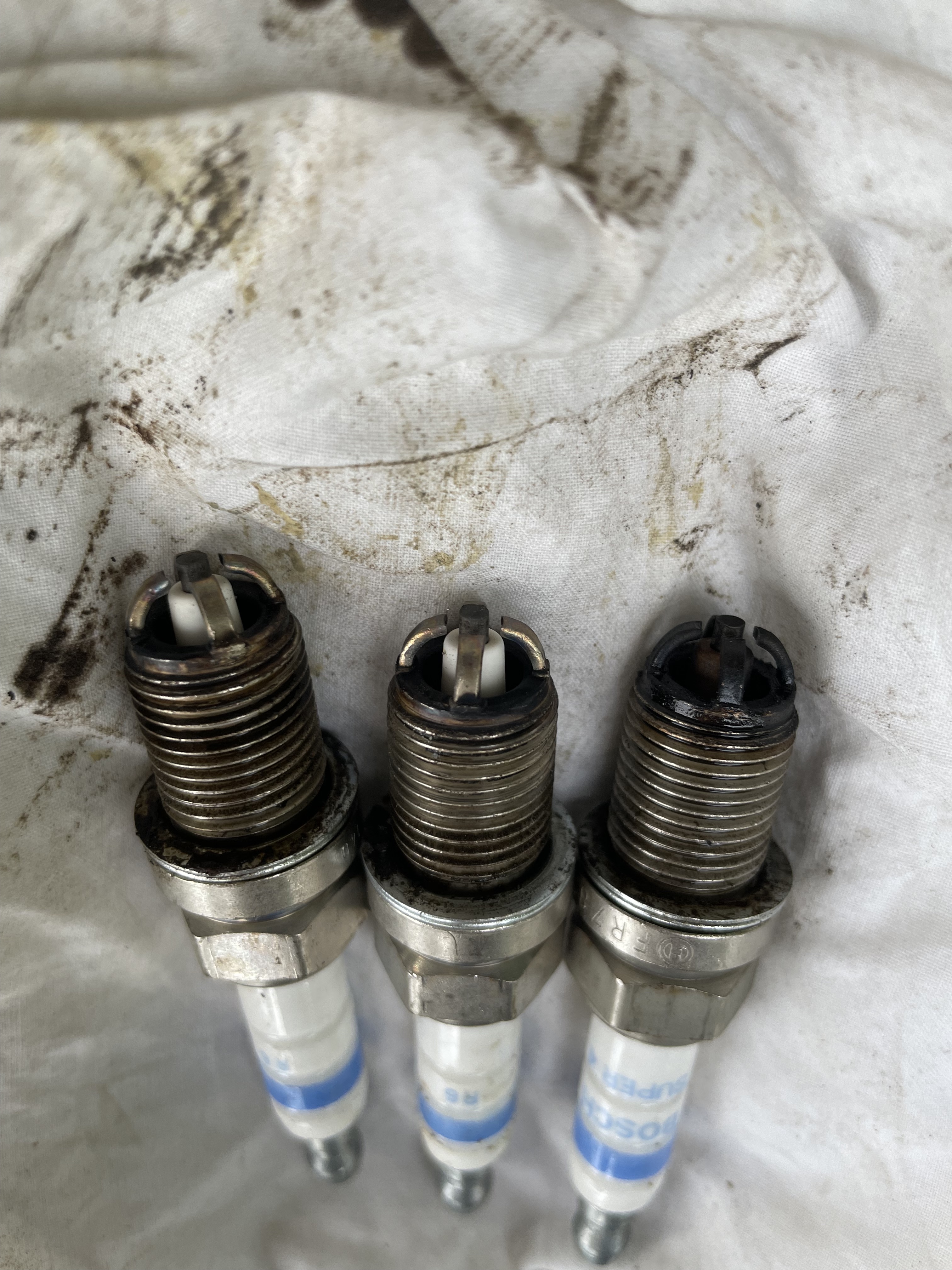

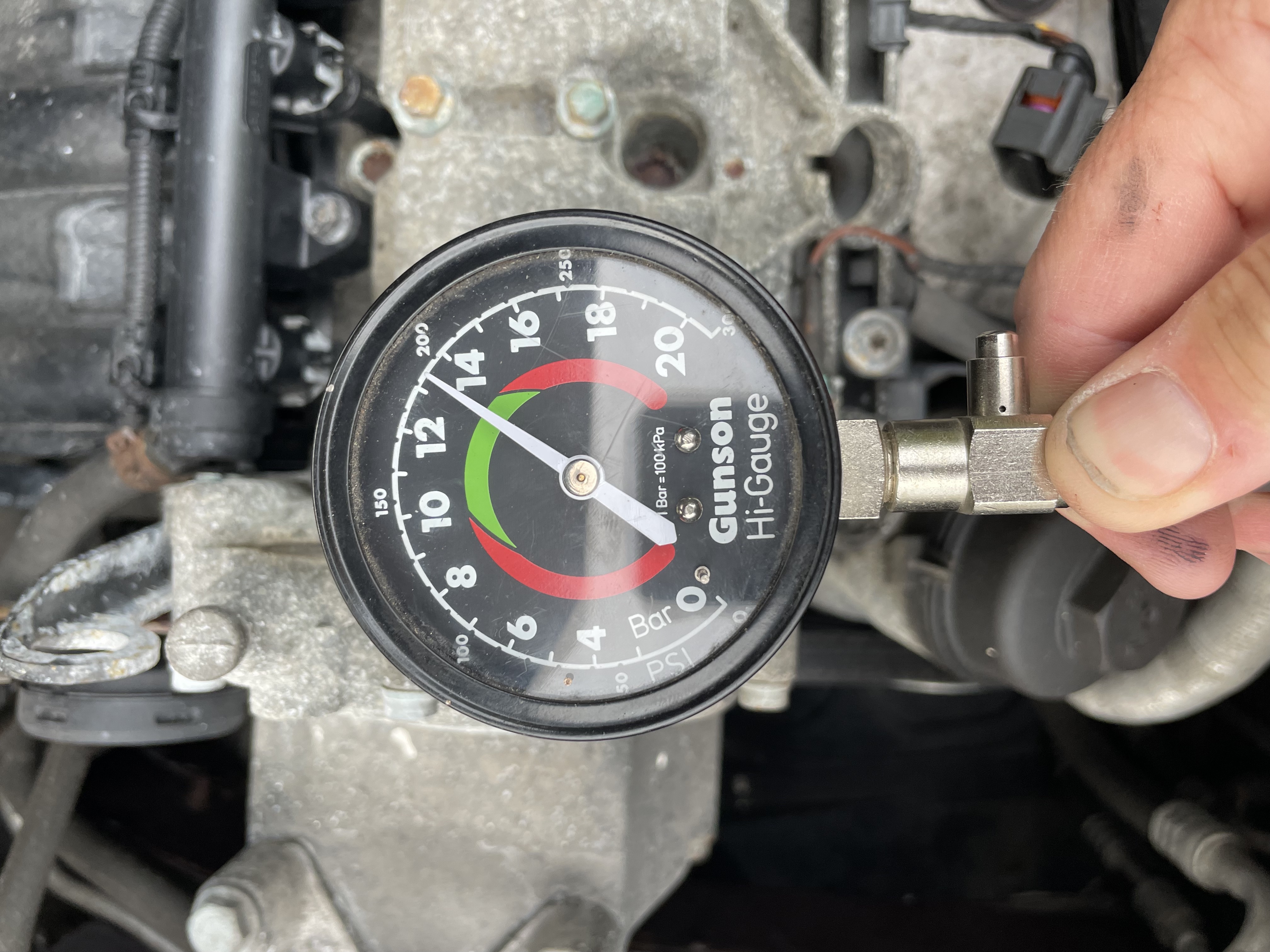

I enclose pictures of the compression tests and plugs 1,2 & 3 (the black fouled one)
1 = 200 ish
2 = 150 ish
3 - 100 ish
I have cleaned the throttle boddy and also put new coil pack on 3 but the P0303 fault and engine warning lights remain.

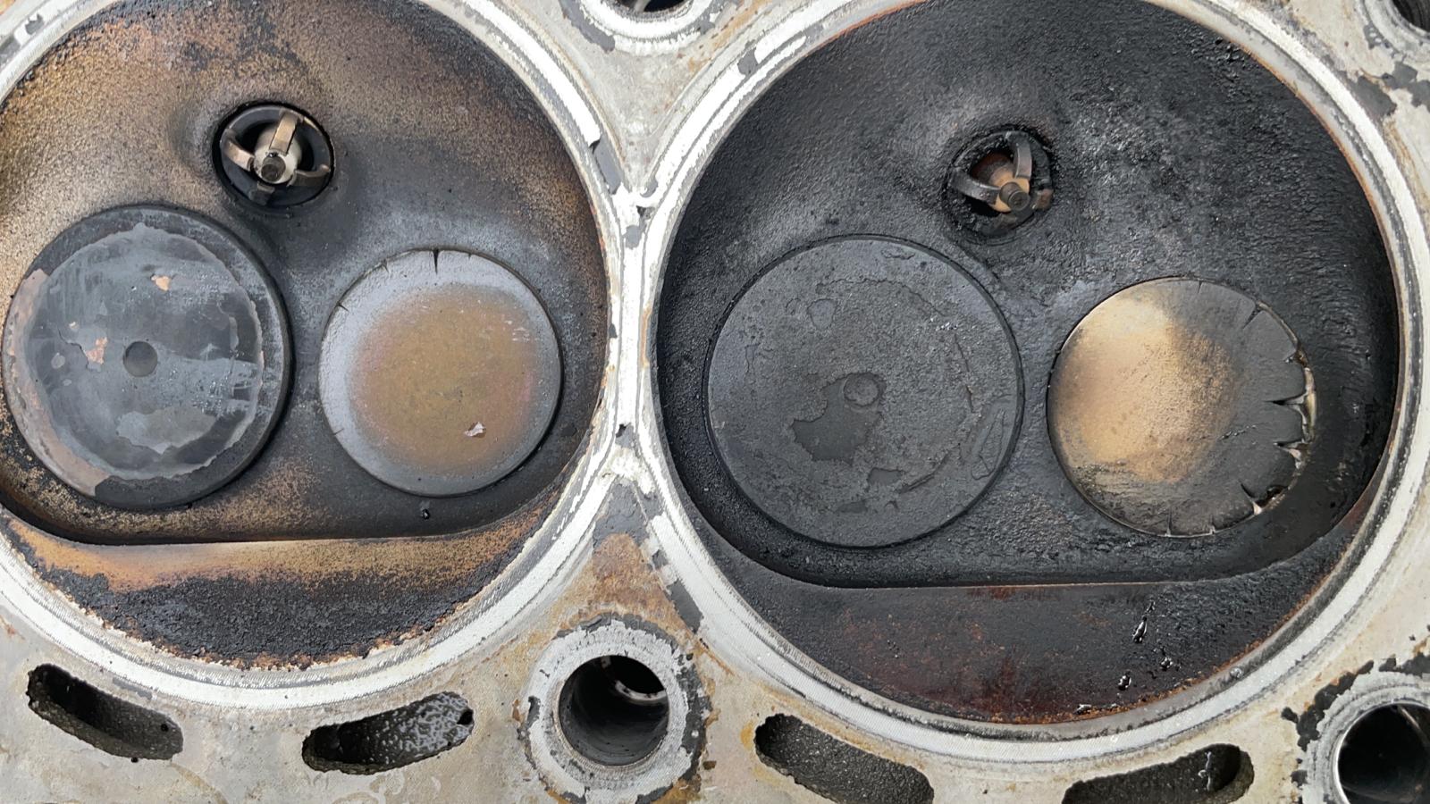

Took the head off today, not a pleasant job. Just take a look at those valves.

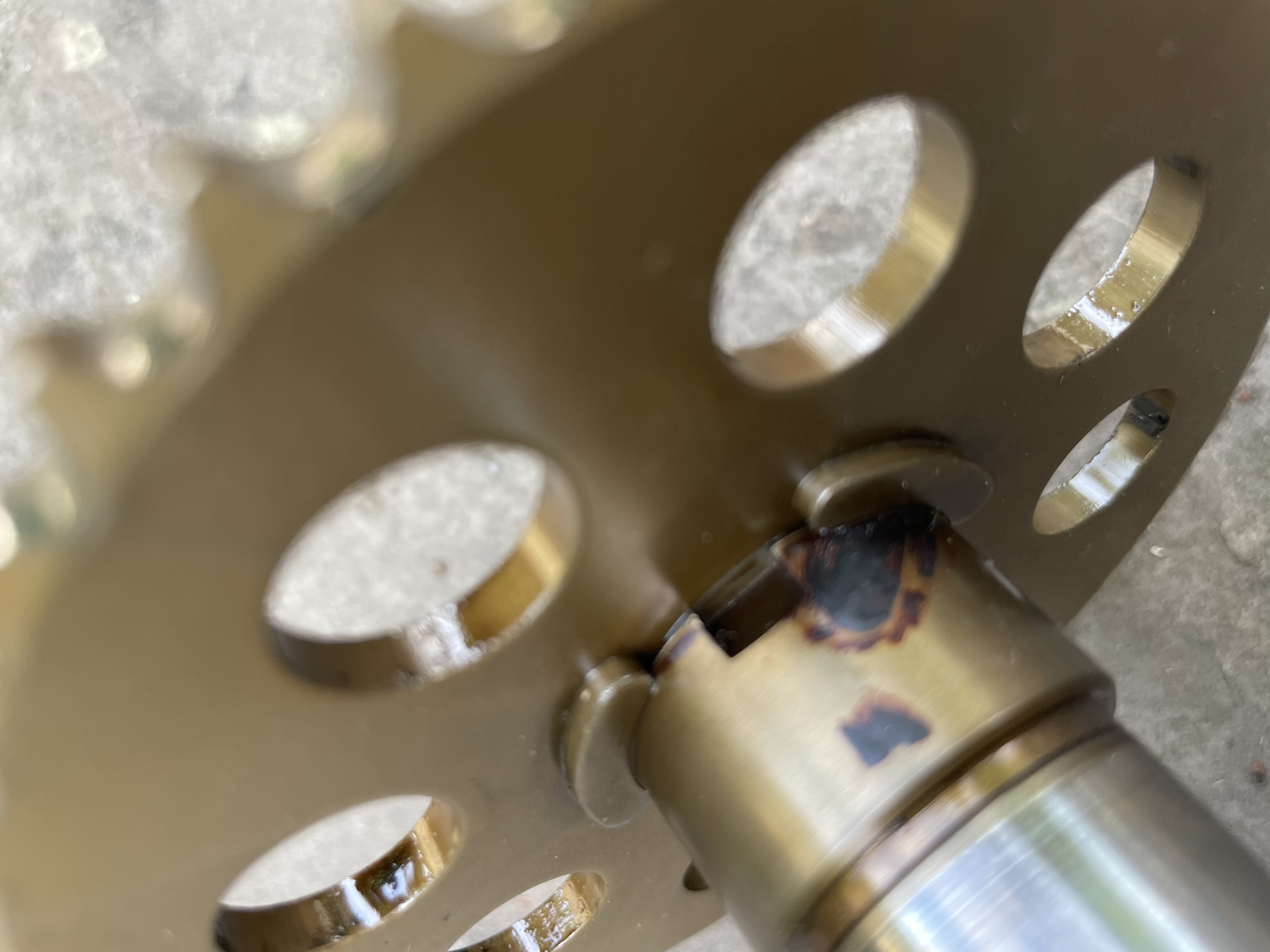

One more question if anyone has had experience of doing this before, the camshaft appears to have a notch where it mates with the cog but there appears nothing there to lock it in position, does it just rely on the pressure applied by the bolt? or has something sheared off mine?

You can see the notch in the crankshaft but no key to the sprocket. I mean why put a notch if it’s not used? Seems like it’s built to slip, could this be why these engines fail? Timing goes out because of cam slipping?
On other engines I have seen a locking pin.

It’s probably correct and something to do with the installation procedures to lock the crank and cam but be able to spin the chain to get even tension like some belt driven engine’s.
I expect the bolt is a use once and replace,torque and angle type fixing which is tight enough to hold this without turning but you will have to look this up in the tech specs.
Usually it’s chain stretch or a failed tensioner because of poor maintenance ie over due oil changes that cause problems
