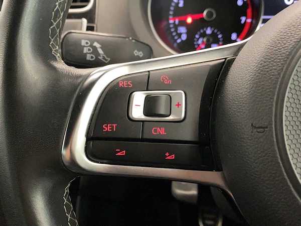

I recently bought a used 2017 Polo 1.0L (110bhp) R-Line 5 door. Been playing around with the various options and I was surprised to find that it seemingly has cruise control but no speed limiter function!
The cruise control definitely works fine using the controls on the steering wheel. But there's nothing in the options or any button I can find that would active the speed limiter. I couldn't find anything in the manual either (edition November 2016). It seems super weird to me, and a bummer as I would love to be able to use the speed limiter in trafficked, camera-ridden London.
Here's a picture of the wheel and stalk:
Can anyone confirm whether my suspicions are correct? And if so, is it possible to get the speed limiter retro-fitted somehow?
Re: Cruise control but no speed limiter?
Yes you are correct. I think you need a set of buttons with a mode button, but I'm unsure whether that's all that there is to it.

rbz5416, a speed limiter is different from cruise control in that it sets a maximum speed over which the throttle cuts off, it doesn't attempt to maintain that speed.
Thanks all for the suggestions, trying to see if my dealer will do anything as speed limiter was included in the specs when I bought the car.
