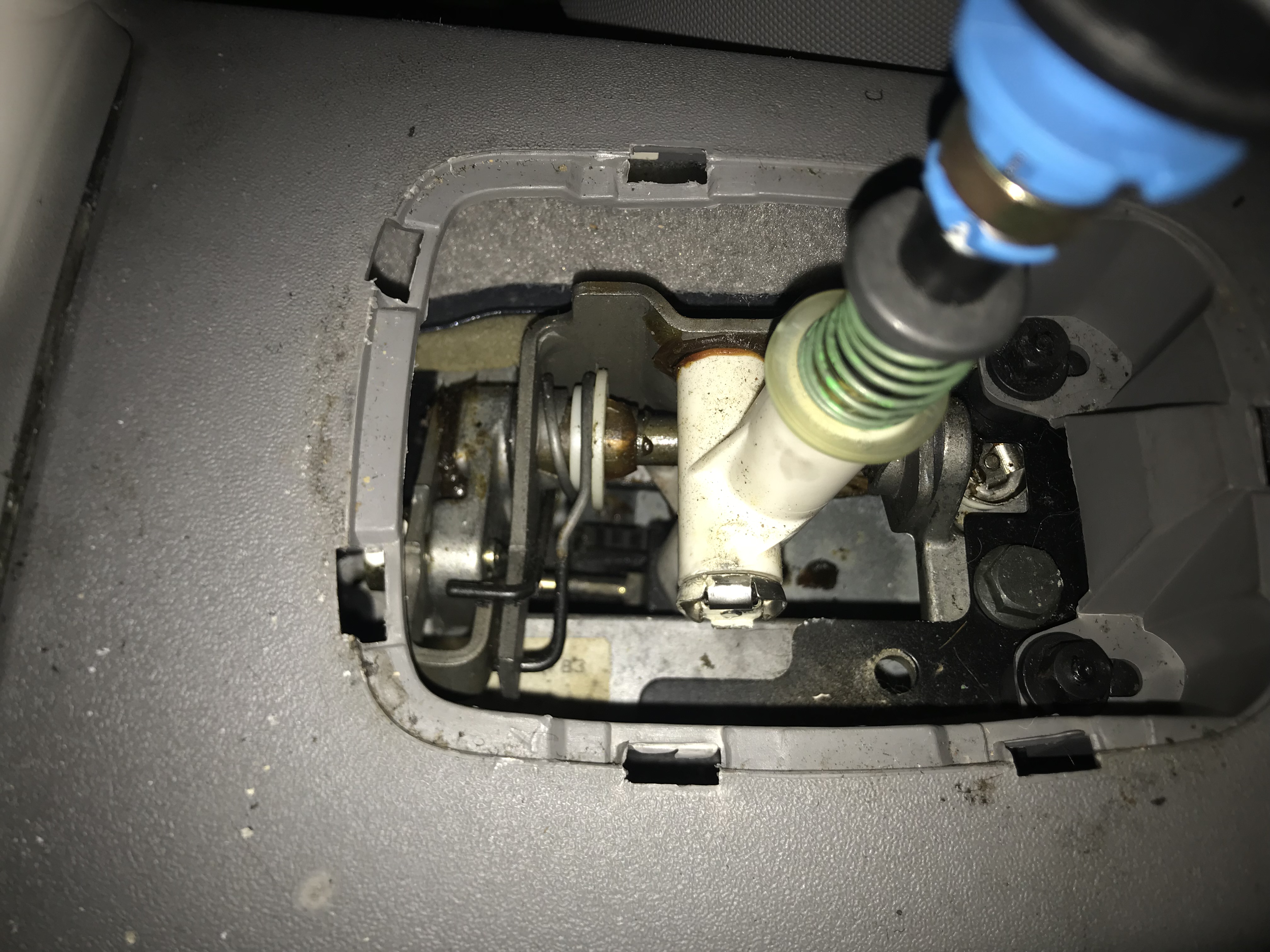

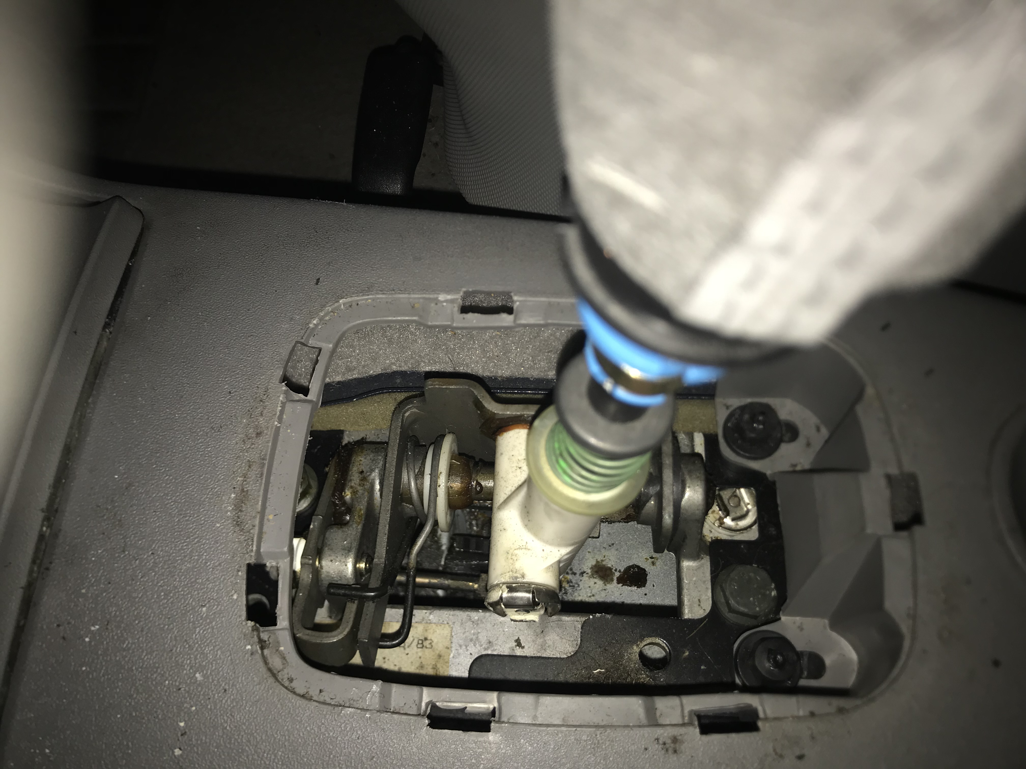

This is my first post. I need some help diagnosing the part and repair needed for my Polo. The gears are very stiff in general but mainly first and reverse gears. I gather that this is a common problem. I suspect it may require the plastic gear lever selection rod but not entirely certain. Any help would be much appreciated. I have included a picture to see if anyone can spot anything that my untrained eyes can’t. Thanks in advance.

Has this been like this for a while or just recently? It might be the gear selector which is giving you a headache, to be honest I don't see anything which might me causing the problem. The bushings look fine to me. But then again....I'm not an expert either.
