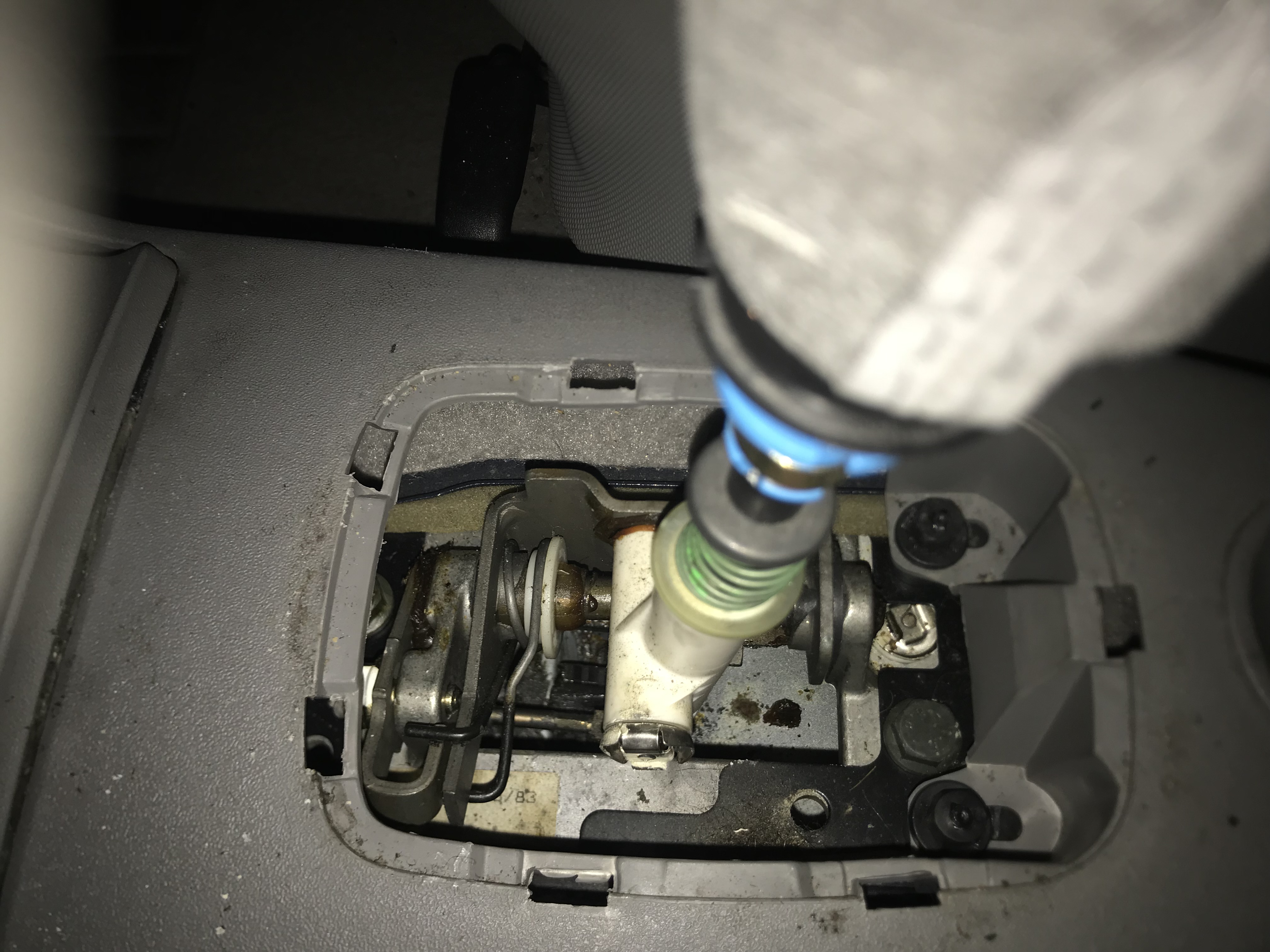

This is my first post. I need some help diagnosing the part and repair needed for my Polo. The gears are very stiff in general but mainly first and reverse gears. I gather that this is a common problem. I suspect it may require the plastic gear lever selection rod but not entirely certain. Any help would be much appreciated. I have included a picture to see if anyone can spot anything that my untrained eyes can’t. Thanks in advance.

Has this been like this for a while or just recently? It might be the gear selector which is giving you a headache, to be honest I don't see anything which might me causing the problem. The bushings look fine to me. But then again....I'm not an expert either.
I do know that the gear selection can be adjusted on the gearbox as well. The gearbox is operated with levers and cables, I suppose if one of this is out of alignment the gears won't change smoothly. See picture below of the gear mechanism which is located under the car between the firewall and gearbox. The 13mm bolt on the right adjusts the lateral travel of the stick. If you have someone to help you you can try adjusting it until 1st and reverse change smoother.

It’s been stood a little while but no problems prior. I’m taking it to my mechanic mate tomorrow & I’ll show this to him. I reckon it just needs an adjustment.
