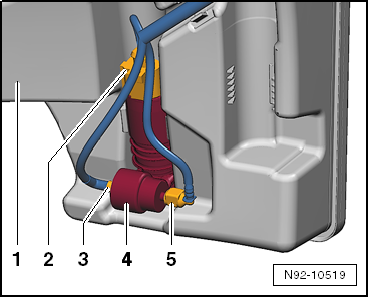

I have a leak coming from the washer bottle pump at the connector. The square clip has broke so it is not securing meaning water is leaking. However, I cannot find out where to get a replacement part that isn’t stupid money. I have attached an image of what I am looking for.
Looking for the clip shown ID’d 3/5 in the image.

Hi, a temporary (or perhaps permanent) solution is to remove the elbow containing the square clip and directly connect the pipe to the pump.
Re: 2009 washer hose clip - leak
Just tried this, unfortunately no luck. The hose was too tight and there was a lack of water/pressure.ciclo wrote: Wed Sep 01, 2021 7:46 pm Hi, a temporary (or perhaps permanent) solution is to remove the elbow containing the square clip and directly connect the pipe to the pump.![]()

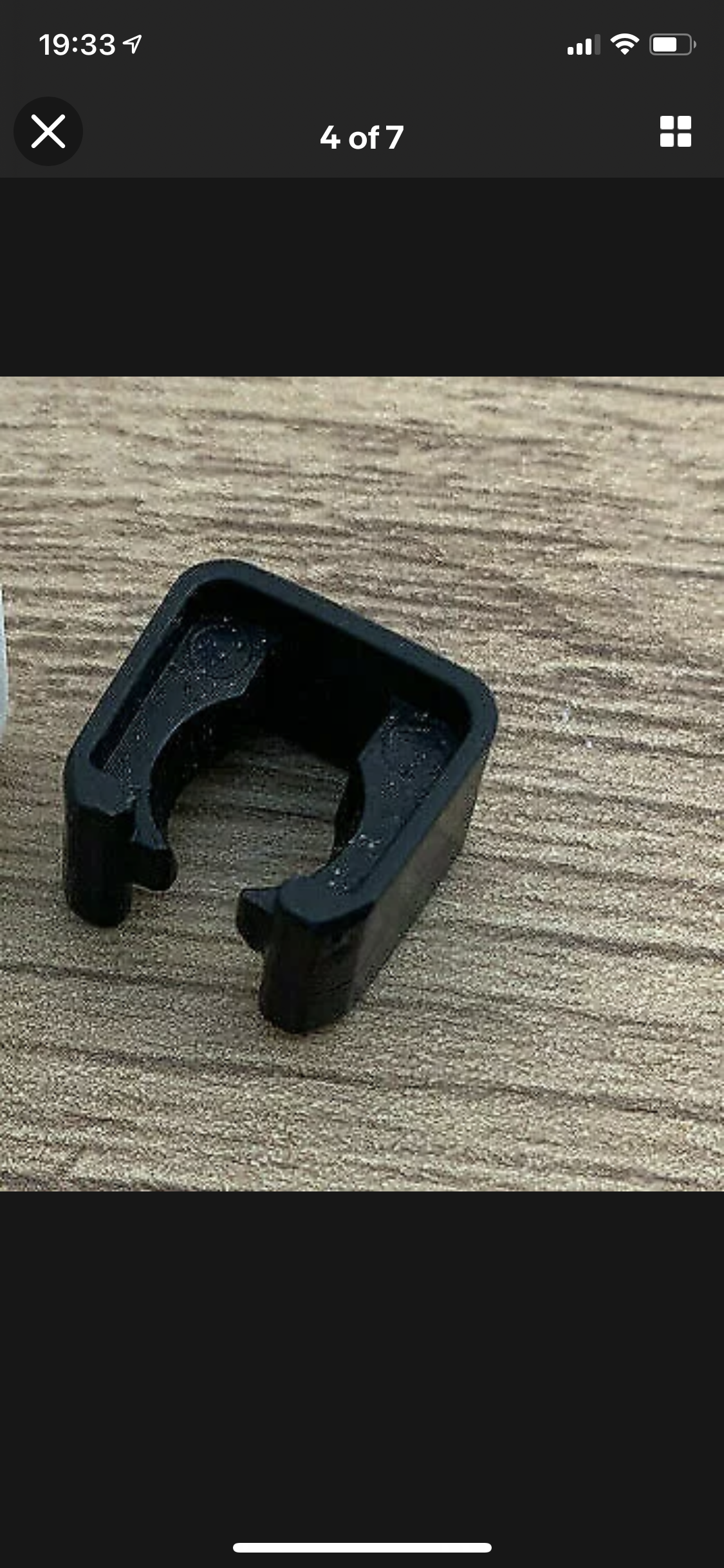

Yeah I got the elbows out and the hose in but the hose is bending too much and causing a blockage.
I think I just need the black clip to replace it and it will be all good, just the one on eBay is £9 which I think is a scam for a tiny black clip.

I agree it is a high price to be a part of such poor quality and so small. Supposedly it should be a quick connection that will seal perfectly.
I also had the same problems with the black elbow in an installation that I did but maybe I was lucky and finally everything was well sealed with the methods that I mentioned previously.
You may find it cheaper in the parts section of a VW dealer or the nearest official VW store instead of buying it on eBay. Maybe £5 ...
