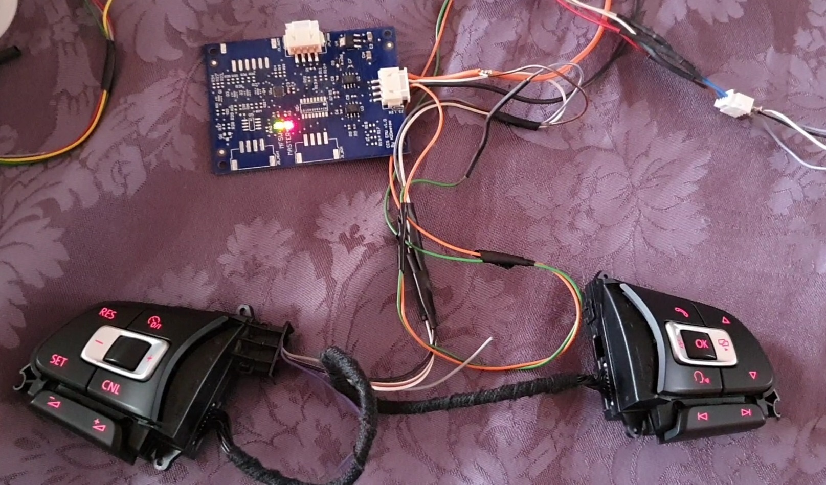

I tested many different button parts and firmware versions and they all work. I haven't encountered one that I couldn't make working.

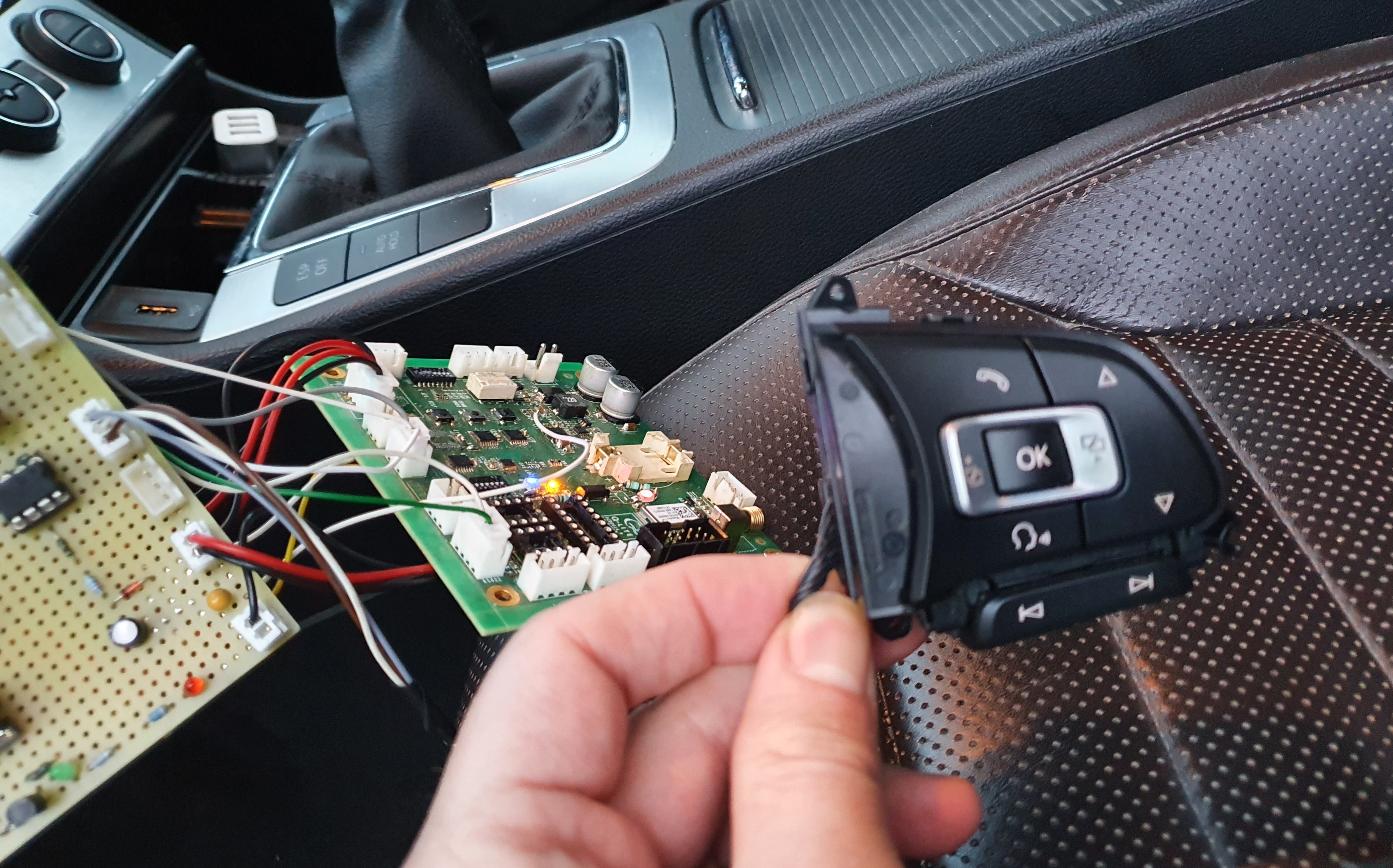

The only thing is that some buttons like VIEW, MODE or ASSIST sometimes don't have a real function in a particular car, but such buttons can be given an alternative function if desired. The sky is the limit ;-)
Here was a test with some Passat B8 facelift buttons:

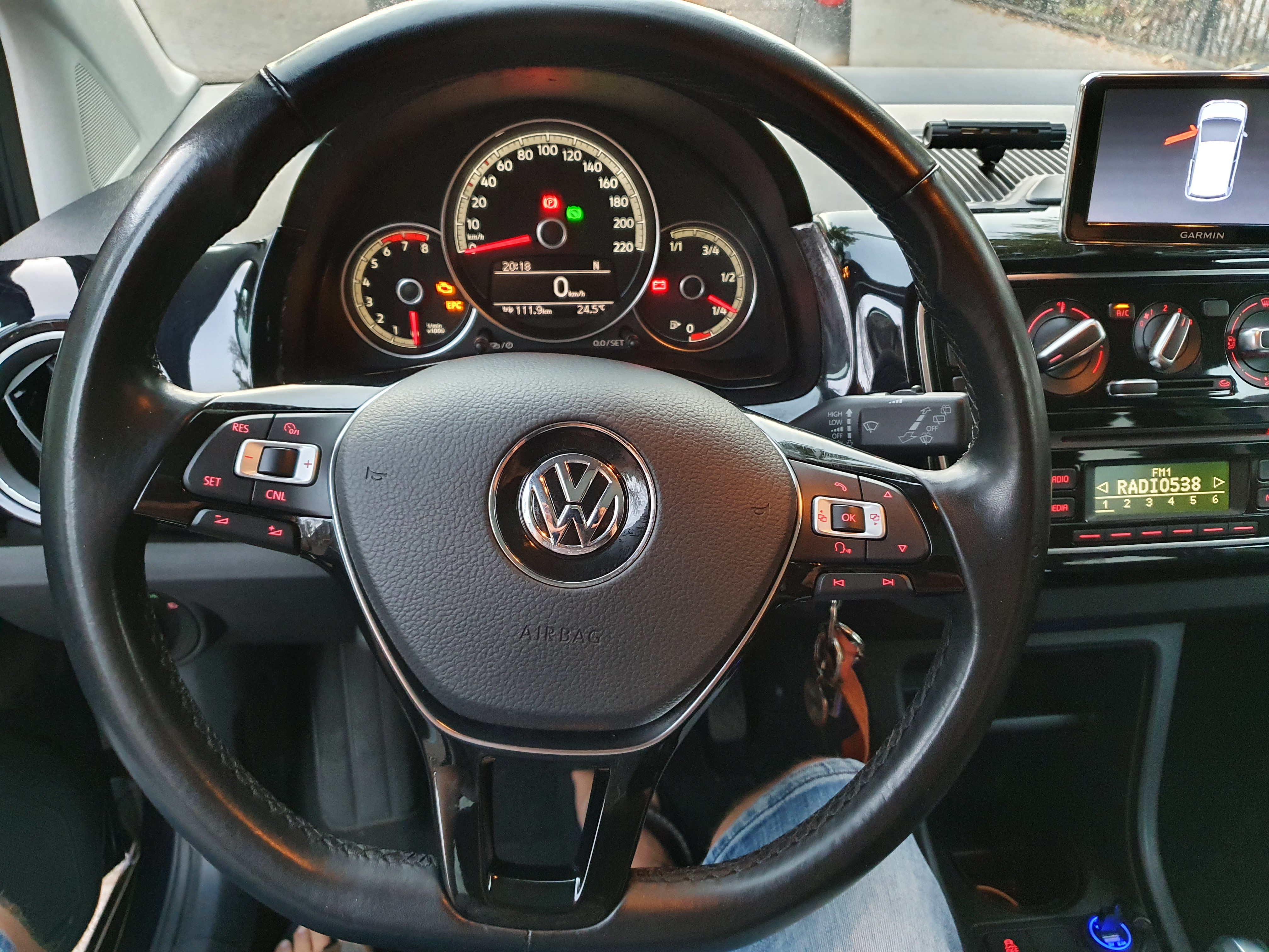

and today I finished the installation in our VW UP:

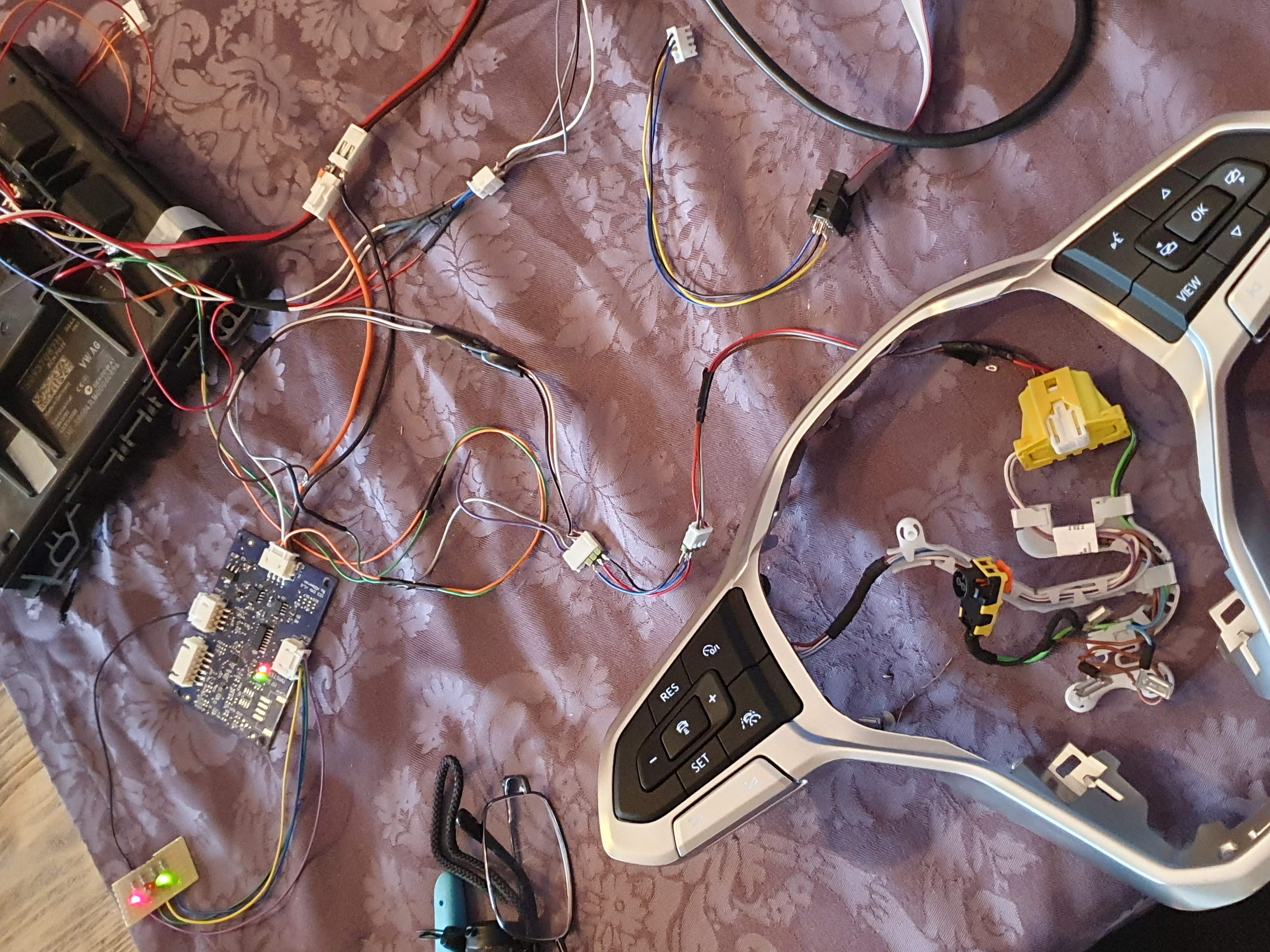

Here is a picture of the first prototype:

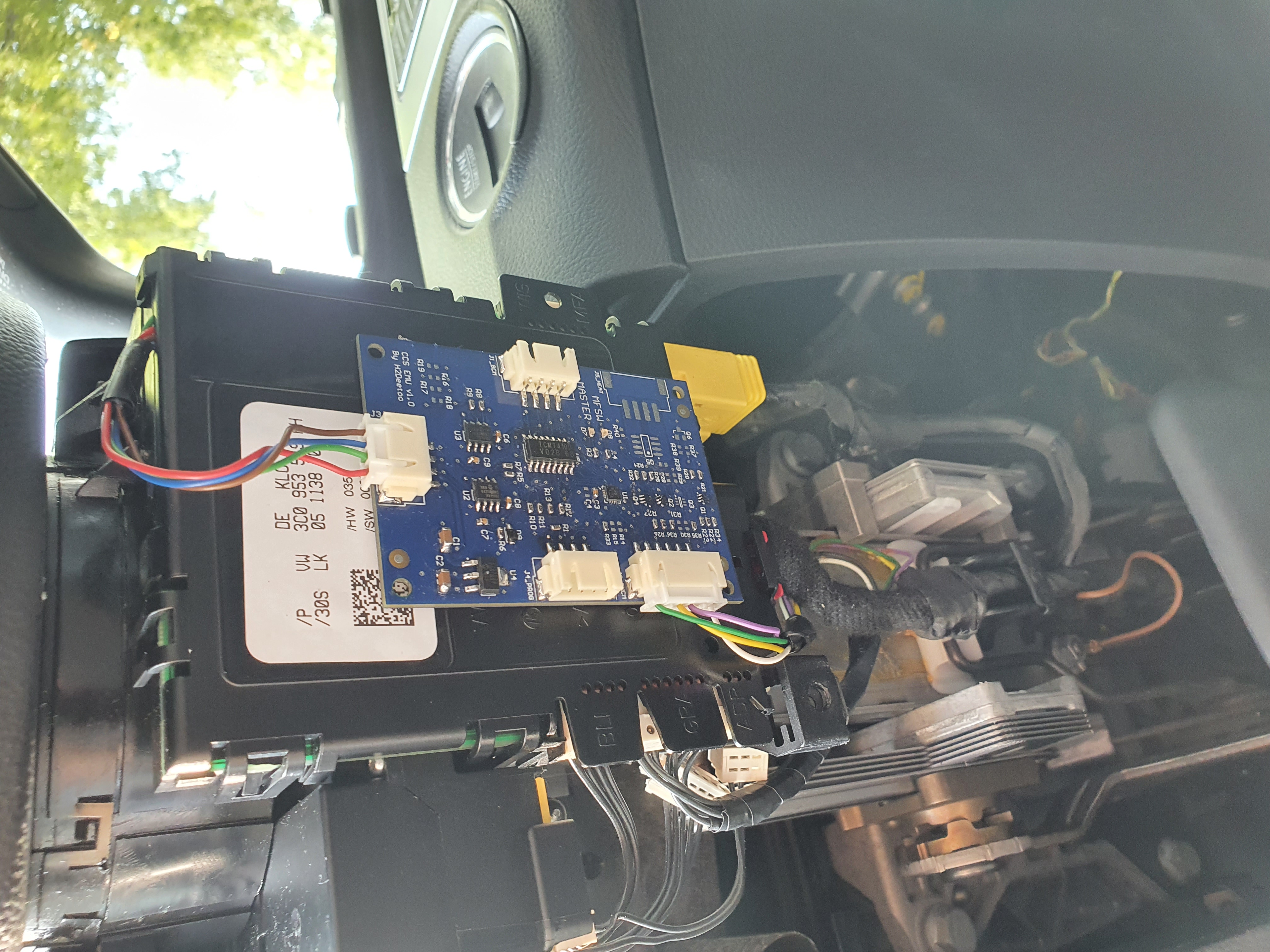

After I had both the BCM and B6 SWCM interface figured out and working I develop a nice small circuit board:
On the Passat B6 it can be easily mounted below the SWCM itself:

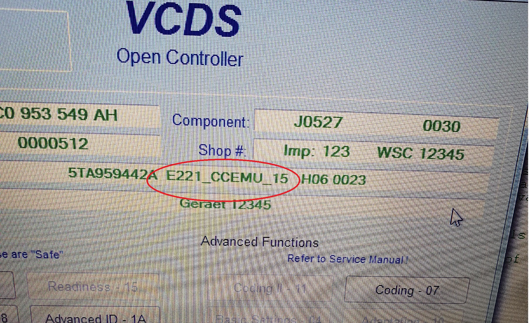

Following ciclo's example from his post installing a CC EMU from MadWarLock, I decided to also add some 10pin connectors to our VW UP so the CC EMU can be easily removed and the car can be restored to its original function:
It's working well and without errors in either SWCM or BCM:
Address 16: Steering wheel        Labels: 3C0-953-549-SW25.lbl
   Part No SW: 3C0 953 549 AH    HW: 3C0 953 549 AH
   Component: J0527               0030
   Revision: 00035000    Serial number: 3C0953507
   Coding: 0000712
   Shop #: WSC 12345 123 12345
   VCID: 72EB6CC86DAF29DADB-8026
   Subsystem 1 - Part No: 5G0 959 442 AB
   Component: E221_CCEMU_24   H17 0052
   Coding: 01048360
   Shop #: WSC 00000
Address 09: Cent. Elect. (J519)       Labels:. User\1S0-937-090-F.lbl
   Part No SW: 1S0 937 090 F    HW: 1S0 937 090
   Component: BCM PQ25 1MX4 H81 0744
   Revision: BW081001    Serial number: 0978 215160666
   Coding: 7AB82B0000010000090806D46CEBBCC870C060F0608A2441200000420100
   Shop #: WSC 31414 790 00001
   VCID: 366390D8814775FA37-8062
   Subsystem 1 - Part No: 1K0 955 559 AF  Labels: 1K0-955-559-AF.CLB
   Component: RLS 090608 04  46  0204
   Coding: 033025
   Subsystem 2 - Part No SW: 6R0 959 591 B    HW: 6R0 959 591 B
   Component: J245 PS72.023  H02 0007
   Serial number:     WOO26347321
   Coding: 181100
   Subsystem 3 - Part No SW: 6C0 959 442 G    HW: 6C0 959 442 G
   Component: E221_CCEMU_27  H06 0023
   Serial number: 1061601332900184BF2B
   Coding: 28FF05
The original buttons partnr and software version are maintained however the description will always show E221_CCEMU_xx where xx is the firmware version of my CC EMU.
The last (3rd) coding byte is rarely (or never?) used by any buttons I've seen so it can be used now to code my CC EMU if ever needed.
For example some user specific features could be enabled like using DSG paddles to controle volume+- as a friend recently asked me :-D
Another screenshot of VCDS showing the CC EMU in 16-Steering Module for example:

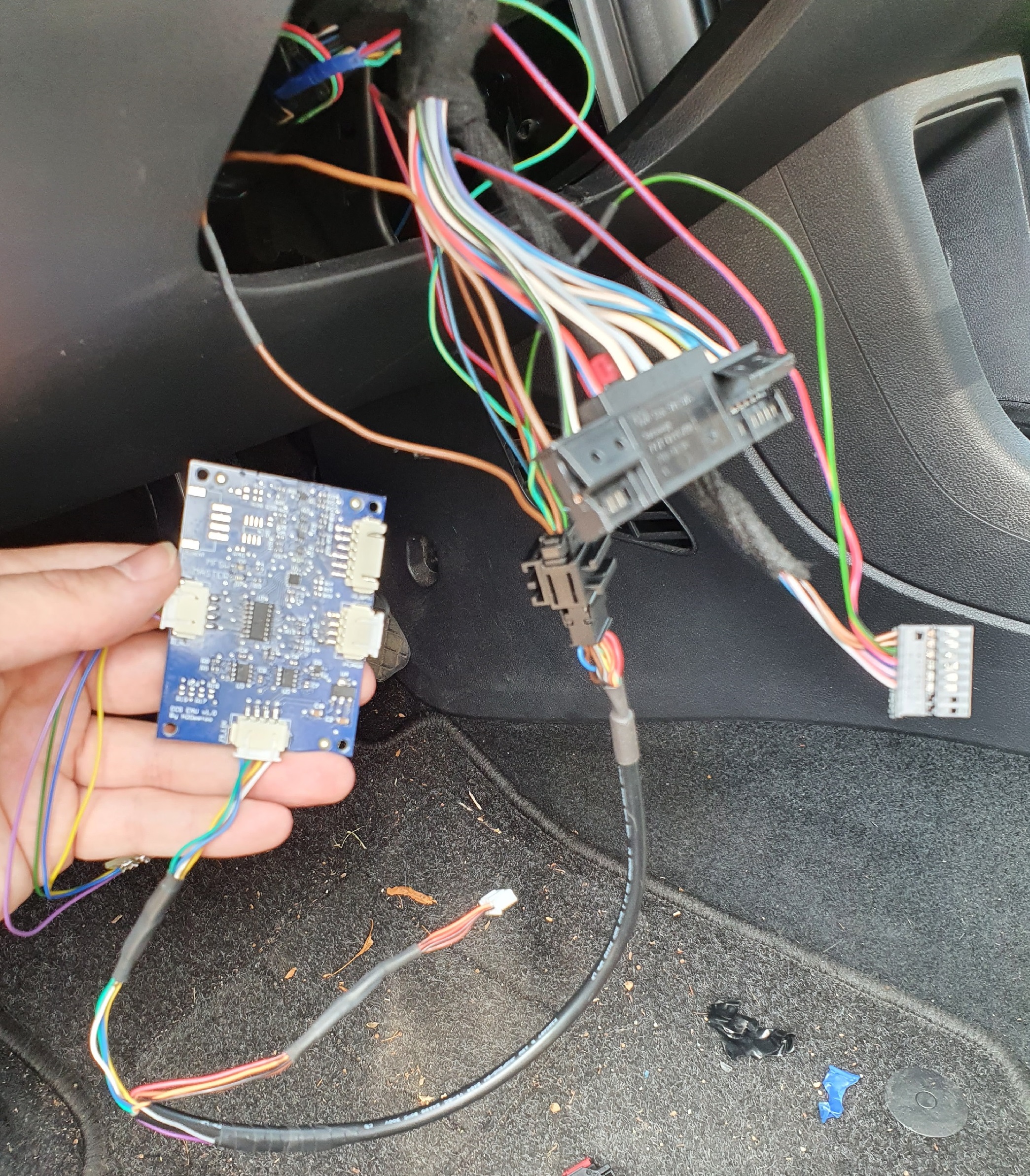

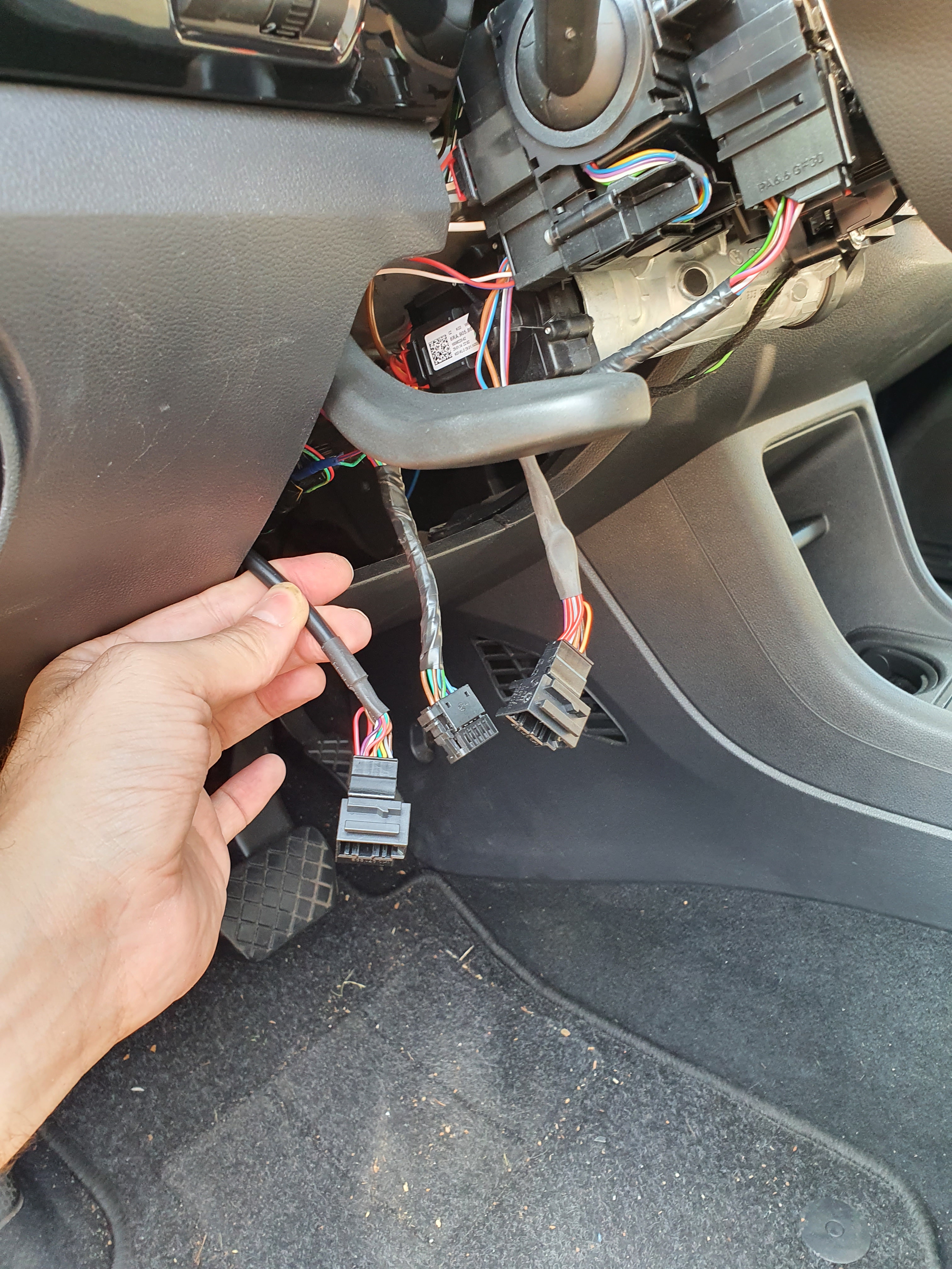

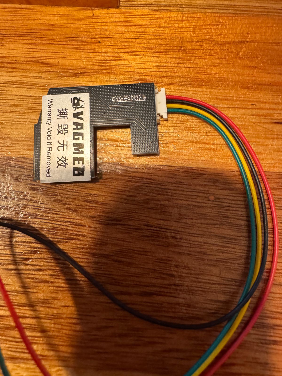

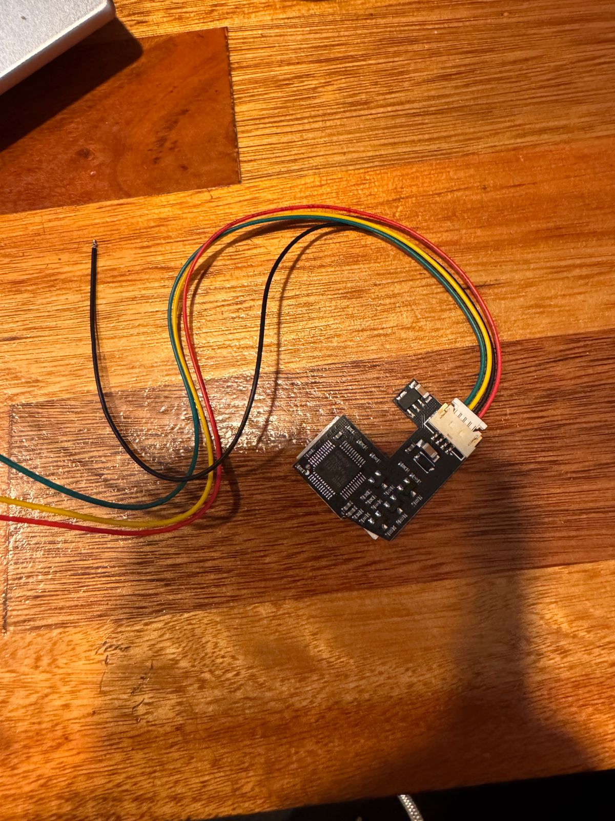

Hi, how are you? I have a VW Up with CCS on the stalks, and I’ve got a compatible MFSW. I’d like to control it from the steering wheel — where can I find the emulator, or has anyone seen how to make it? Honestly, I’ve seen some videos of people soldering things, and that doesn’t look like a good option for me.
dojerez
Posts: 3
Joined: Tue Jan 21, 2025 8:03 pm
Drives: R6
Location: buenos aires
Re: CC EMU finally finished (cruise control using MFSW)
Post by dojerez »

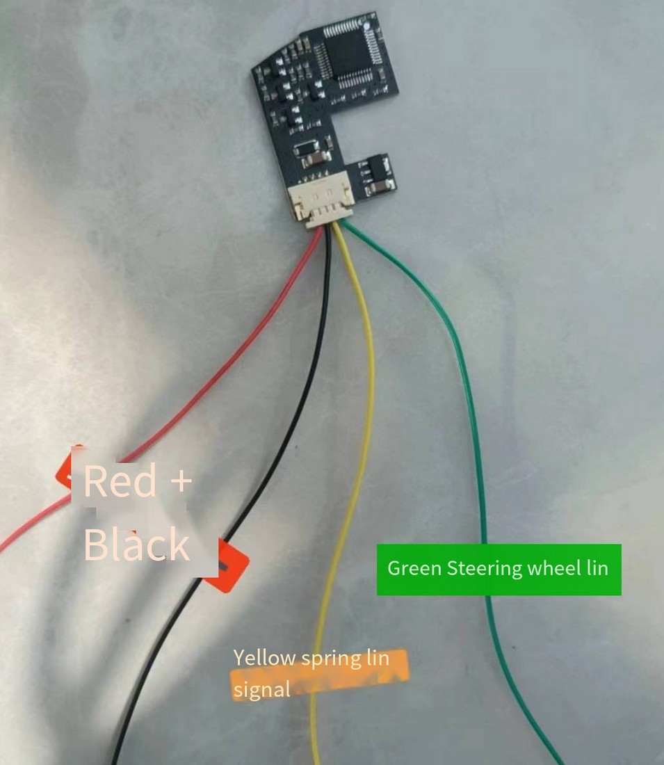

I only managed to get this, but I don’t know how to install it…
In theory, they say it’s meant for this.
Can anyone help me out?
WhatsApp Image 2025-08-19 at 14.31.02.jpeg (381.26 KiB) Viewed 4569 times
WhatsApp Image 2025-08-19 at 14.31.02 (1).jpeg (347.58 KiB) Viewed 4569 times
dojerez wrote: Fri Oct 17, 2025 8:22 pm I only managed to get this, but I don’t know how to install it…
Red 12V
Black GND
Yellow G85 clock spring lin-bus
Green steering wheel lin-bus
