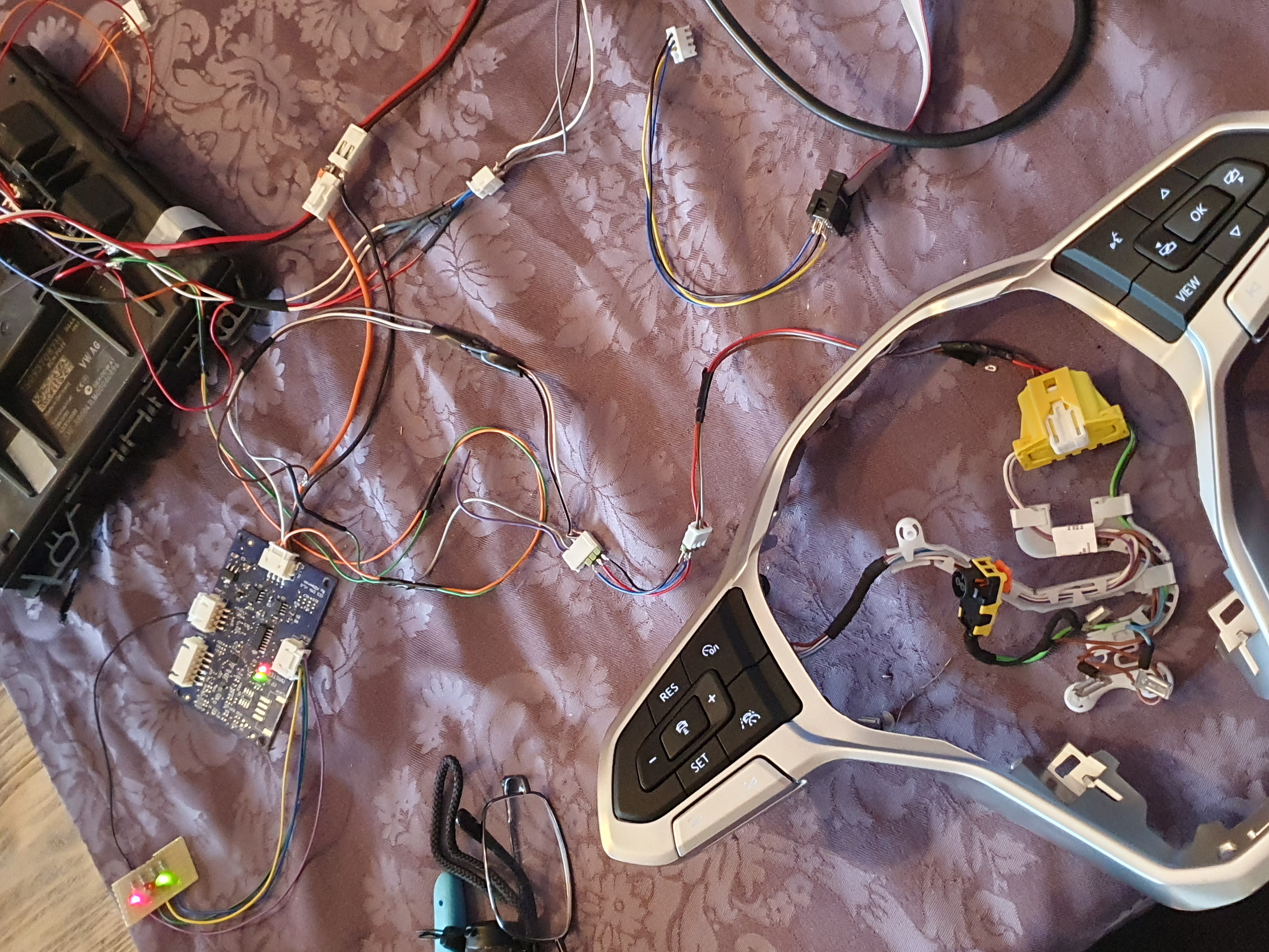

Hi guys,
When browsing this forum some time ago I learnt some people made an interface to have cruise control working using the buttons on the steering wheel, specifically for cars who dont have a newer ECU and BCM (or SWCM) which can support this natively.
These CC enulators (as they are called) read out the cruise control buttons on the steering wheel and emulate the switches as found on the cruise control stalk, so the BCM (or SWCM) simply thinks the original stalk is being used so cruise control will be working as it should.
I found 3 different such CC EMUs which all have their own pros and cons.
I decided to develop my own CC EMU using the best features of them all, and more importantly it needed to work in both my Passat B6 (which uses the SWCM to control the MFSW) and our VW UP (which uses a BCM to control the MFSW).
The main reason is that I simply like figuring such things out and try and make some sort of solution for a certain problem :)
I tested many different button parts and firmware versions and they all work. I haven't encountered one that I couldn't make working.
The only thing is that some buttons like VIEW, MODE or ASSIST sometimes don't have a real function in a particular car, but such buttons can be given an alternative function if desired. The sky is the limit ;-)

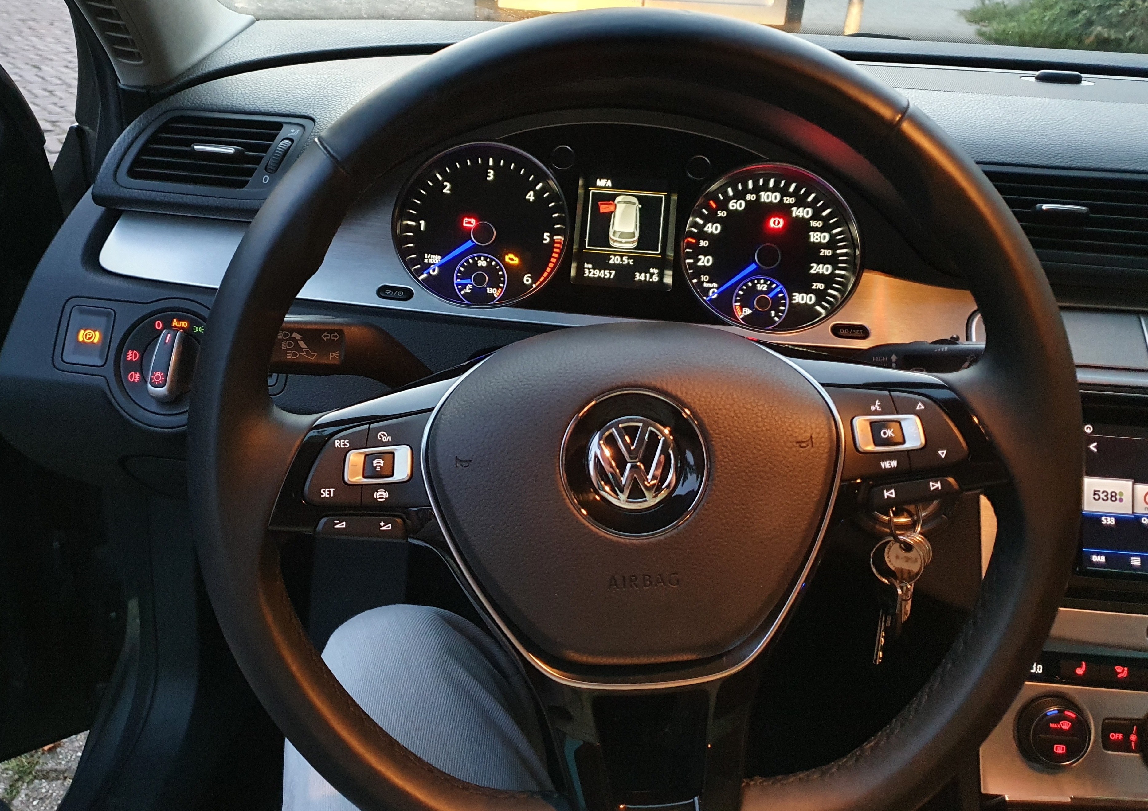

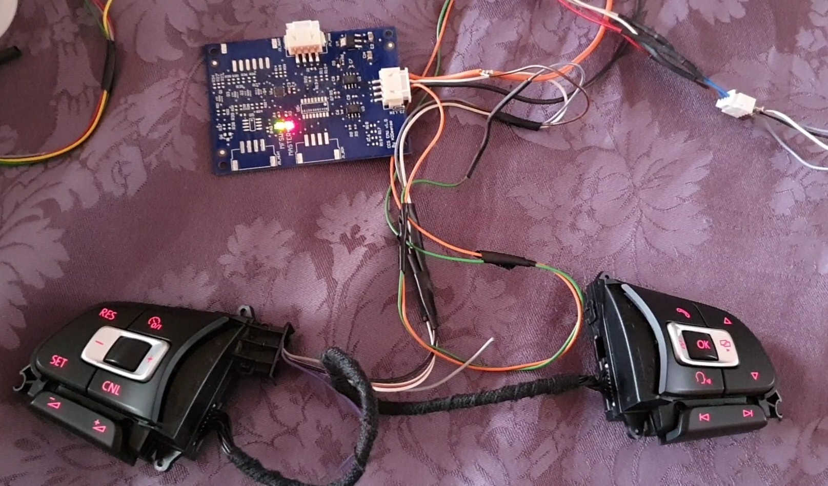

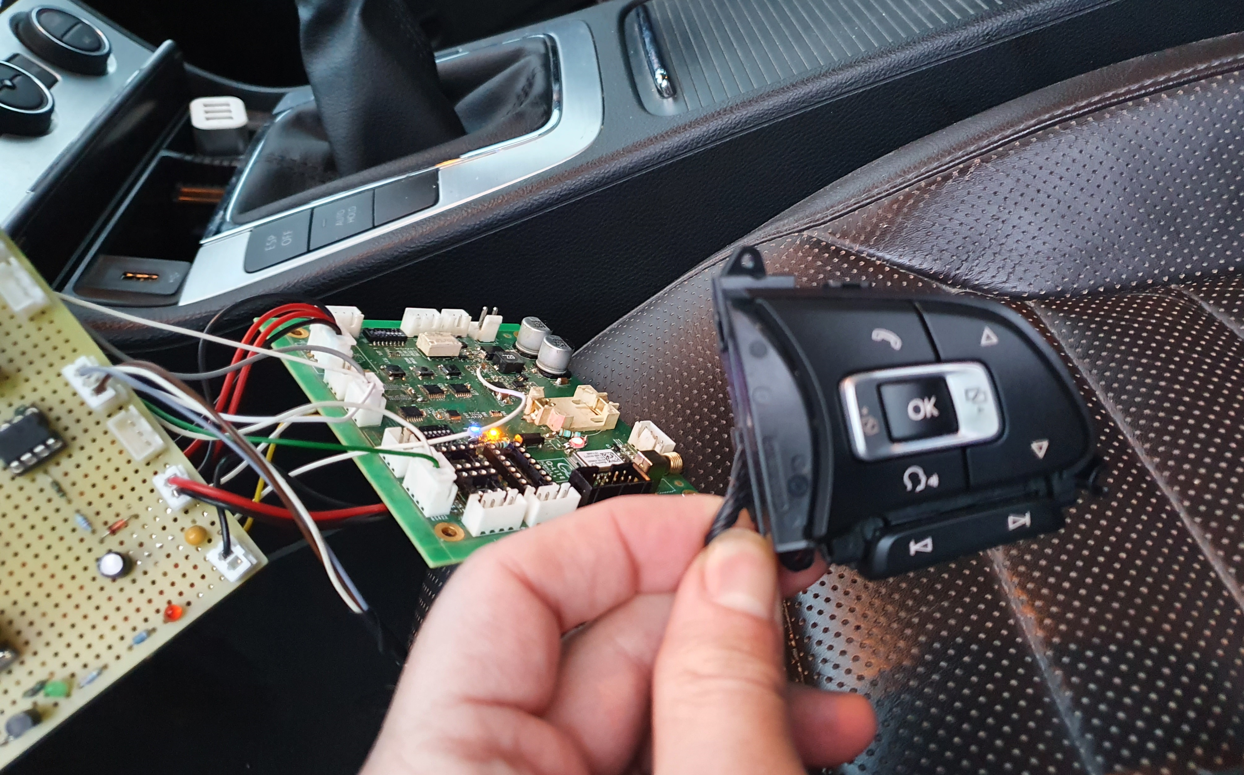

Here was a test with some Passat B8 facelift buttons:

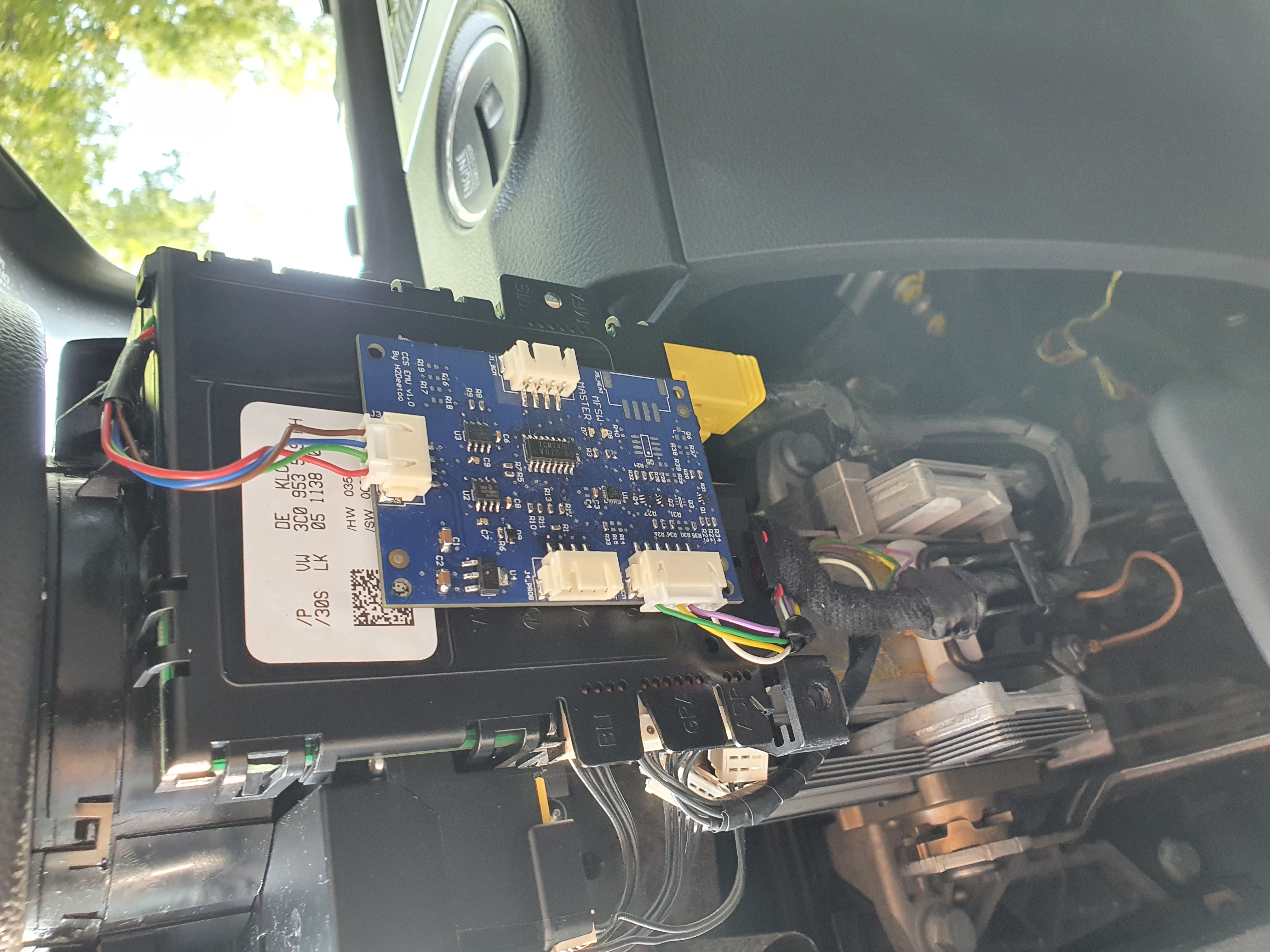

Last week I already installed my CC EMU in my Passat B6:

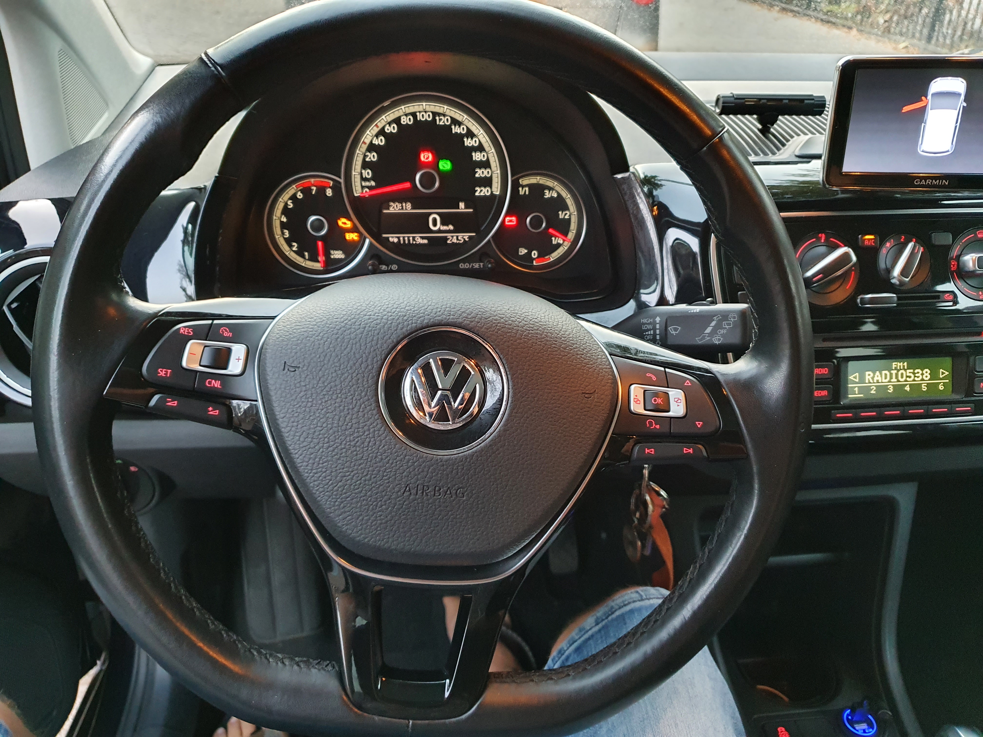

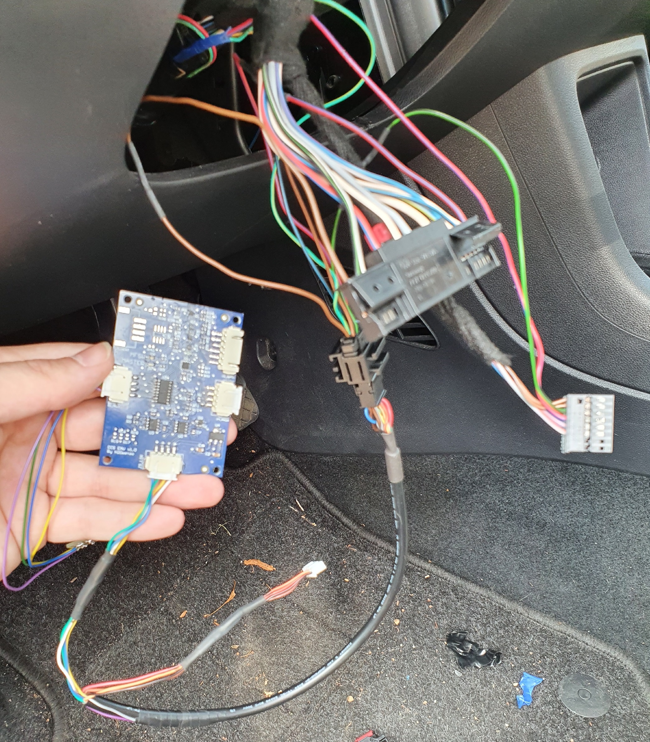

and today I finished the installation in our VW UP:
Here is a picture of the first prototype:
After I had both the BCM and B6 SWCM interface figured out and working I develop a nice small circuit board:
On the Passat B6 it can be easily mounted below the SWCM itself:

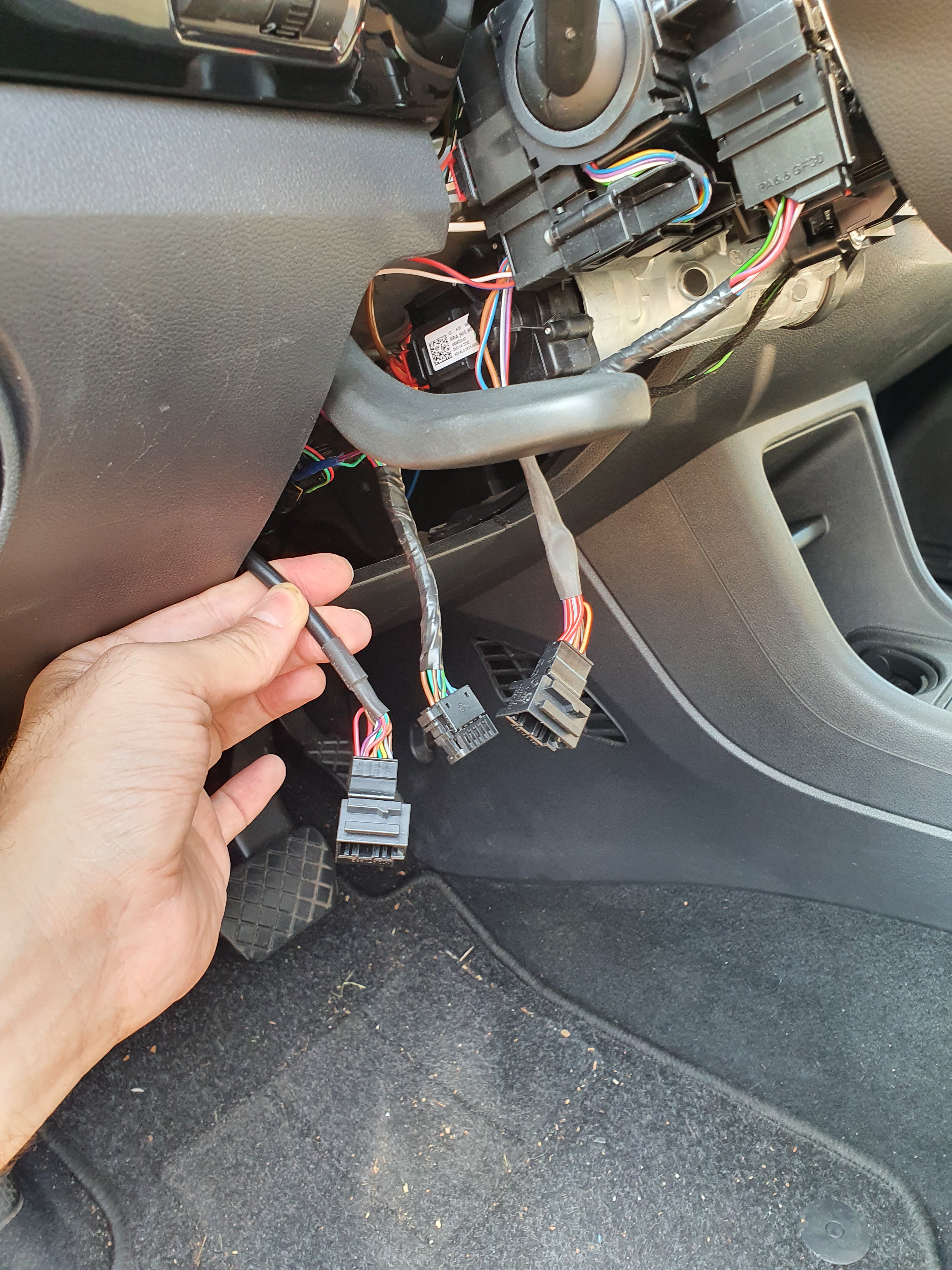

Following ciclo's example from his post installing a CC EMU from MadWarLock, I decided to also add some 10pin connectors to our VW UP so the CC EMU can be easily removed and the car can be restored to its original function:
It's working well and without errors in either SWCM or BCM:

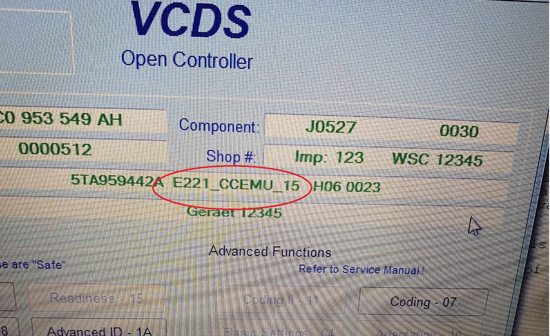

The original buttons partnr and software version are maintained however the description will always show E221_CCEMU_xx where xx is the firmware version of my CC EMU.
The last (3rd) coding byte is rarely (or never?) used by any buttons I've seen so it can be used now to code my CC EMU if ever needed.
For example some user specific features could be enabled like using DSG paddles to controle volume+- as a friend recently asked me :-D
Another screenshot of VCDS showing the CC EMU in 16-Steering Module for example:

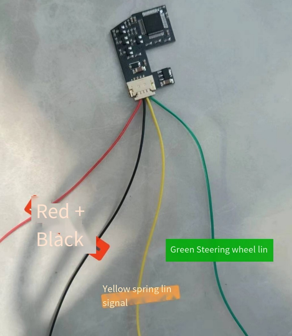

Hi, how are you? I have a VW Up with CCS on the stalks, and I’ve got a compatible MFSW. I’d like to control it from the steering wheel — where can I find the emulator, or has anyone seen how to make it? Honestly, I’ve seen some videos of people soldering things, and that doesn’t look like a good option for me.
Re: CC EMU finally finished (cruise control using MFSW)
Posted: Fri Oct 17, 2025 8:22 pm
by dojerez
I only managed to get this, but I don’t know how to install it…
In theory, they say it’s meant for this.
Can anyone help me out?
Posted: Sat Oct 18, 2025 8:20 am
by amer6R
dojerez wrote: Fri Oct 17, 2025 8:22 pm I only managed to get this, but I don’t know how to install it…
Red 12V
Black GND
Yellow G85 clock spring lin-bus
Green steering wheel lin-bus
