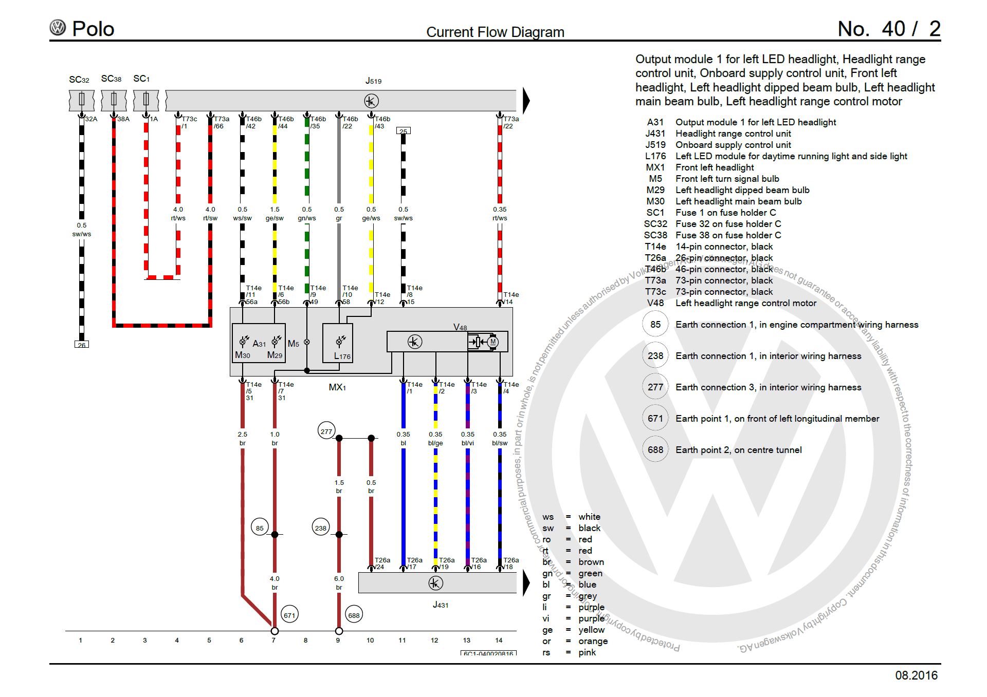

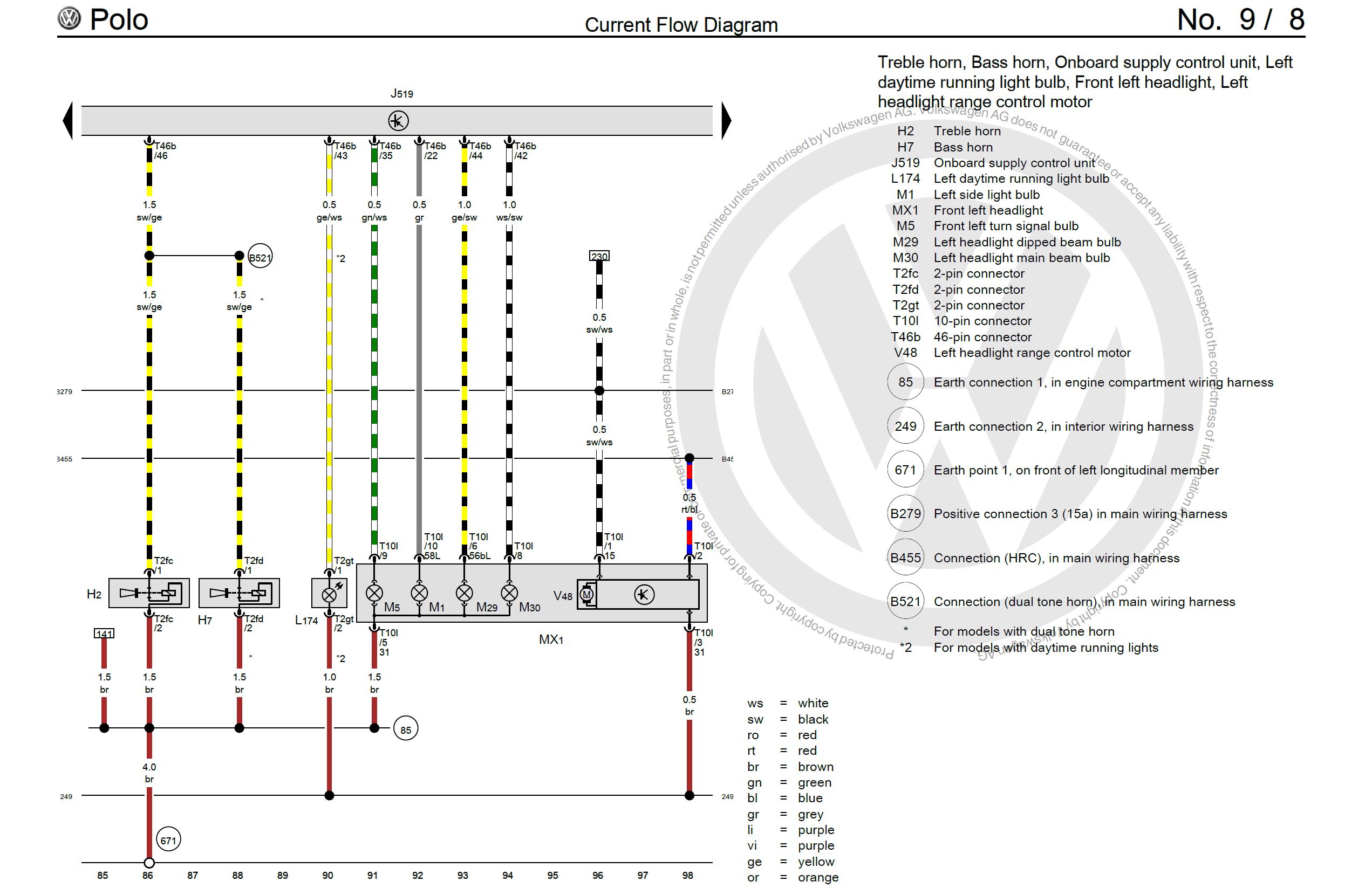

Jet wrote: Sat Sep 04, 2021 6:42 pm Thanks for the quick response. Are you able to get me or configure a diagram so I can get the drls in headlights working along with foglights and cornering lamps.
here is the wiring diagram comparing the halogen wiring to the LED wiring.
As fare as I can see, you just need to wire the L174 DRL that is in the fog light to the L176 (pin 12) in the LED headlight.
Pin 8 black and white wire is the vehicle voltage for the range control motor but I have no idea what the red/white wire in pin 14 does.
Even in the Onboard supply control unit 173a harness connector this wire has no function.
